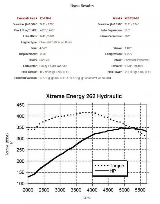

AJ/Forms - Pick me a cam me please, as I can't choose one, I have told you everything I am going to do with my engine, you know a lot more about them than me!
COMP Cams: Xtreme Energy™
I am leaning towards the XE262H soon as you pick one I will buy it and have it shipped over, the cam will end up costing me in excess of $300 but if this is the only way to fix my running gear and make the car go good its a small price to pay!
I am not being smart or anything, I honestly don't know what to do!
Thanks

But I know you probably paid a lotta money to get that cam into your possession. Do yo wanna go down this new road?
>>I can tell you for sure that the 223@050 cam I had was dynomite, as to torque from idle to just about what that dyno curve looks like.
Notice the peak is about 415ftlbs@ 3700, but from 2500 to 5000 it is hovering right around over 90% of that.
Then,notice,as you can see the power is nothing to brag about at 350. But,check out how very wide the top of that curve is. From 4000 to over 6000,it is making over 90% of that 350hp.
1) POWERBAND;
That is exactly what the A998 torqueflite needs, as the splits are 56% and 65%.Meaning, that engine will want to wind out to around 6600, to drop in at 3710(56% of 6600). Notice on the graph, that you will have to extrapolate the hp-line out to 6600. There it might be making 300HP and that is what it drops into at 3710.So you can see why I questioned the 268* cam,right?;you woulda had to rev it to at least 300rpm more to achieve I nice transition, with maximum average hp for that gear.That would then be over 6800rpm.
2) STALL;
Now, pay attention to the torque line below 3000rpm.Notice how it falls 25 ftlbs from 3000 to 2500. That is not bad. But look what happens below 2500, it drops another 25ftlbs by 2250; just half as many revs. Now think about the stock TC which might have been rated as high as 2250 with the 2bbl, hi-torque cam.Suppose that very same TC only stalled at 2000 with your previous doughy-combo. Notice the torque would have fallen perhaps under 300 ft lbs. This is another 50 ft lbs! Now are you seeing why the previous combo was doughy?
Lets put it into numbers; previous torque at 2000stall about 300.New torque with 2500TC about 375! whooee! That maths out to an increase of 25%. Now a 3000TC would peg the torque at 400, which is a 33% increase over the previous sucked out combo! So by now you can see how this stuff works. So;you already own the 2500, and that will be good, cuz it works pretty good to have the stall lower than the cruise rpm, which for you will be around 2473@ 62 with 27s. Perfect!
Ok, so we know the combo can hit at least two bases, namely;off-the-line tire fryer, and comfortable cruising at under 2500.

Lets talk about hammer down at 32 mph. This will be about 3330 rpm. Check out the dyno curve at 3330;What do we see, but over 400 ftlbs! And climbing! This means,Properly tuned,your A-body will be as mean as can be! Whooee, we just hit another target!

below is the compcams dyno sheet on their mule.
to be continued
