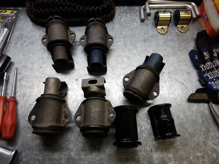

So, a few pics and info to share, and please, don't hate me because I've been at the parts scrounging game for about three decades now...
A few tbar-LCA bushings here, a mix of Mopar service parts, as well as pure aftermarket (Moog I think).

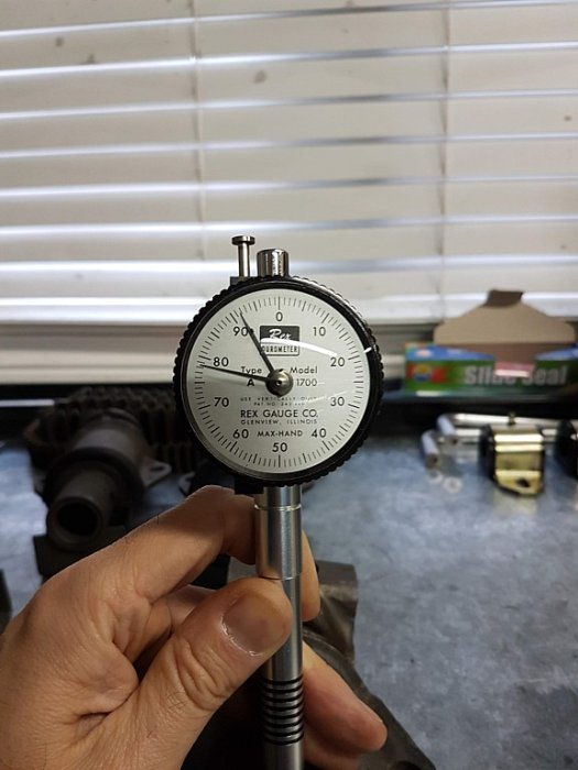

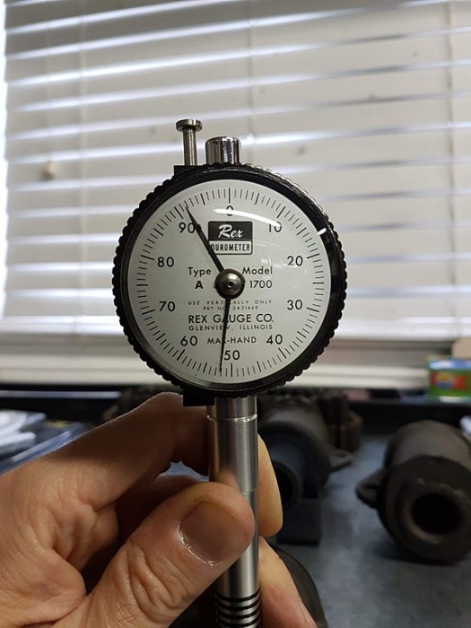

...and well, as we all know, the rubber and poly materials will have a different softness to them...but just how different you might ask?
Well, that's what a Durometer is for:
1) reading from the Mopar service parts set
2) reading from an Aftermarket set
As you can tell, there is a good difference between the Mopar "rubber" and the aftermarket stuff...which through human touch&feel you can tell is a lot more poly-like material.
NOTE: the 92 reading is a high-mark for the poly stuff, and that's a static indicator, so you are actually looking at the second pointer in all the pics below.

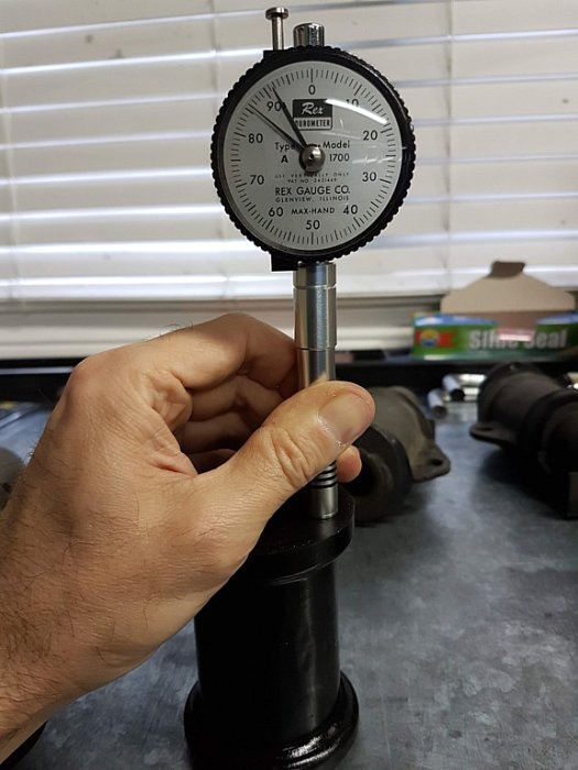

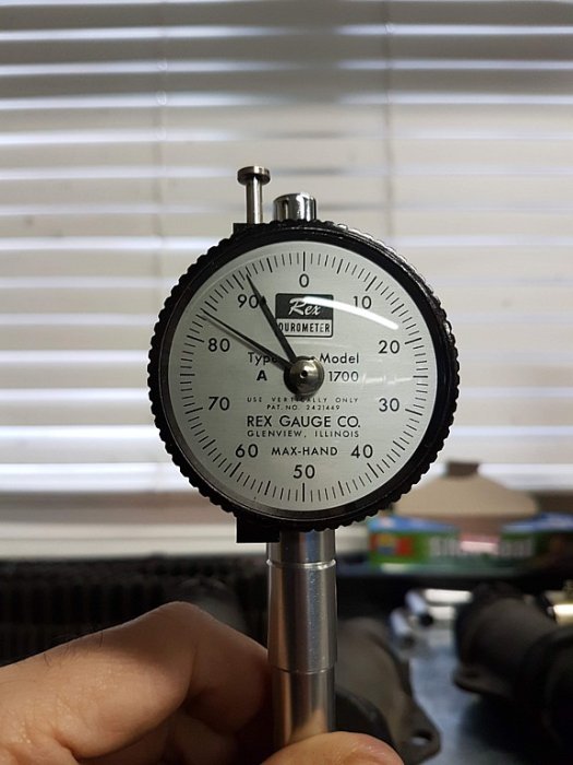

OK, so that final piece here are the FF poly bushings...what do these read like?
1) the high mark on the gauge shows the initial reading
2) the low mark (or where the indicator is actually pointing to) shows the low reading
The difference between these two actually show the "material flow", that being the amount of 'give' the material has.
I didn't expect the poly stuff to have as much flow to them as the indicator showed, this was more than the rubber in the Mopar service parts, and more than the quasi-poly material in the aftermarket bushings I measured.
Conclusion here being: POLY is certainly a much harder material, the readings shows this clearly and at least now I have a quantitative assessment of how these two compare.
