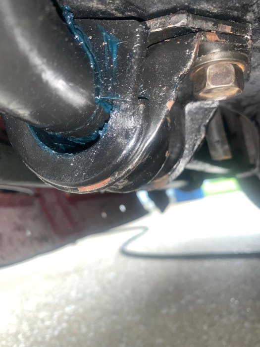

That gap between the bushing and shell looks just like mine.
Not the FF setup on mine, I reused the hardware and ordered the bushings from polybushings.com

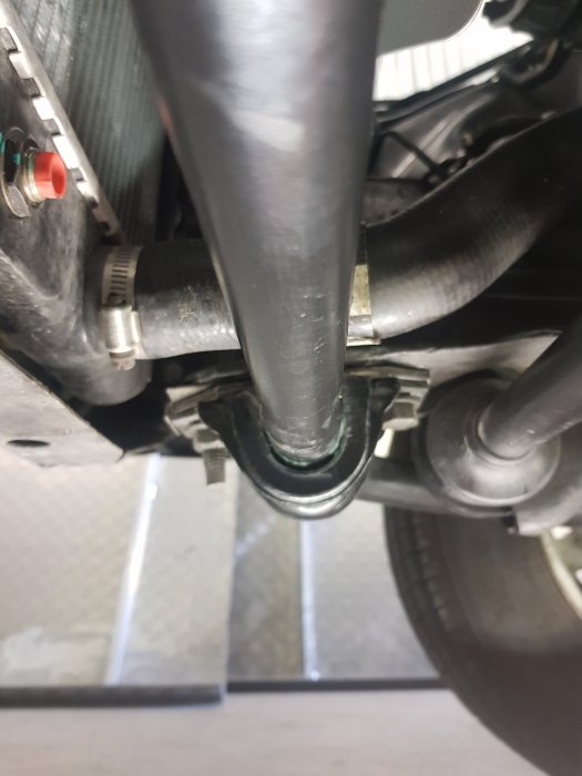

...I have a related question/topic; I recently replaced my pivot cushion bushings with FF inserts/plates and NOS shells, and after putting weight on the car/driving a bit have a gap between the lower portion of the shell and the bushing. Your install looks like I would expect, bushings tight to the bars and shells. Is this typical or has anyone else run up against this?...

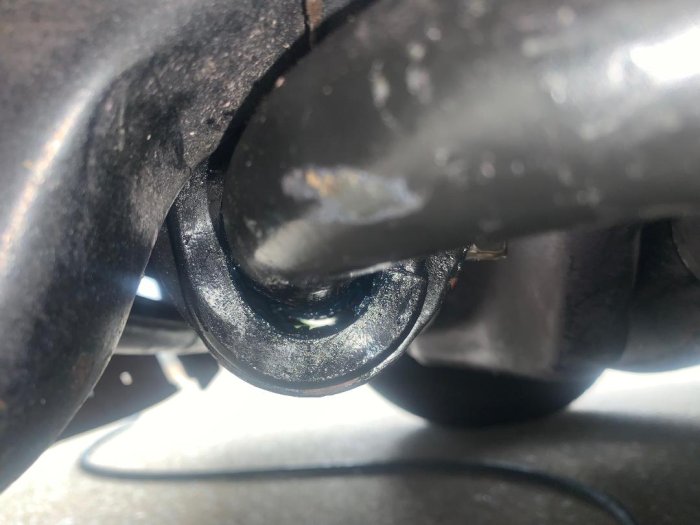

I replaced the End bushings, and Pivot bushings, (Polybushings.com) after a few miles of testing, I noticed a gap in the pivot bushing.
Its like the flat portions was all squished down. With all tension released from the Torsion bars, they returned to normal and fit the bar.
Any suggestions?

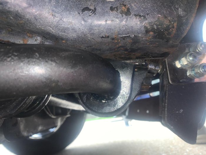

I have the same annoying issue with my poly pivot bushings, and I think it is a common problem.
Sorry to say I've not found any resolution, so I cross my fingers at every MOT inspection hoping the guy doesn't point out the gap between the T-bar and bushing.

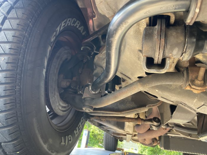

I'm going to have to look at mine. I have the bigger bars from FF and all bushings from them including pivot bushings. I'm due to get it in the air for an oil change so soon. This is a pic I took after installation but I wasn't concentrating on this particular bushing but I think it looks okay in this pic, from the little I can see.

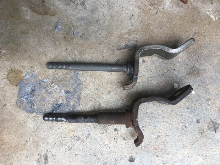

Hey while we are on the topic, fyi there is a difference in the pivot bushing link on AHB vs. Civi. Here's a pic of them side by side. Beefier one is AHB
