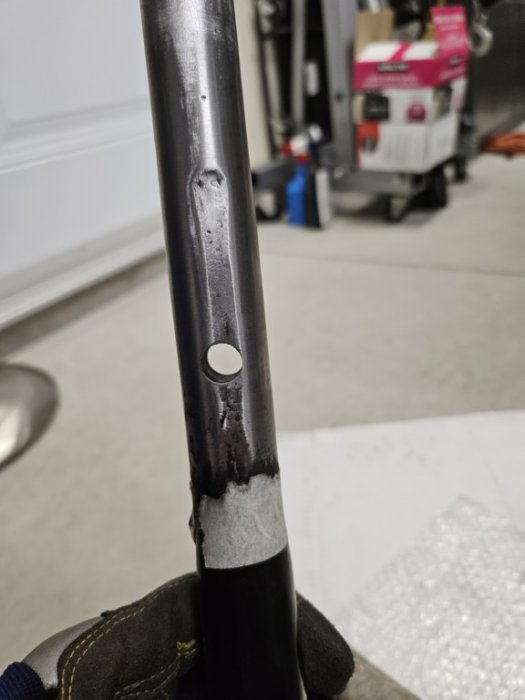

Guys!
Thanks for the feedback. So far no email response from Frank, but it's only been a couple of business days and hard to expect something over the weekend.
So for now I'll give him a couple more days, but ideally I'd like to have a plan by the time I'm heading into this weekend.

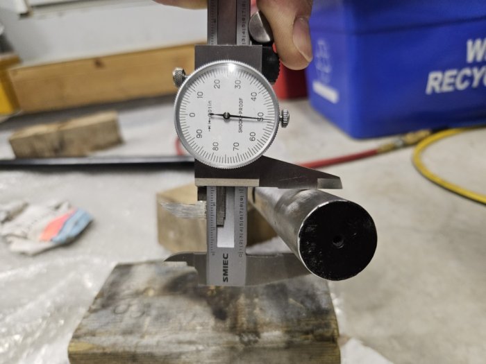

I agree that it is worthwhile to at least take down the coating. My idea literally was to replicate a final crank-polish procedure here, as in: get some rough emery cloth and wrap it around the bar, and off I go turning that thing with a rope until I start seeing some material being removed.
Most likely I'd start with something rougher and leave myself at most a couple 0.001" to finish up with a fine cloth to really smooth the larger scratch marks from the rougher paper.
That's about the extent of DIY that I can imagine here.
In fact I'd be happy to just give it a "go", but would prefer to have FF's feedback first and at least a tacit approval to try this. Otherwise, heck, I need them to take the bar for a re-do, or pay someone locally to give me a machine version of what I described above.

Had a thought; what about a paint thickness magnet/meter? Would be a quick way to see if it is just a thick build of powder coat on the one bar compared to the other.
AMC Diplomat
Feb 14, 2023
1,640
773
NY
Yeah I'd gauge it before trying to remove it. It could be a huge waste of time trying to sand it or melt it off only to find the bar is machined wrong.
Edit: or just knick it with a razor blade and see how thick it seems

Alright...I got a call back from Dick which I actually missed when it came in, but he wasn't shy leaving an extended vm.
The short of it is: after discussing and tossing ideas around at the shop they think this may be a buildup of powdercoating on the bar and advised me to simply sand it down.
Further on, he stated that there should be no heat-treat concerns here because at that section the bar is nearly fully heat-treated through, on the account of the fact that the flattened section of the bar make for a smaller depth the treating would have to penetrate.
Sooo....alright...out come out the abbrasive tools and I'll report back with some (hopefully) good news over the next couple of days!

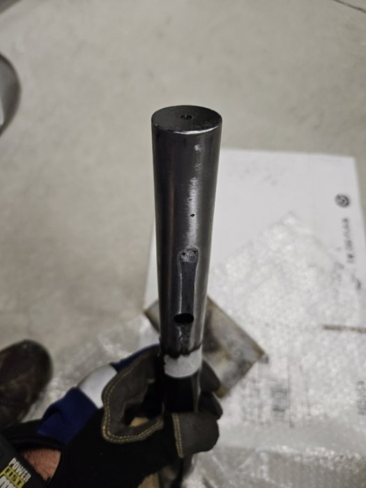

I wish I had better news...but NOPE...that paint coating was at best 0.005"...so yeah, the t-bar is pooched!!!
Tried two things:
1) a DIY belt-sander kind of a thing, but my God...even with a strip of 150 grit paper barely anything is coming off
2) I put a tootsie roll inside the end-brackets hoping that I could maybe clearance a little bit here, a little bit there...nah...barely anything getting taken off, that was a 120 grit wheel
I'm very very angry...I have to be honest...! (thanks for letting me vent guys)

Yeah the idea of a powder coating suddenly increasing in thickness in one area many times beyond normal was a little ludicrous.
A machine shop can mill the end round within spec. The rounder you leave it the easier you'll make it for them

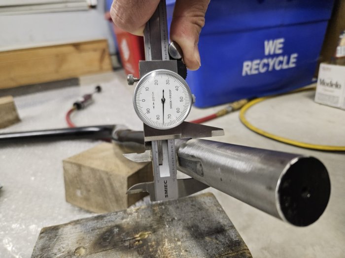

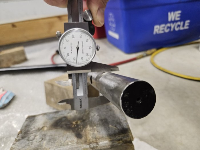

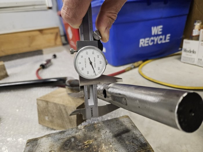

Alright, so good news after all. My trusty shop was able to put this bar on their belt-sander and remove the high sides.
Take a look at the attached pics, these show the differences after I had spent a couple of hours trying to manually sand the high spots down. After this, the bar went on the belt-sander.
