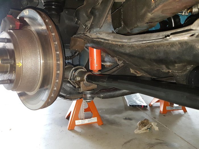

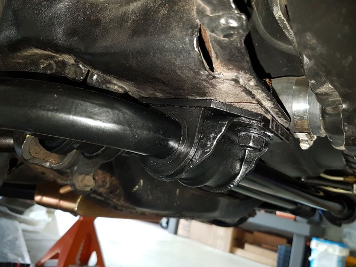

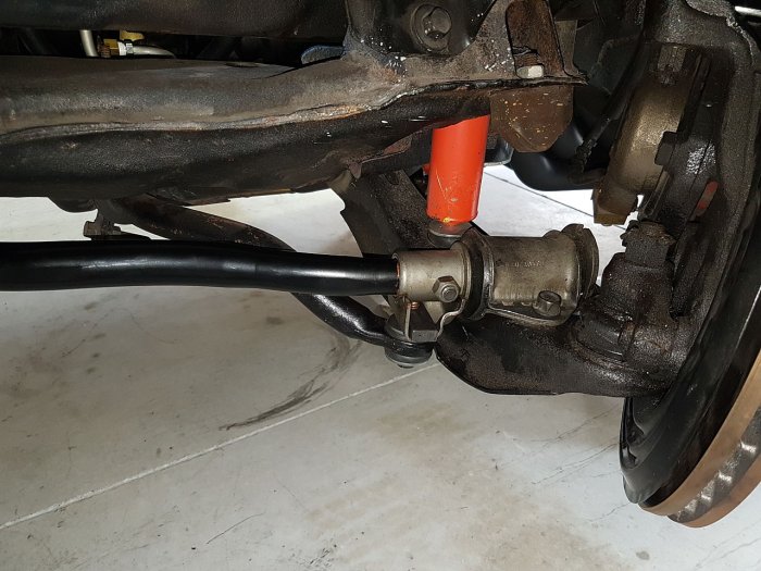

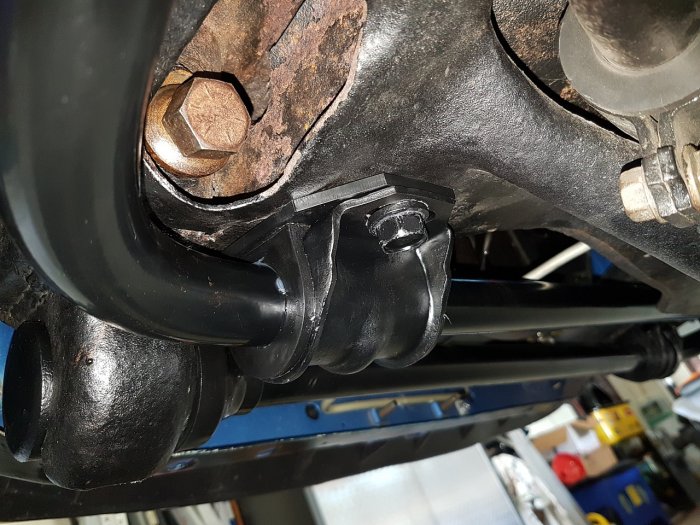

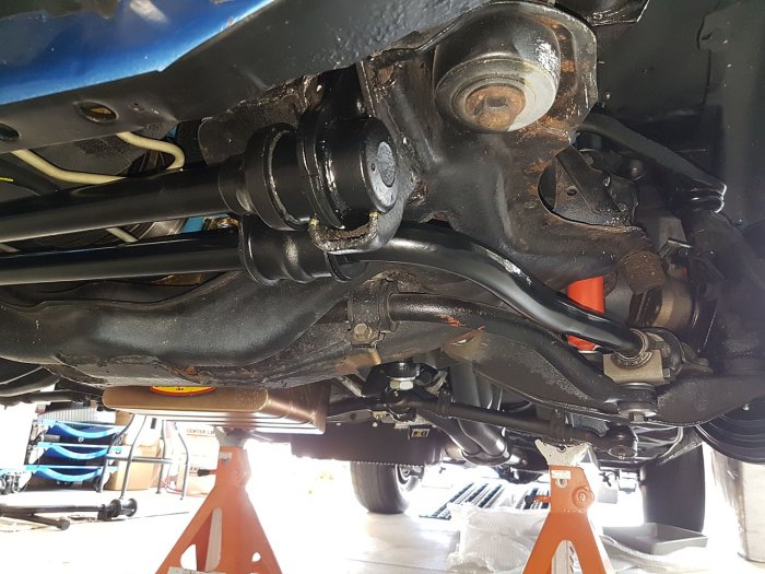

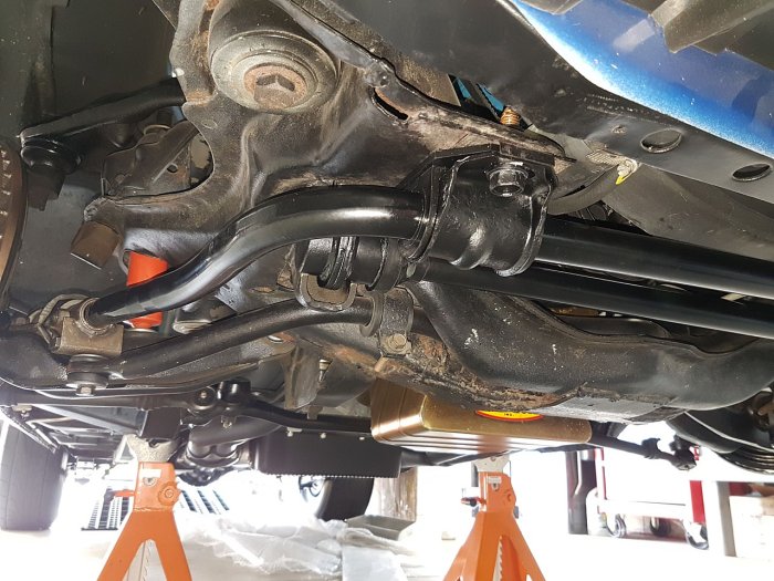

OK, here are the pics...nothing unusual, but maybe a decent reference point for anyone else doing this work?
Thank you for posting pics of your t-bar replacement. I have a related question/topic; I recently replaced my pivot cushion bushings with FF inserts/plates and NOS shells, and after putting weight on the car/driving a bit have a gap between the lower portion of the shell and the bushing. Your install looks like I would expect, bushings tight to the bars and shells. Is this typical or has anyone else run up against this? Also, semi-related, attempting to contact FF over the last couple of weeks and radio-silence, I hope everything is ok out there.
