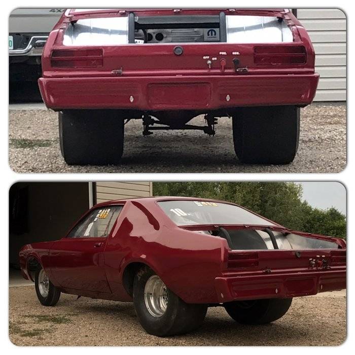

this is what i'm busy with

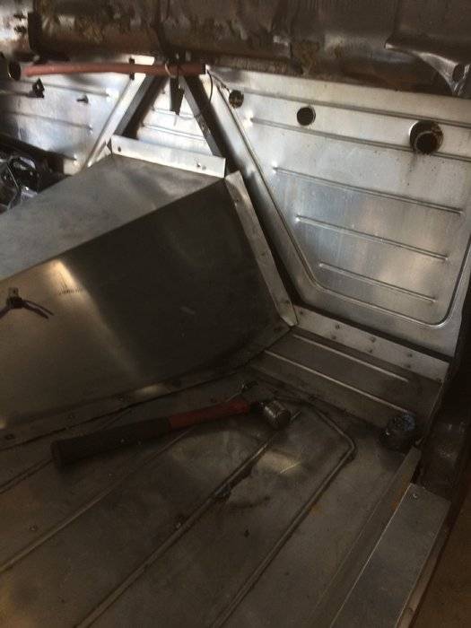

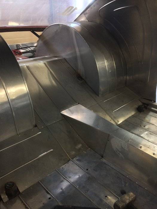

What cleaning products can I use on the tin? It's really old looking and I don't like it. Do I have to polish it?

i use zephr pro 40,i work in a peterbilt dealership and get it there,its lots of work,but comes out good,did my mirada last night,and my daytona few weeks ago

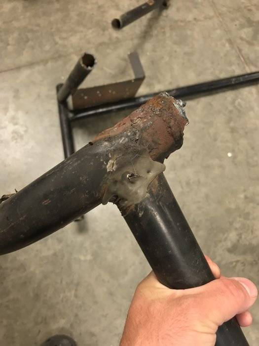

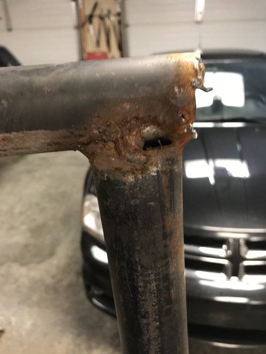

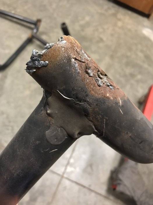

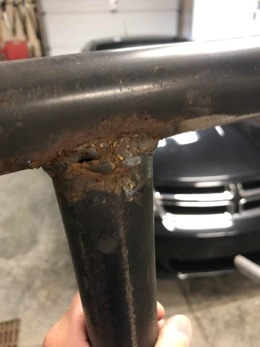

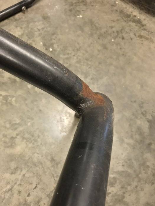

Exhaust tubing and JB Weld for a cage? Good enough for something that may,,,,,well,,,,,,,what are the words I'm looking for? Oh I know, SAVE YOUR LIFE. What are some people thinking?

One product that I found works well to polish metal is Glitz metal polish. I used it to do a final polish on some older factory aluminum wheels. If it is really bad, you can use their chemical cleaner first. I used their Buff ball in a drill to do the polishing, but pretty much anything should work.

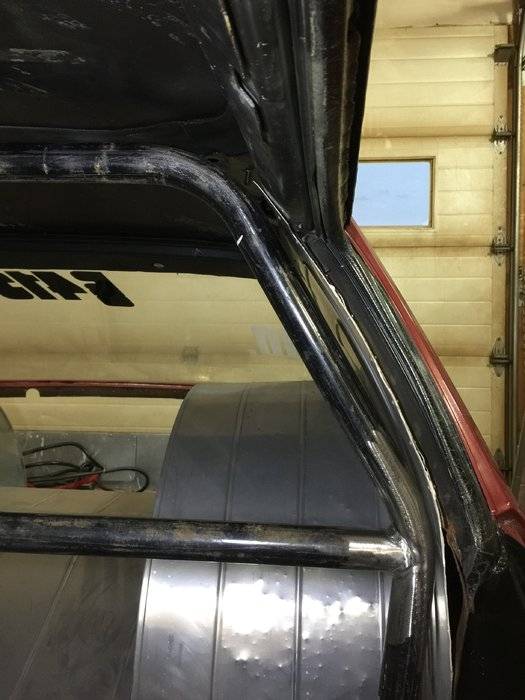

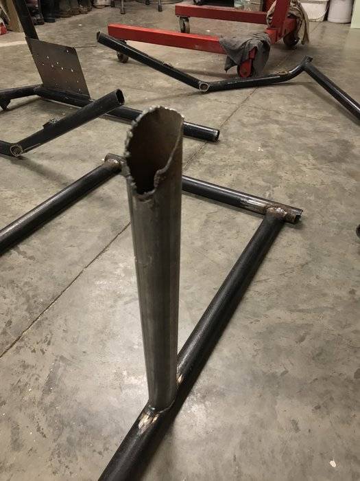

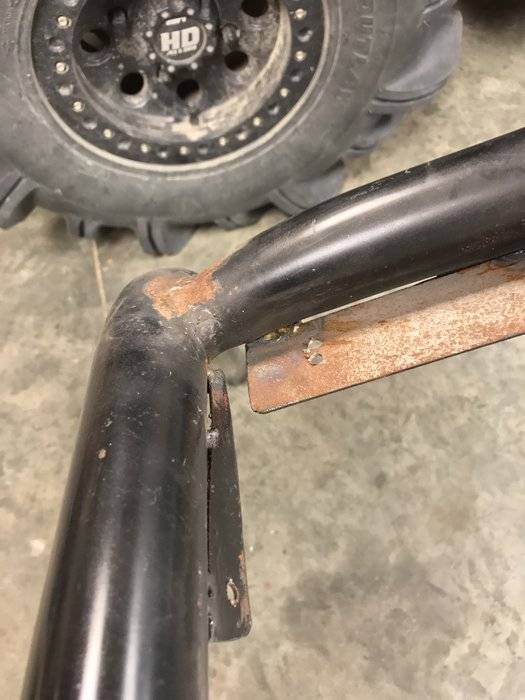

Here is some pics of the cage I cut out. It's amazing how people would do this and actually race it in the 10's. They also flattened the bars to weld together instead of getting a tuning notcher. I will remove all the tin a check all the welds on the square tube frame. My life is worth the extra work.
The pics tell the story.

it would never pass tech. i think he raced on an outlaw track were you don't need to follow any NHRA/IHRA rules. there is a track 3 hours from my place that is an outlaw track. no real rules are enforced. i seen guys running 9's there with no roll bar.
when i went there with my black car, they didn't even look at it. they asked if i ran at an NHRA track and i said yes so poof i was teched in.
hemiman426
Feb 5, 2017
37
21
st.louis,mo.
love that cage,thats unsafe as heck,yea we have a lot of those outlaw tracks in the midwest,all they want is helmets and seat belts and tell ya tech your car at home,ive seen guys at local outlaw track running with windows down,seems track dont care

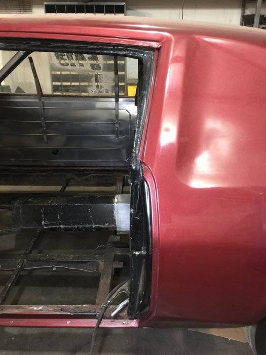

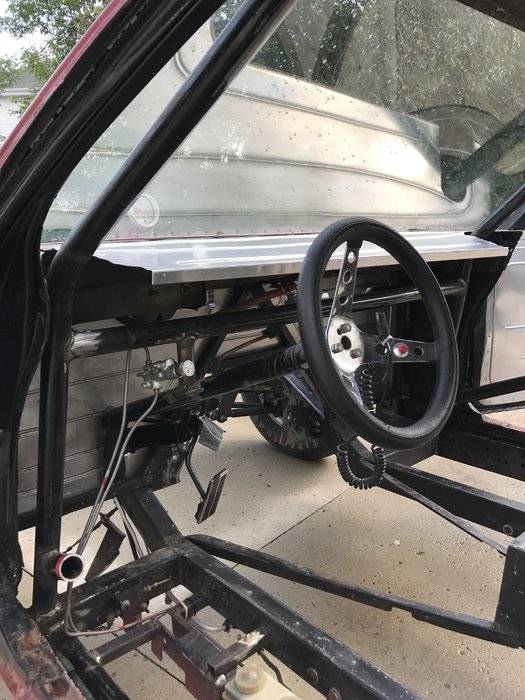

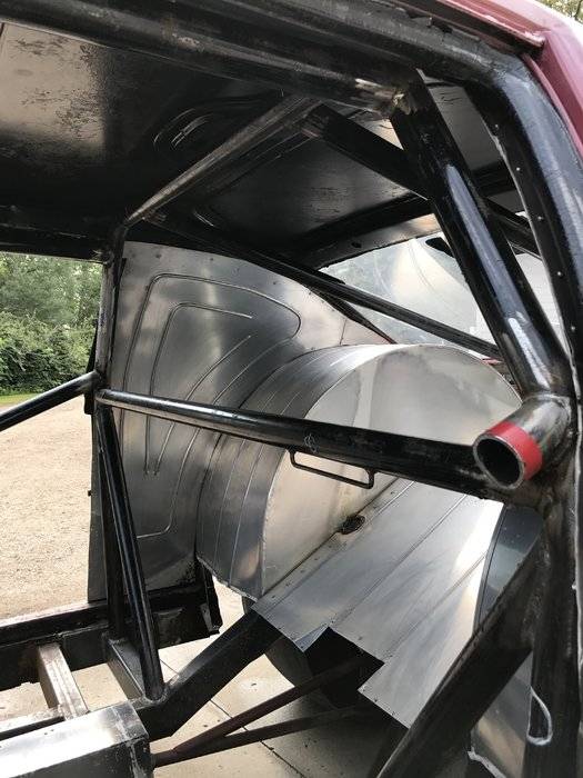

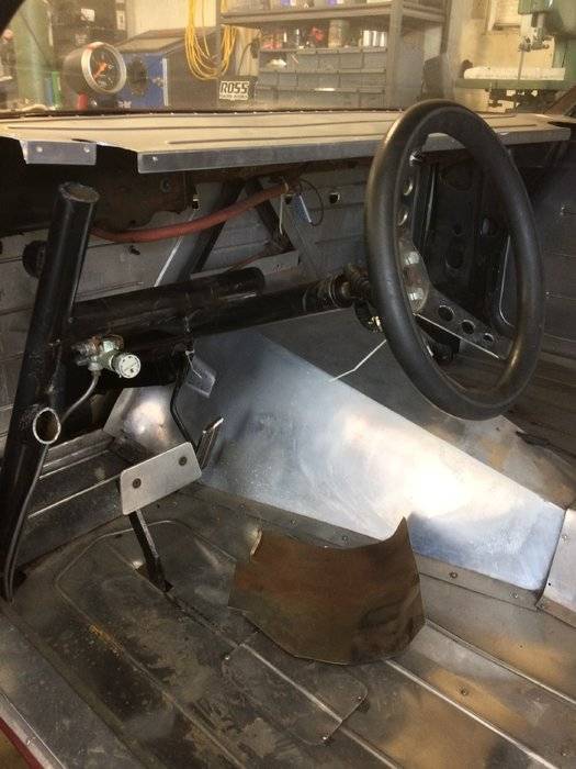

roll cage is finished. i need to buy a swing out kit but that is at a later date. i'll have some pics tomorrow

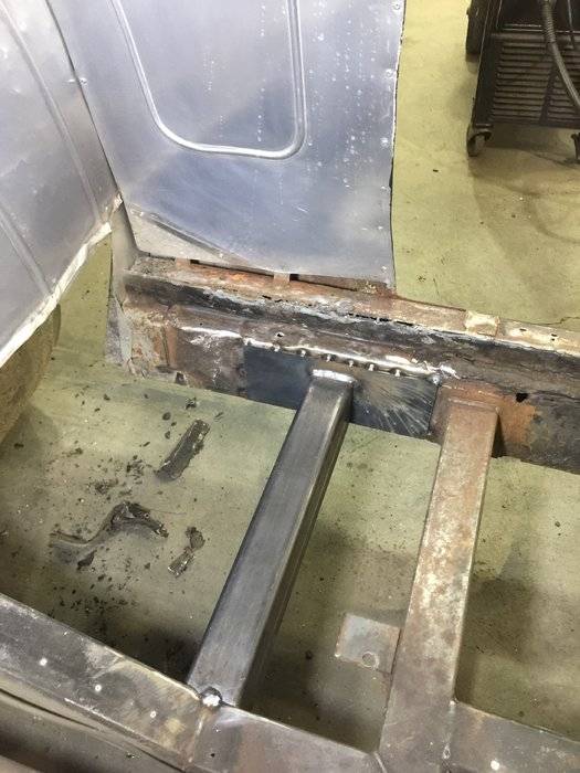

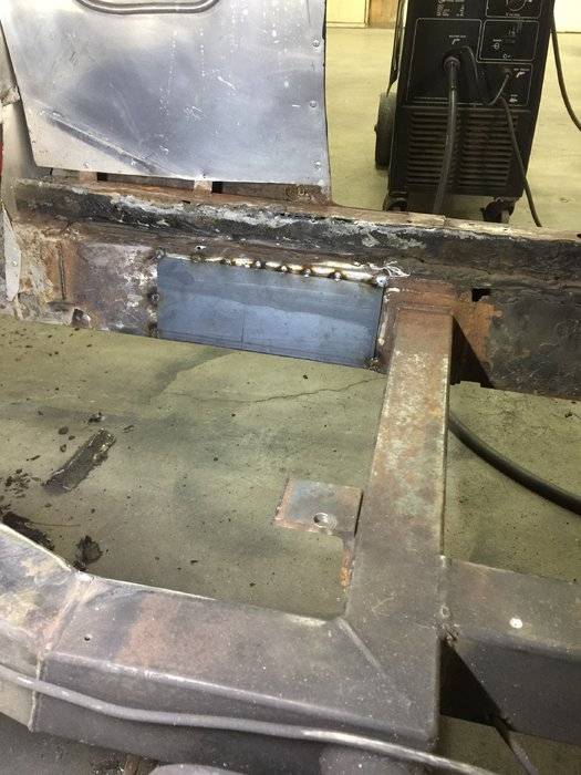

Pressured washed everything so I can start to paint it. Now it's safe to race. I still can't believe the old roll cage was so bad. The work out there is horrible. It's a night and day difference in quality of workmanship.
Chassis got tagged to 8.50 spec.

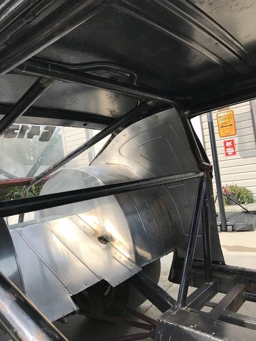

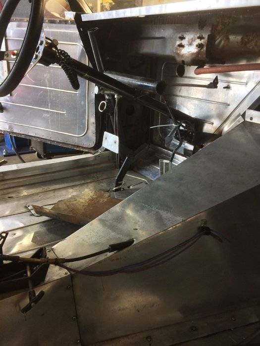

i got all the bar painted tonight. i can start putting the tin back in and then the wiring. after the wiring is completed, it's a rolling chassis. just have a few more engine parts to buy and it's assembly time.

You can lay some really nice looking welds with JB if you put a minute or two in them, or not! This sounds like many of the heaps they list and pass off as Solid, PRO Build, Teched, Clean etc on ebay. Thankfully your putting the time and effort into rebuilding yours right. Mama Mopar approves.

not much happening on the car this winter. i got all the wiring ran and hooked up. i bought a swing out kit so i have to weld that in place and then the roll bar will be finished.
