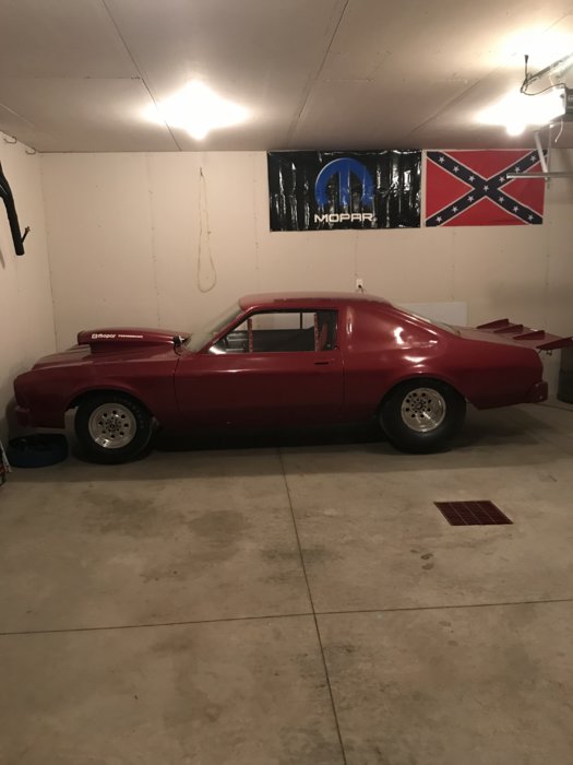

Nothing new happening in the garage. Sad to say but that’s life!
Sitting in the corner of the garage all alone....... at least it is out of the elements.

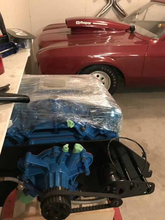

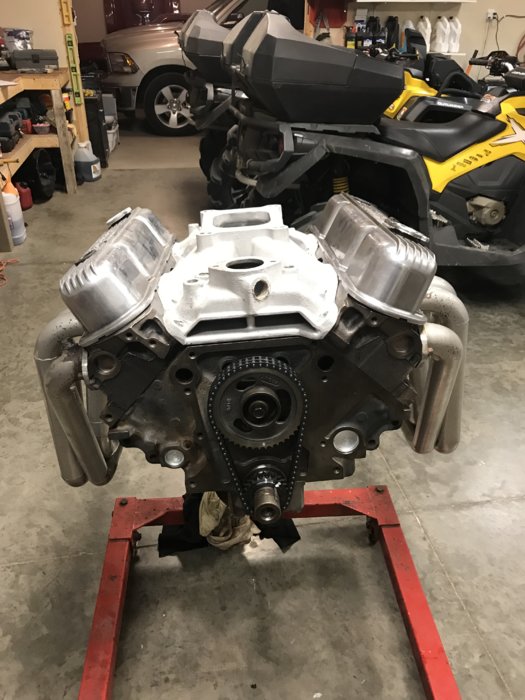

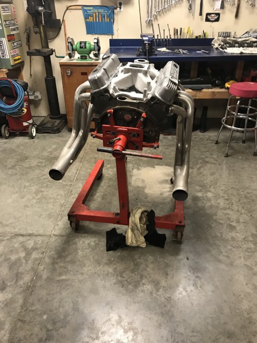

I got the cam degreed today. Finally that’s done. Now I can button up the bottom end.
Order up some head gaskets tomorrow. After that all I need is pushrods.

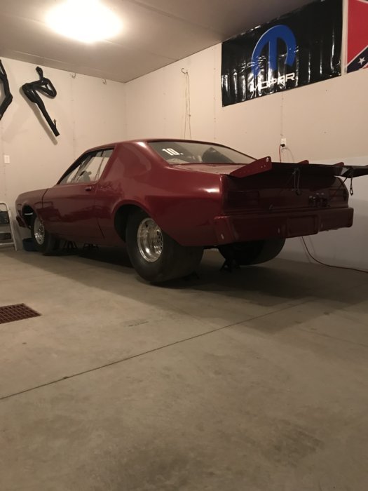

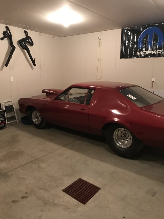

Decided to take a few pics mocked up to keep me motivated!

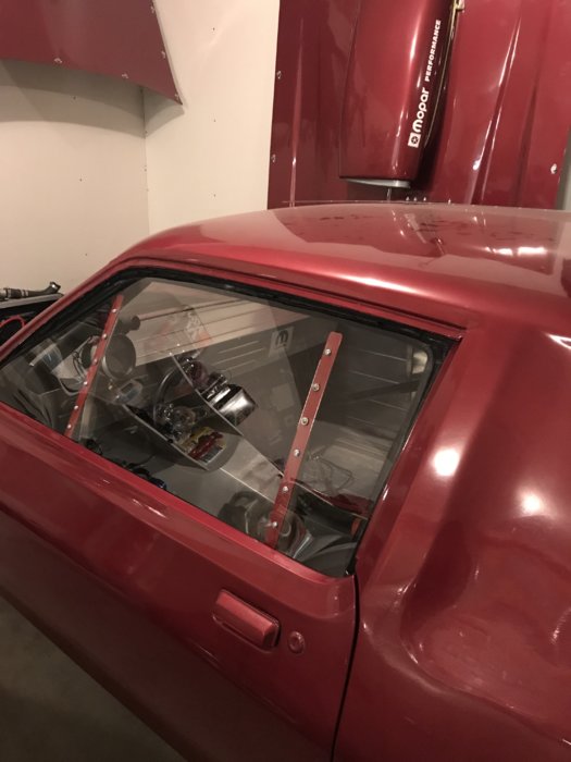

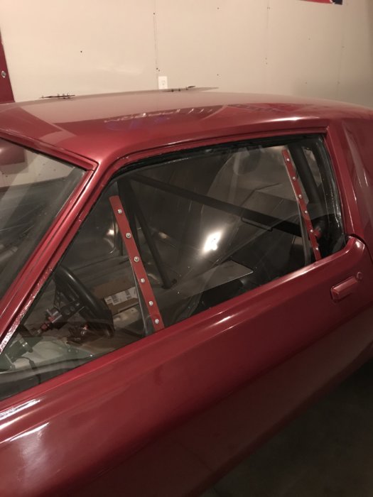

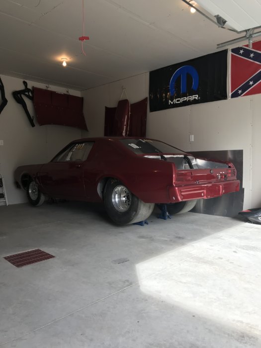

New lexan for drivers side installed. Finally got rid of the old decals. Changes the look with clear lexan

I have done a lot of stuff in the past 2 years to get it race ready. It’s slowly coming together the way I want it. Lots of work (and money) but in the end it will be worth it. I would like to change the colour but I want to make a few passes first.

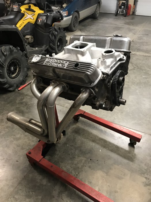

Pushrods is the only thing needed to complete build.

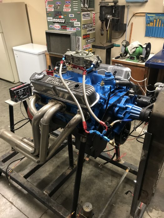

I had to change plans. Big cam is back on the shelf and small cam is now degreed. Piston to valve clearance was an issue with the big cam.
New cam is 572/582 lift. 256/260 dur @.050. I have the clearance I need now.

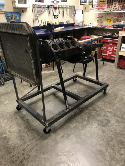

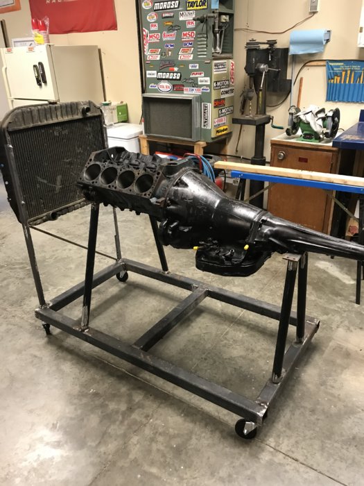

Meanwhile I’ve started to build a test run stand to break in my engine.

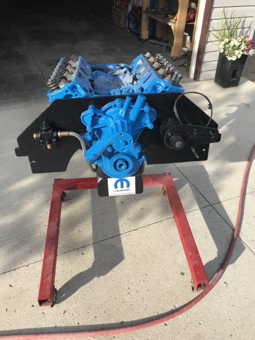

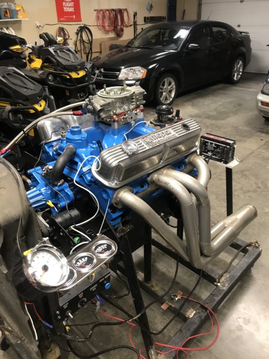

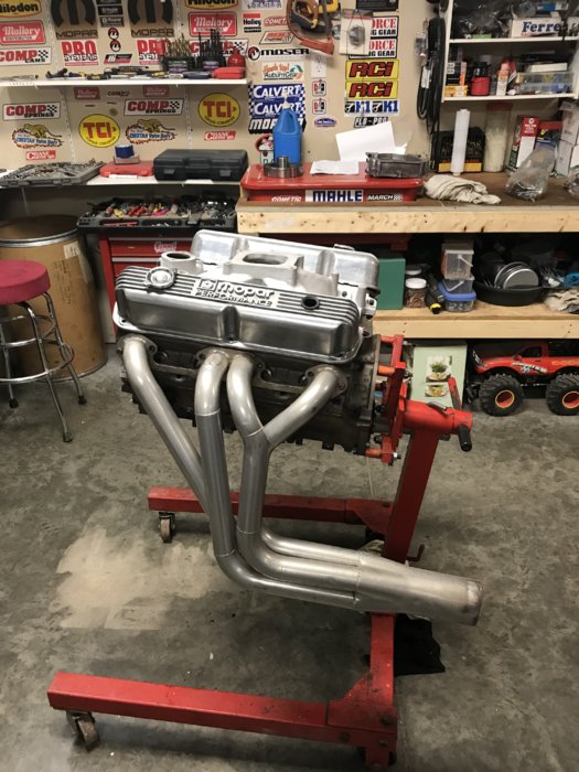

I fired this W2 360 beast up the other weekend. No leaks or breaks so it’s time to put inner springs back in and put in car.

yes i got video but for some reason i can't upload them. says file to big and i don't have a clue as to make them smaller
2,992
Thanks, I needed that this time of winter! :)Sounds AWESOME. Can't wait to hear it off idle, hint, hint, hint.
