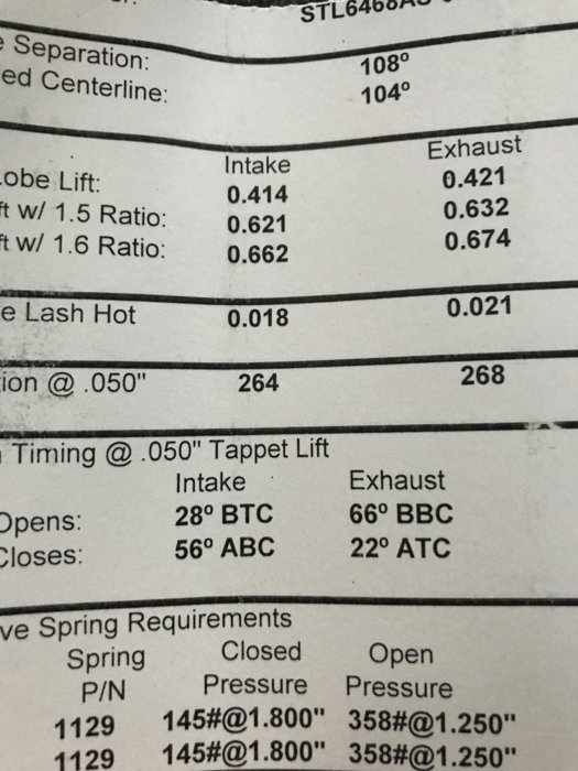

not much happening this cold long winter up here. i managed to order this cam from Hughes Engines. should perform nicely with the W2's
the shipping is worth more then the cam to Canada ($170 to ship) so i got it sent my in laws in Mesa, AZ. for $19.

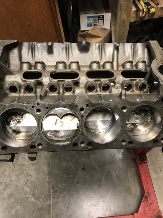

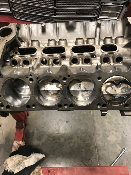

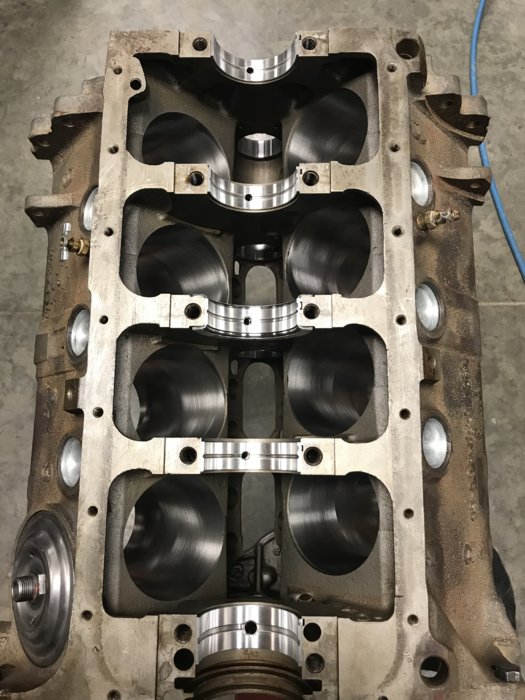

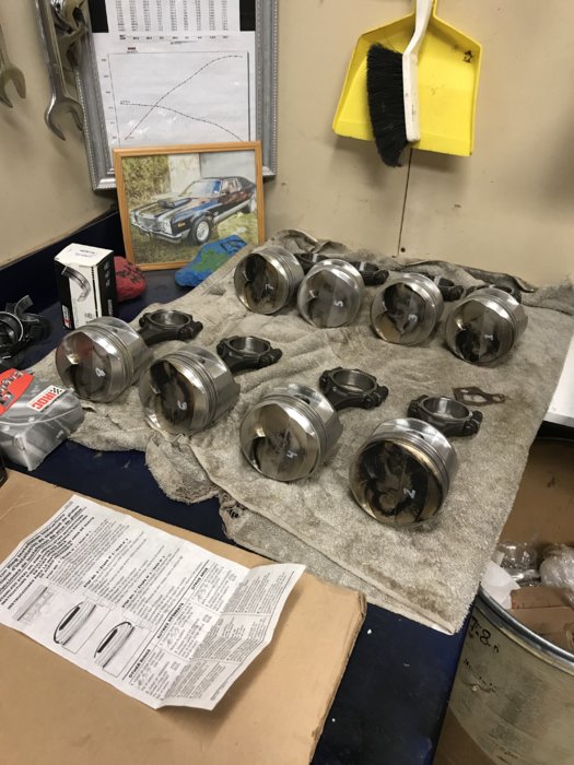

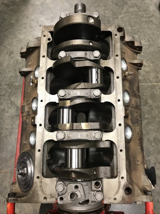

I finally got some time to work on my 360. Block was honed. Crank was polished. New main/rod bearings. New file fit rings. It’s all I can do till my in laws come home from Arizona. They got my cam and headers. Once I get my hands on the cam, I can get the short block complete.

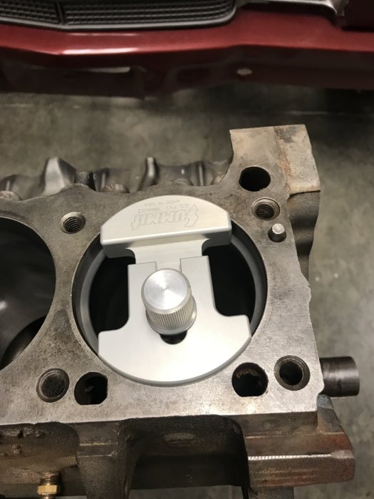

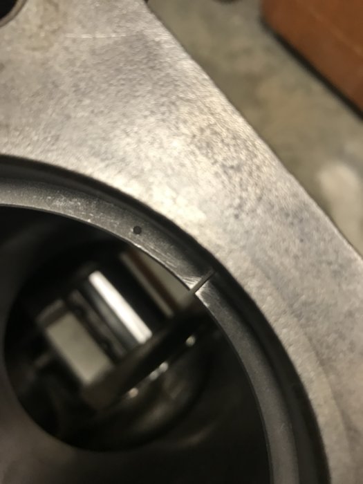

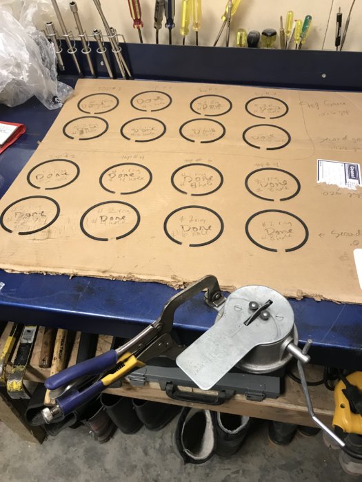

i followed the instructions that came with the rings. they have the ring gaps listed for how much NOS or boost that is going to be used.

...so 2nd gap wider or narrow then the top?
For a number of years, maybe still, there was an on-going debate around the contribution the 2nd gap makes. I set my gaps wider, as per the SealedPower (R-9343 25, file-fit) ring pack I ran. The question, if I remember correctly, revolved around the wider gap either:
1) contributing to removing excess gasses from the 1st ring, thus allowing it to sit more square in the bore and sealing better
2) allowing more oil to get past it and effectively contaminating the mixture, and contributing to detonation
For what it's worth I never an a gapless design...been wondering if that is something I should try in my next build.

top ring gap is smaller then second ring gap.
i talked to several engine builders around my area. most said that for what i'm doing, a gapless design is not needed.

This is the cam card from Hughes Engines. Little bit bigger then what I ordered.
I thought it was gonna be 615/621 lift with 1.5 ratio rocker. Everything else is what they said it was gonna be.

I would definitely check valve clearance.
How much compression does your motor have?

Ha...pretty narly cam...I love it!!!
I run their much smaller hydrualic flat tappet, the HE3844AL, although it wasn't until I tossed the 4K stall converter into the coupe that things really woke up.
