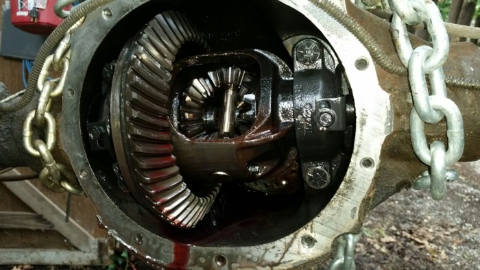

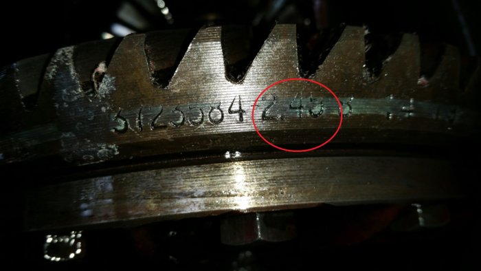

As far as I know, OY still has it's original station wagon rear diff, which I thought was actually desirable being that it is a wagon with the higher (?) gearing. I don't quite understand all of the info that AJ/FormS kindly took the time to post, but I appreciate it. What I do get from it is that I am assuming that by changing out the A833 gearing and possibly the gears in the rear, this would make a noticeable difference. OY already has lots of torque in first, and second, but poops out in third, and then in forth... well, there is a reason it is called an "overdrive". First gear peaks the RPM's very quickly and actually seems to me to be too low. Second gear pulls really nicely. Third is where my disappointment comes in. It just seems to lose it's power. Forth is really only for cruising on the flats, and hills require downshifting to third.

Your existing differential (8¼”) should work fine with a stock or mild 360. A better differential gear ratio sometimes makes a larger difference than engine size does (depending on what gear ratio you currently have) - see earlier posts.

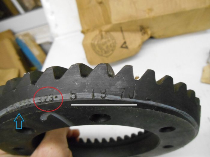

The gear ratio options for ’78 (for 8¼”) are: 2.45, 2.71, 2.94, 3.21 or 3.55:1. Sense you have a manual transmission – I would suspect you have either 2.94 or 3.21 gears (which is what most standards use).
The 360 would prefer to have 3.21 or 3.55 gears (3.55’s (or 4.10's) would be fun).

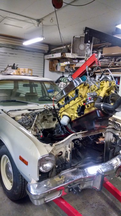

When I convert my wagon to manual, I'm looking at the Magnum (brand) 6-speed (what is used in todays Mustangs, Camaros, Challengers, etc.) so I can have the decent gear ratios, a good low gear and two (2) overdrives. Also the Tremec Magnum 6-speed can handle my big block without issues (this might be overkill for you, though).
A small block bell housing (with O/D) and flywheel will be needed. The bell should be easy to find for a lot were used on the ‘80’s pickups. If using a stock 360 Magnum – it will take a special balanced flywheel (shouldn’t be too hard to find).
The Z-Bar is the hard part. V-8 manual transmission F-bodies were not made in mass numbers. Finding a Z-bar will be hard - it might be easier to make one. I have seen a lot of handmade Z-bars, mainly for A, B and E-bodies – so it can be done. I’m planning on using/adapting hydraulics from a manual Dakota pickup when I convert my wagon to a manual. That hasn’t been tackled yet – so I might be in for a surprise (good or bad).
Any 360 car (’71-81) oil pan will work. Pickup, van or motorhome pan will not work. Here is a new (repop) pan for $51 (US) and I’m sure there are others out there. Fits 1971-1980 Chrysler Mopar SB Small Block 360 Engine Oil Pan Raw | eBay
The radiator necks are in different locations. A radiator shop could re-work your existing radiator – but I recommend getting a new one (either way will work). The big item here is if your car currently has a 26” wide radiator (preferred) or an 18”, 20” or 22” version. If your car came with factory A/C, it should already have the wider radiator. My 318 came with an 18” radiator – which will need some core support work done before I drop in the big block.
The wiring will not be too hard to adapt (see post # 4).
The throttle cable will be a different length. You might be able to use yours, but it might be too long.
Now you have choices to make:

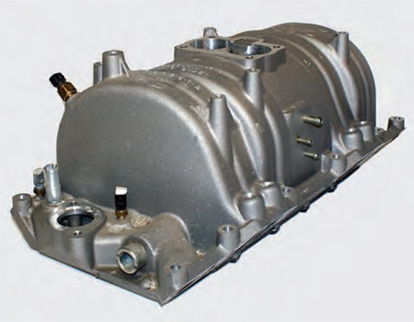

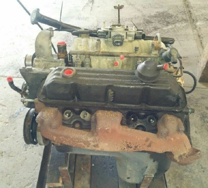

All Magnum engines came fuel injected (with the beer keg intake). If converting to the Magnum fuel injection, it would be a sweet smooth driving and running car, but some electrical and fuel work will be needed to make it fit. It has been done and it works well – but car will also stand out in a car show.
The Magnum beer keg
Which is directly related to the original Chrysler long ram intake (only coiled up).

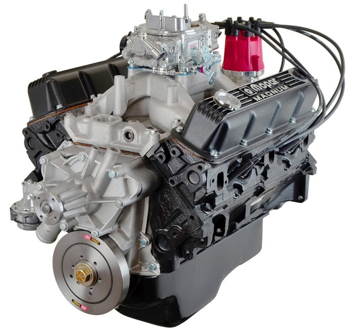

Most people will install an aftermarket 4-bbl intake and a carburetor (or a 4-bbl appearing fuel injection set) – which doing so will make car not stand out at a car show as much. Some people prefer the older 4-bbl look, some people don’t.
Magnum with a 4-bbl intake. Note: this one has the older timing cover setup (more below).
Magnum engine with original beer keg intake (which is hard to see in car).
The next choice will be to use ‘70/80’s timing cover/accessories/pulley system or convert to the Magnum timing cover/accessories/pulley system (serpentine drive belt). The older system looks more in place for our cars, but the new system is more efficient (but harder to convert to because of hose modifications (A/C and P/S) and so forth).
The good news is you don’t have to worry about kickdown linkage (a huge plus).
A fresh but stock 360 Magnum (either fuel injected or carbureted) might give you more power than expecting. Also, you could make the 360 Magnum look just like your wagon came from factory with a small block (if wanted).
If you wanted more power than stock, then the sky is the limit.
The 318 Magnum vs. 360 Magnum is only 42 ci – so not a lot of difference in power. If you can find a 360 for same price as 318 – then go for the 360. Otherwise, I interchange the terms
The 318 Magnum and 360 uses different engine mounts – so don’t purchase the mount kit until engine has been obtained. The 318 and 360 uses different oil pans. Lastly, the 360 is externally balanced – which the biggest issue for you would be the correct flywheel.

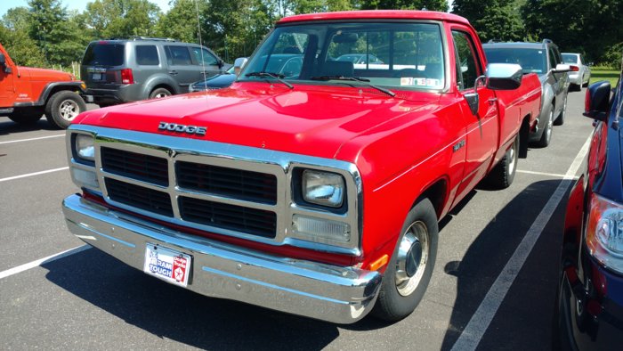

My good friend with the blue '75 Dart Sport also has a '93 Dodge Ram pickup with a fuel injected Magnum 318 and Torqueflight in it.
It is the last year for the ancient old body style, but the engine itself only has about 70K miles on it and runs really well. We have talked about transplanting that Magnum into his Dart, or OY for a while. He obviously gets first dibs on it, but I have thought that it would be a LOT of fun to have that engine in OY!

How would I tell what gear ratio I have in my 8 1/4 differential now?
The best way to determine your current gear ratio is to remove the differential inspection cover. Chrysler says you are to change the differential fluid every 30k miles to begin with and check differential fluid level every oil change. I would say you might be due for fluid service anyway.
Once the cover is off, rotate the propeller shaft until you find some numbers stamped on the ring gear, like this:
The blue arrow will be part number. The red circle is the gear ratio. The white line is the date of manufacture (which should be a bit before vehicle build date).
This 8¼” came from a ’80 F wagon. This is the numbers on it: “3723584-2.45 8 14 79” (the 79 is off the picture) which would be 3723584 is ring gear part number. 2.45 is gear ratio. Manufacture date was 8-14-79.
This one is an open (non-limited slip) differential.
Note: 2.45 ratio is a dog. You might as well be towing a pickup behind your vehicle, permanently. 2.2 gears are even worse.
Note: I will not recommend going back with an open differential if you are performing an overhaul or gear change. There is so many advantages to having limited slip (if not already present) that I must recommend upgrading to it (again, if not present). A majority of FMJ's did not come with limited slip.
My ’77 wagon was built with limited slip (yahoo!).
