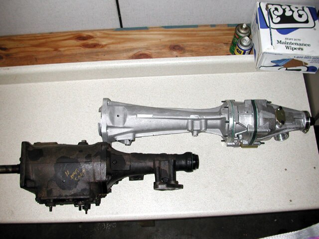

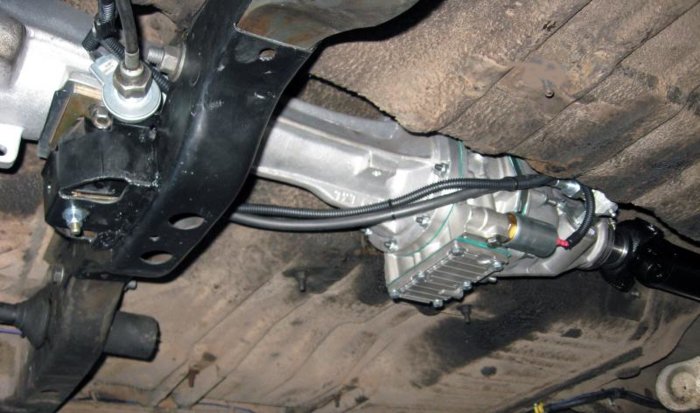

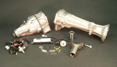

    In case you didn’t know, the Gear Venders “O/D add-on” bolts onto the rear of your existing transmission. Actually, to allow you to reuse your existing transmission mount/crossmember, GV (Gear Venders) includes a longer tail housing. At the end of the tail housing, you bolt on their gear splitter and it does extend the length of the transmission assembly quite a bit.
    The propeller shaft will need to be shortened and, in some cases, the floorpan may need to be “massaged” to make it fit.
    aghr4sm - Gearvendors (part number 3DFS833G)
    The picture on Gear Venders website for A833. The gear splitter will, in effect, allows you to use 8 forward gears.
    This is an A833 (lower half of picture). The GV extension and unit is listed above (to give an idea on how much longer things will be).
    An GV unit installed on a B-body.
    The propeller shaft is on right side of picture. The A833 case is not quite shown, but would be just off of Left side of picture.
    I’m not familiar with the Commando unit he is talking about (I don’t think …) so can’t comment about it.

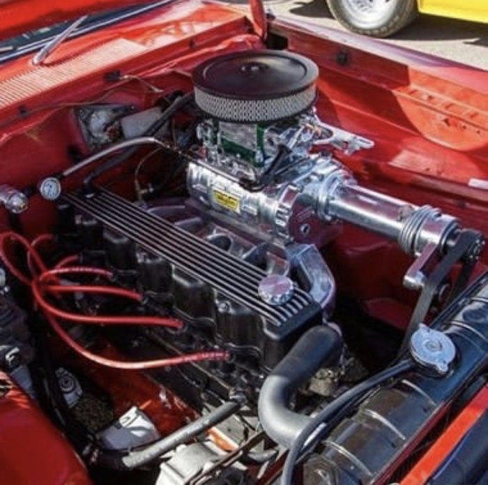

    For that kindof money, you couldda had a side-winder super-charger, or maybe a turbo.. And those air-pumps,increase the low rpm power like nothing else can .............. so whatever rear gears are in it now, can stay, at least until they blow up.
    Ok so; that Magnum in the corner is looking mighty attractive about now.
