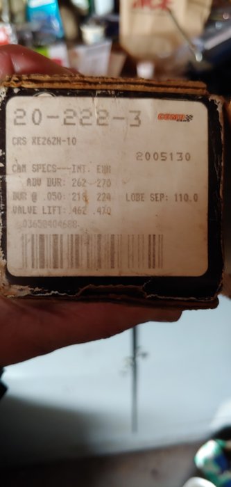

Well here's where i'm at.... The block itself is still in good shape. When i pulled the heads over the winter and checked out the cylinder bores there was no scoring on them just a little carbon build up on them. So I clean the tops of the pistons and cylinders and I could still see the factory cross hatch marks. The motor never had blow by or burned oil while idling or driving, the only time you saw a puff of smoke was at start which I figured it was bad oil seals on the valves. So I bought a set of 302 heads for the car and since the car already came with flat top pistons I figured great! Boost in compression. I already have a cam, its a comp xe 262h. I bought a cloyes double roller timing chain and also hunted down the magnum timing chain tensioner to throw in there. I bought a edelbrock dual plane performer intake since I can't really used the streetmaster i found some years ago. And an old Carter afb competition series 600 cfm carb that i rebuilt. Ive been thinking running that for the time and possibly going with a 500 down the road. I'll post a pic of the cam specs

how far down in the whole are the pistons at TDC? what are volume of the combustion chambers in the heads? other than the cam, your game plan sounds solid. call comp cams after you determine the compression ratio and ask if that is the cam they recommend. a carter avs or thermoquad with a air valve door would work best for a carb or a Holley vacuum secondary. carb.

That's a good cam for the application. 1300 to 5500 RPM range, factory converter, and mild gear is what is calls for, so probably 3.23 or 3.55 is good. The intake you have is a perfect match too.
As mentioned you should definitely measure how far in the hole the pistons are to compute your compression ratio with the 302 heads. I would guess you're going to land somewhere around 9:1.
Be sure to get the recommended valve springs and change those out. Last but not least, degree the cam before final install. Do not skip this step!

XE262H will leave some torque on the table because it's designed to be strongest just as the 302s run out of flow. But it's impossible to care once you hear it idle.
And with a swirl head, flat tops, head surfacing, and a .470 lift cam you should absolutely be doing your math. That's a lot of variables moving closer to each other.

Hmmm.... Thats interesting. When i bought that cam, the guy told me it would work with stock application parts and i wouldnt have to mess around. The piston at tdc is almost flush with the top of the block from as far as I remember, but i can always check again. As far as the chambers on the heads they are 58cc, from what ive read on the heads. I know the stock heads were 65cc. I guess I'll call comp tomorrow and see what they say.

With the numbers you posted and the "near zero deck flat-tops" You're in trouble already. If I input .012deck clearance for 2.36cc, add 58 for the heads, 6.8 for an .028 gasket that totals 67.2cc ind the Scr comes to (652 + 67.2)/67.2=10.7. with an .040 Quench
Then with the cam you posted the Ica becomes 57*, and when I plug that into the calculator,with an assumed 617 ft elevation from Wiki,
it spits out 186psi/8.96 Dcr
That ain't gonna work on pump gas
To kill that pressure you're gonna need a cam about 4.5 sizes bigger, or like a 292/114....... ;course with just 318 cubes, it wouldn't have hardly any giddy-up off the line. You'd need a big TC ,at least 3.91s, and a mid to hi,6000s shift-rpm
If your heads were 58cc aluminum, you'd be all set-up for a fantastic combo.

I was under the impression that the 318 is still factory. If that's the case he is going to be nowhere near 180 PSI for cylinder pressure - that block will have smog pistons in it. As said, just measure how far the pistons are in the hole and do the math for piece of mind. With everything you have though it should go together without any issues.
@Oldiron440 is absolutely correct. Don't mind the other comments outside the scope of the project. You've got a good collection of parts. Assemble it and have fun.
