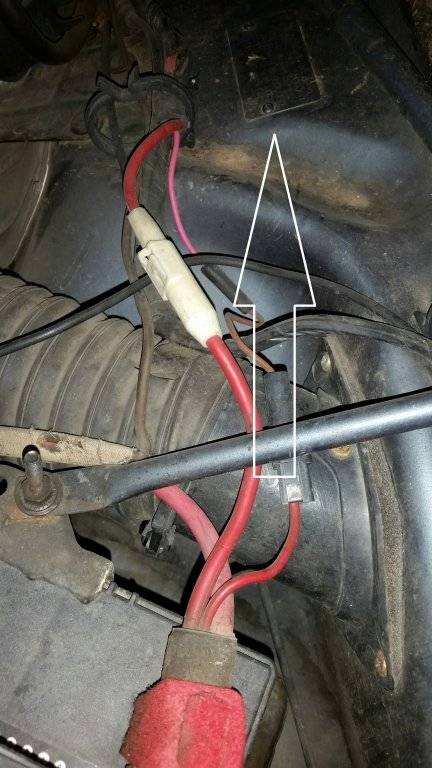

AHB is the Chrysler sales code for police cars.

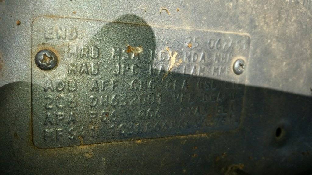

If a car is a real AHB, it will be marked as such on the fender tag
The fender tag is on the Left inner fender as indicated by the white arrow.
This fender tag IS NOT from an AHB.

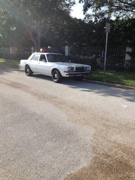

My '89 with a period correct-ish light bar just resting on the roof. Car has 410 small block, dyno'd on engine stand at 468hp/528lb/ft torque, 3.21 sure-grip with the stock AHB 8.25 rear, 727 trans. Scary fast.
