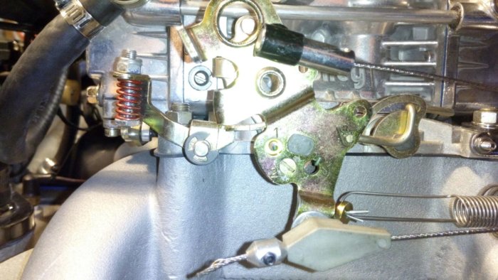

Ok I took some measurements tonight, the ratio is wrong by just over1/2", I need to move the accelerator up 1/2" I am lucky there is a hole just in the right place, from what I have been told this is a very critical part of the trans operation.

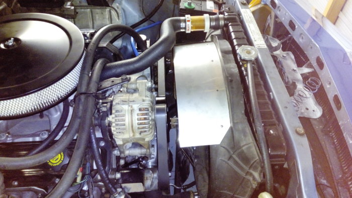

Secondly I fitted a shield on radiator. Cowling tonight. I need a new vicous fan clutch the one I have growls.

ok we are sorta getting there, we have top gear now but you take your foot off the gas then it drops into top. Ok looking at this pic with my red lines, the trans is the bottom one, if I shift that locking thing to the left its going to let the leaver return further, if I move it to the right its going to pull the on the leaver at the trans and push it further back, left will do what and right will do what?
