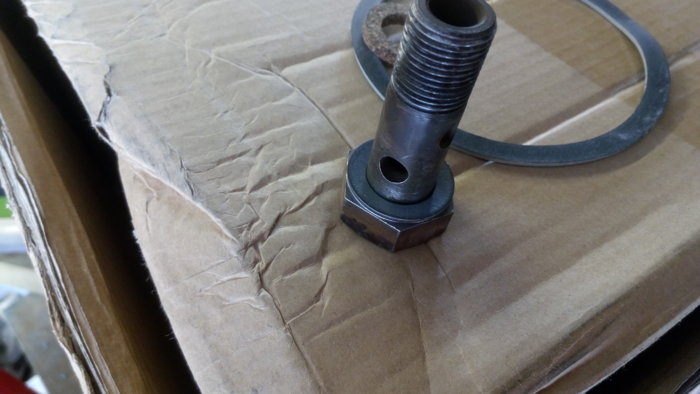

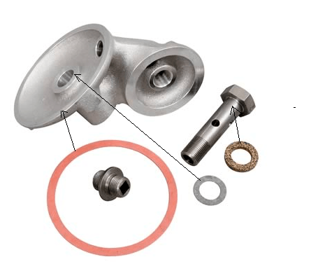

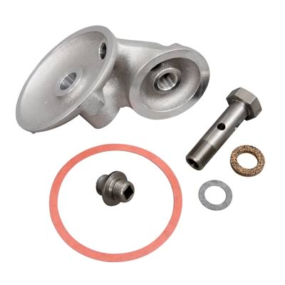

I used a gasket that looked like a ufo with 3 legs connecting to a smaller center gasket, does the cork one go under the head of the bolt, if so I never used, is this my leak source?
Have i got the arrows pointing to the correct places?
My Friend

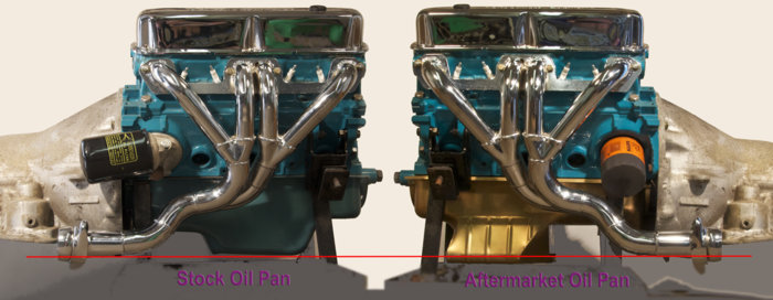

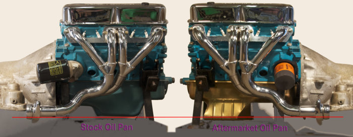

FMJ’s without the 3-cat system – all came without the 90' adapter.
All FMJ’s with the 3-cat system did use that adapter system.
Headers are the wild-card – so can’t comment there.

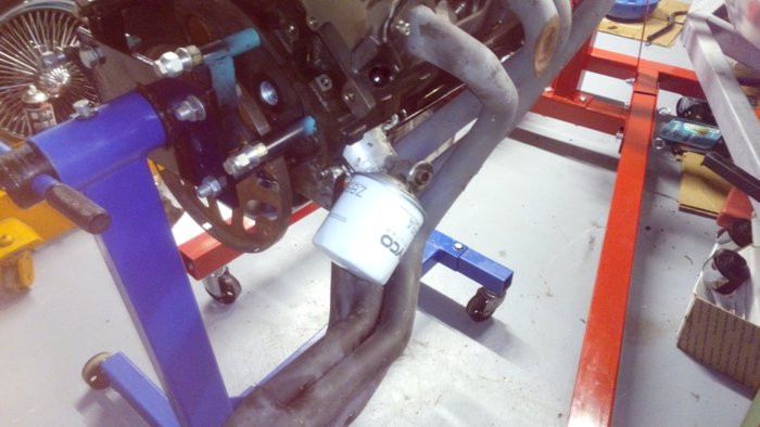

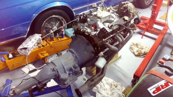

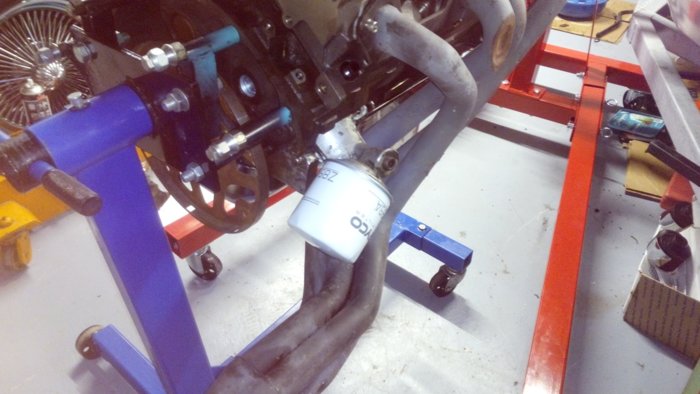

Looking at these two photos, it “appears” the oil filter will be hard to get on/off if you do not use a 90’ adapter.
This photo is not applicable, per se, but shows the adapter difference, on engine. The picture on right has been flipped – so you are looking at the Right side of engine.

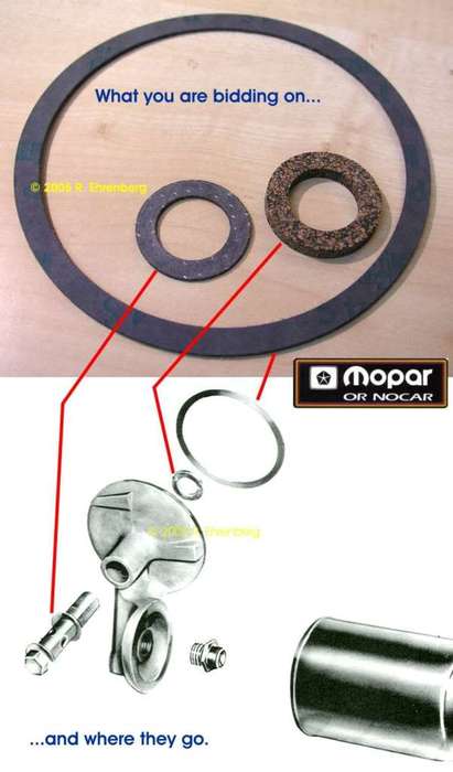

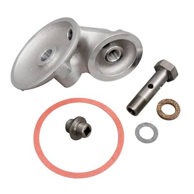

The external filters use 3 gaskets – or two, depending on design. Some gaskets, the inner and larger and smaller inner gasket is made into one gasket. Most that I see now days are three gaskets.
The thicker one goes by bolt head.
The smaller/thinner one goes where bolt goes to block.
If you do not use the smaller/thinner one – you will not notice any difference – but part of the engine oil will not be filtered.
If you use the thicker gasket at block, then the larger diameter gasket will not be able to hold a good seal.
The non-90' adapter does not use the inner gasket.

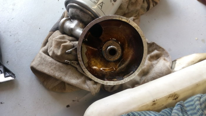

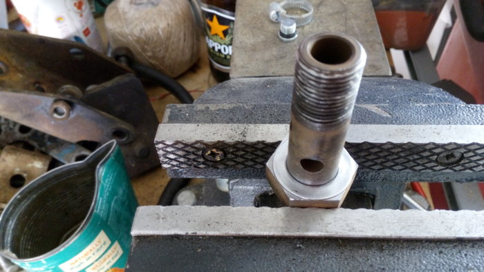

ok guys looks like I had it wrong here is how it goes together, I pulled mine off this morning the one at the bolt head is welded on and I have it soaking in gas to get off, the cork one (which wasn't cork on my car) broke in half when I took it off, I am kicking myself for not researching this more!

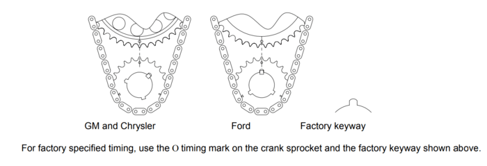

Did you install the timing chain?
If so, might there be a possibility the camshaft timing might be off a tooth?

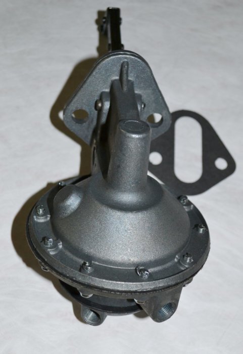

Some mechanical fuel pumps were designed to be rebuilt. If it looks somewhat like this:
Then it can be rebuilt.
If it looks more like this – then the only thing you can do is toss it, when it leaks:

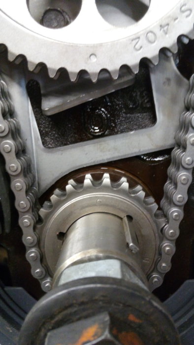

Here is my timing
Timing marks look great. Glad to see the chain tensioner in there!
Did you use a degree wheel to make sure camshaft timing (not necessarily the same as timing chain timing) is correct? I doubt it would be that far off – but might be.
The only other thing I can think of is the oil pump shaft being out of time with camshaft – but that only affects the distributor position in block and not timing.
