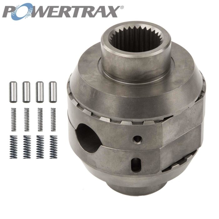

wasn't there an outfit that just took the guts out of the open-type case, and replaced it with a ratchet deal? I remember those as being fairly cheap. Probably a lil noisy but it's only on the turns.......
Oh wait, those might not work with C-clip axles.....
1,492
hey Bud wasn't there an outfit that just took the guts out of the open-type case, and replaced it with a ratchet deal? I remember those as being fairly cheap. Probably a lil noisy but it's only on the turns.......
Yes. I call them the poor man spool.
Don’t think they were meant to ratchet, though (could be wrong).
They replace the spider gears and lock both rear axles together.
I wouldn’t waste my money on them. If I wanted to use a spool – I would just get a spool and reduce all of the rotating weight (unless you were stuck out of town and this could get you home).
My opinion, anyway.

The powertracks has a camming and ratcheting action. It is obnoxious in a street car, and can be hard on parts. I have helped install and ridden in cars with them. Spools are less annoying, but harder on the axles.

Oh, OK. I have driven a spool with 325/50-15s in town, for, about 4 hrs. Then I went home and next day, I tore it outta there.
