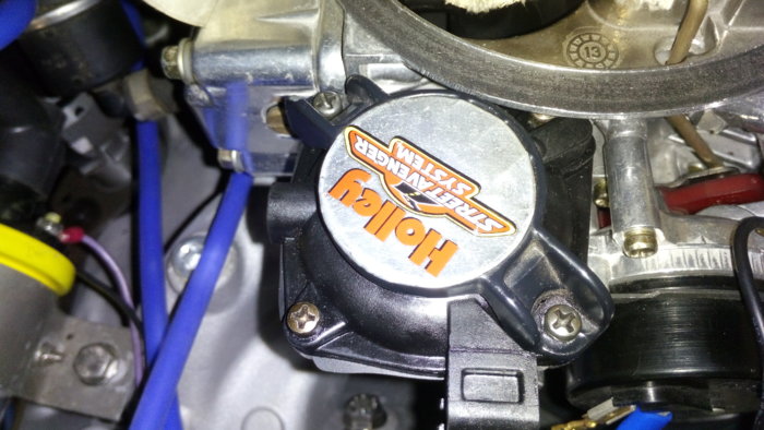

WOW!! will watch at home, I would of liked to have had my carb post in here as its part of my build but thought I better start another thread as I didn't want to offend anyone.

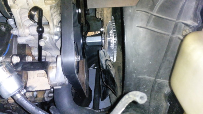

Fitted quick change vac secondaries thing tonight, and a new vicious fan clutch with longer bolt to push fan closer and away from bottom hose.
1,492
I don’t think I have seen a long nutted fan clutch like that. Good to know they are out there.
How far away is the front of fan clutch to the radiator?
Are you having any problems with overheating and/or with A/C performance?

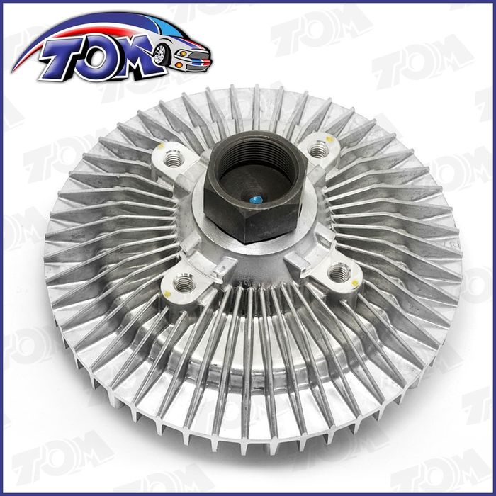

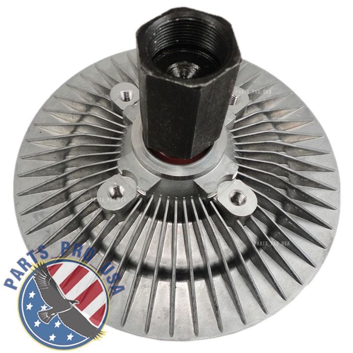

no the bearing was gone in the old one and would make a grrrrr sound at a certian rev, its about 3 times longer, they were on the 2002 and later engines in a certain truck model.
Cooling Fan Clutch for 02-08 Dodge Ram 1500 2500 3500 3.7L 4.7L 5.7L 5.9L 8.3L
