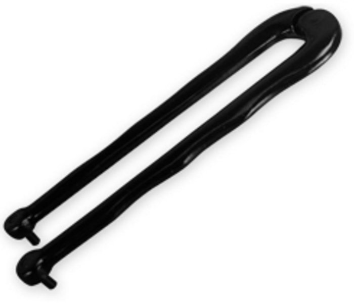

Chrysler makes a special took that makes setting the ring gear easier. It is a 1-3/16” hex (note I might be off on the exact size – going by memory) tool that is inserted through the axle tubes to adjust those bearings. I have a low tech tool in my garage for that (ie: a C-body torsion bar works great) purpose.
Depending on year the housing was made as to clearance space – but many times you have space/clearance to get a pair of snap ring pliers in to perform the adjustments (but not in all cases) They make a tool to use – but these do not work as well as 90 degree angle snap ring pliers.

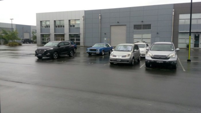

Well she is going strong, first trip to work which is a quite a few miles from home and she didn't miss a beat!
She looks odd ball parked in the carpark at work thats for sure! But I think it is the coolest car there!
3,133
799
Looks great, people must come up and ask what it is.
But at this point it's an odd duck in the U.S. also!
But still cool.
