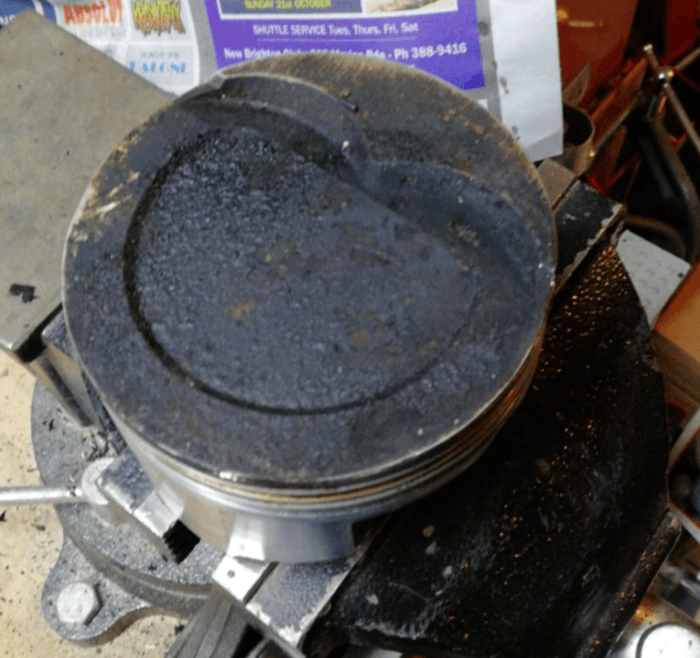

    I scored a set of KB416 pistons off racing junk for not a lot of $$$, seem to be in good shape. Been cleaning them up!
    Before

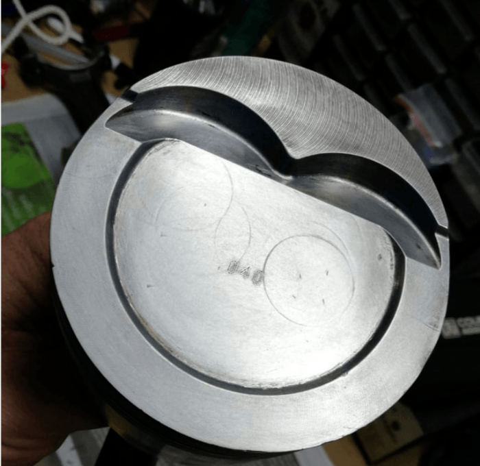

    After - No idea what the crop circles are, but they all have them, any ideas? is it when they were tapped into the block?

    Those look like Mark's from a clamp, maybe they had the valve reliefs adjusted, or they had the piston weight adjusted

    Ok apparently talking to engine guy in chch it happens where the mill head touches or finishes, can't remember which way he said now, all pistons are the same. So makes sense, he said nothing to worry about.

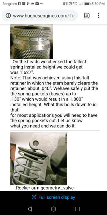

    Fist snag - the install height is 1.58" making seat pressure 160, got 2 options, machine seats or offset retainers. Hmmmmm
    Seems huges had similar problems

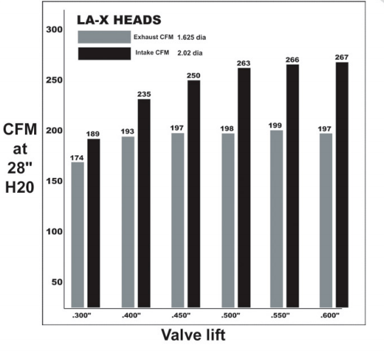

    This is all I can find, but I have stock size intake valve so flow will be down a bit. As you can see .550" is about where they stop I am .507, but then getting big lift at install heights of 1.64" is a problem, I have some after market Mopar Perfomance springs good for .600" lift so we should be safe. I can't remember now, take spring down to install height, then squash it down, measure that and take 10 thou off per turn on the spring, I think its something like that. Howards have said 110 - 130 on the seat and 320+ at max lift.
