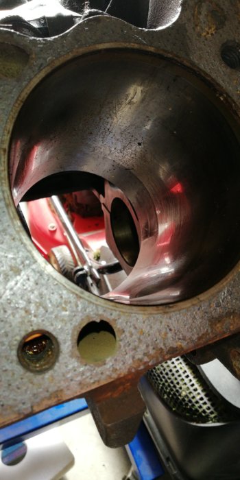

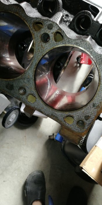

Just hit first major snag, piston are 40 over, block is a mag block, mag block may not bore 40 over, hmmmmm the standard bores are perfect! no lip!

Get the bores sonic checked. My original 360 build was a 1985 block that had to be bored .040" over and it was just fine.

Options are new pistons
Different block
Sleeve block you have if walls don't measure up, if that's the case use thick wall sleeves.

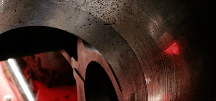

Bit hard to see in photos as a lip test is done with your finger nail

This block has no wear, I can't feel anything with my finger nail! No need to bore it, only reason I was going to bore was because I had over sized pistons. The cheapest pistons would be the KB416-STD I have found them at Huges for about $400 including rings. By the time I get them to NZ they will be about $800NZD so they are expensive!

I've been thinking about this and the thing that concerns me is the increase in stroke, your cylinders would have to have zero wear on top and bottom. Because of the increase in stroke the rings will go past the original stopping pionts, something the LS I mentioned earlier didn't do with its stock crank.

Go back a few posts and check out my pics, you will still see the cross hatch marks in the bores, I dunno what Chrysler put in there but it sure is strong, nickle and chromium? I think I will get away with a hone, my buddy who has a hone and honed my last engine (again bearings were through to the copper, crank needed a polish and bores had no lip/ridge). I will seek his opinion before I do it, always nice to get another set of eyes onto things.
The bits you can see in there are head gasket I have scraped off :)
