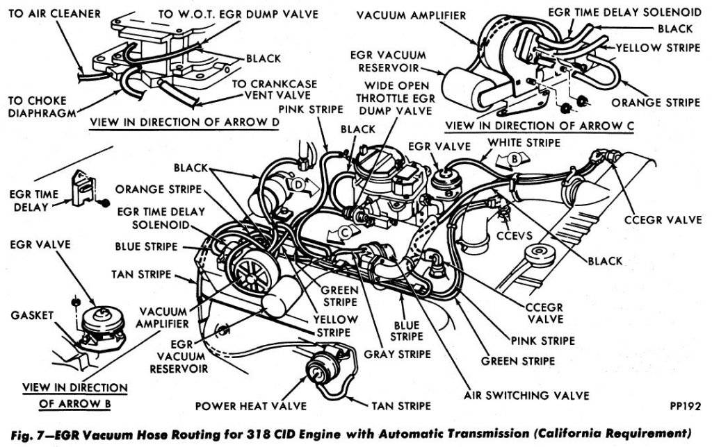

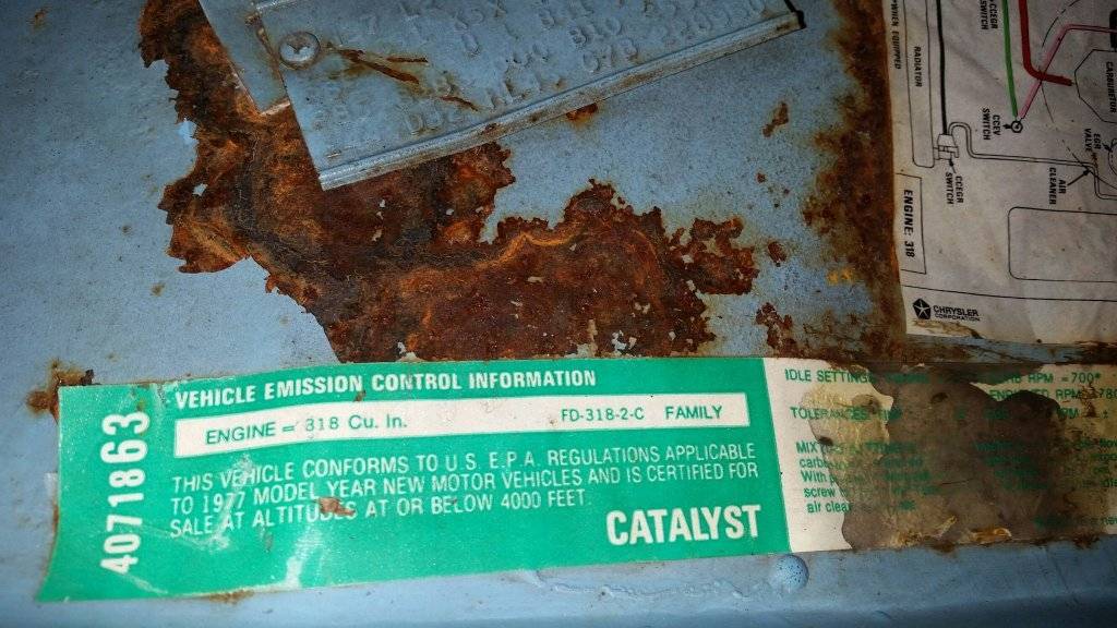

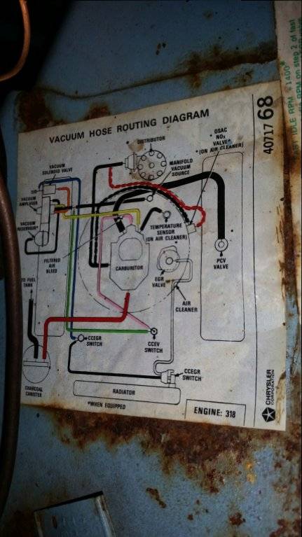

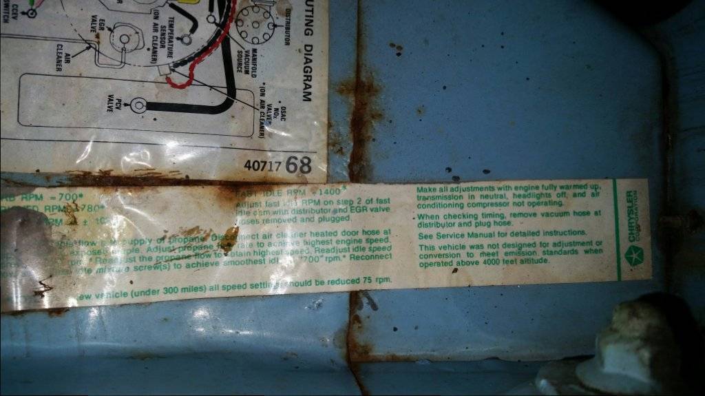

Pictures from my ’77 Volare 318 2-bbl Auto (Federal). Even with 38k garage kept miles, my stickers are almost ready to come off.

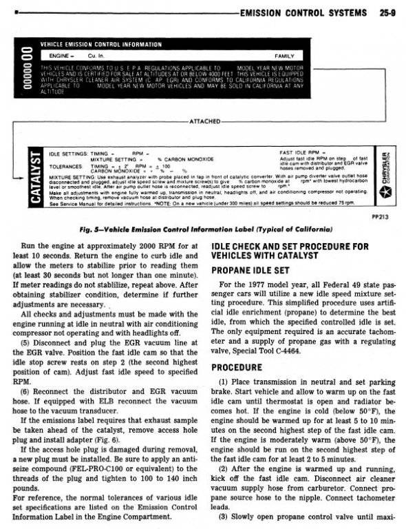

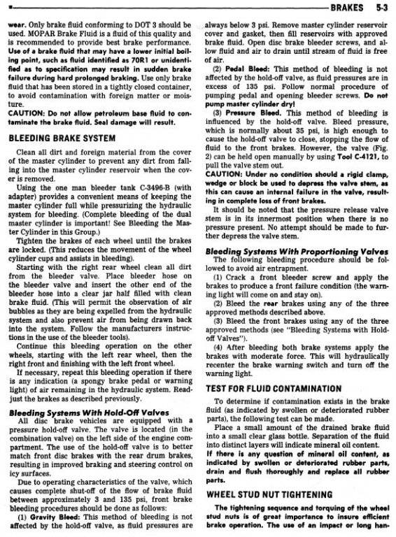

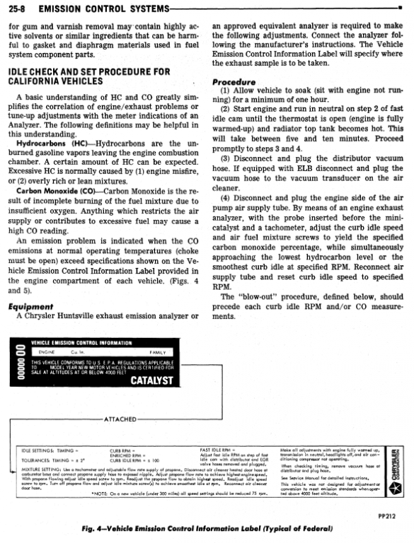

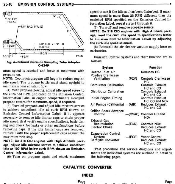

Pictures from my ’77 Chrysler Service Manual.
I think the propane method takes too long and doesn’t give any better results than using a vacuum gauge and tach, for these cars.
Not sure what to say about the brakes – but you are on the correct path.
