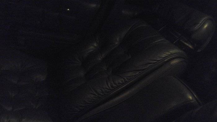

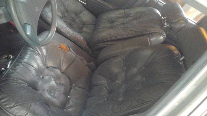

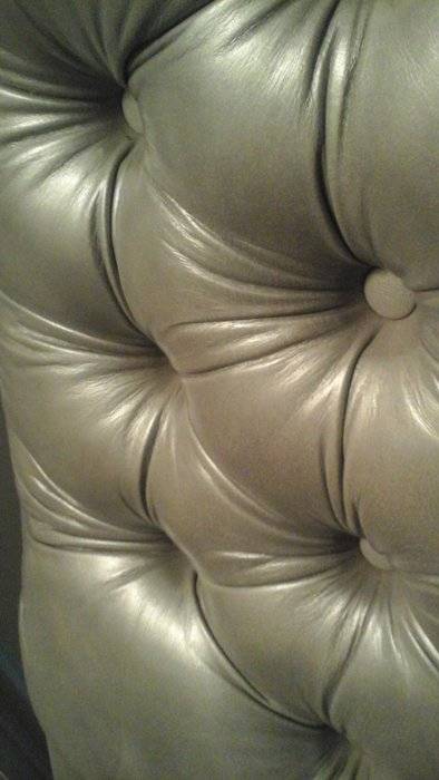

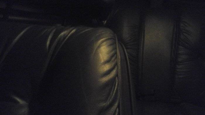

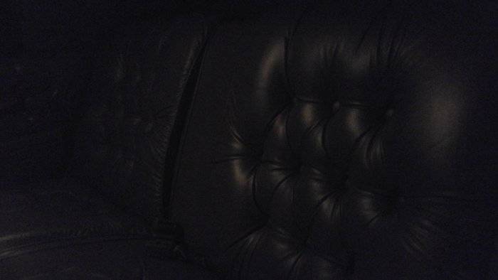

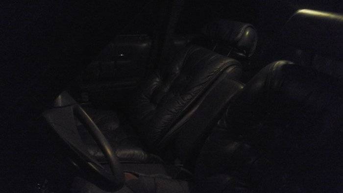

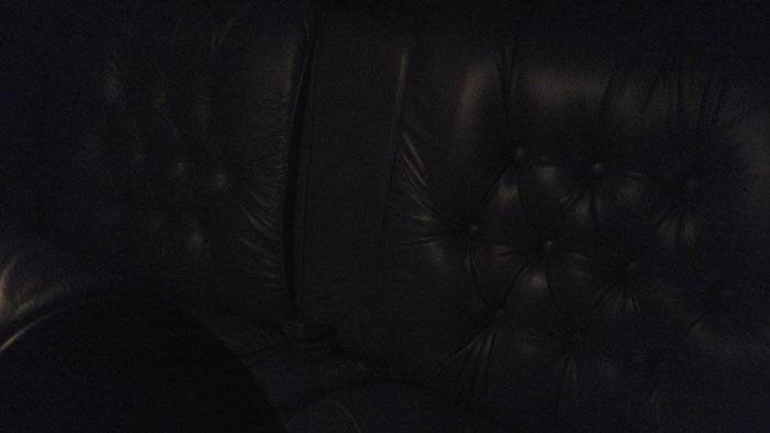

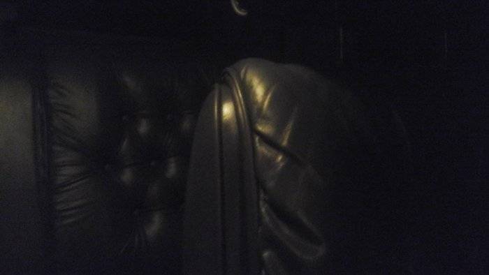

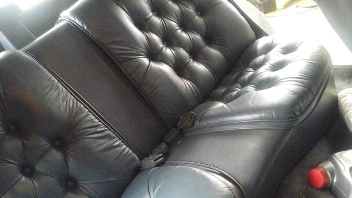

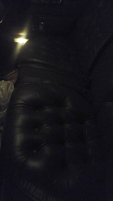

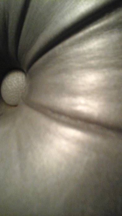

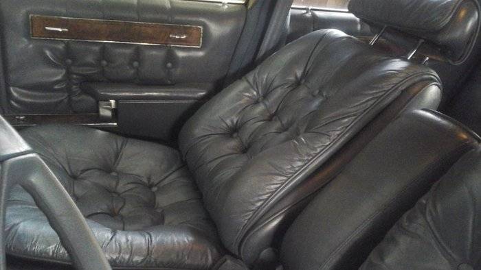

    I just sanded (1000 grit) down my leather seats (except for the drivers) and treated them to Leatherique's conditioner and cleaner. The top layer of dye is what usually gets hardened. Sand that down lightly and the leather gets nearly soft as new.
    After a good cleaning and soaking in the conditioner, I top coated the leather surfaces with Leatherique's pearlescent coating. I took some low light pics to show off the pearl-metallic look.
    The last pic is the driver's seat not yet done, you can see the leather is hardened and shiny with patina and lots of dirt. The next to the last picture is the passenger seat closeup where you can see how the sanded down and treated leather is softer, how it folds into smaller pleats. After some practice, I have had good results with Leatherique. I mastered the top-coat technique by diluting the pearl with 25% of their cleaner solution. This keeps it from getting too glossy and lets the pearl topcoat do the reflection of light. I see these are really low light level pics.

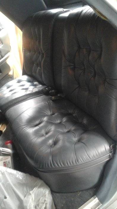

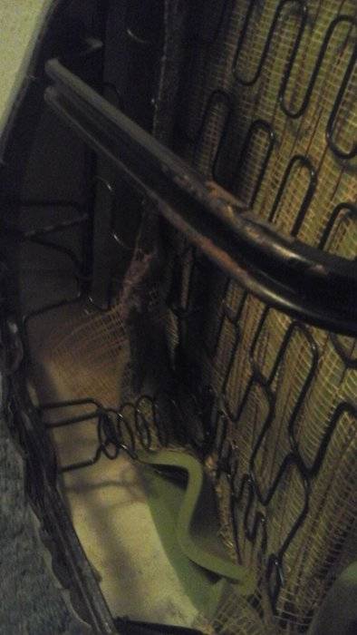

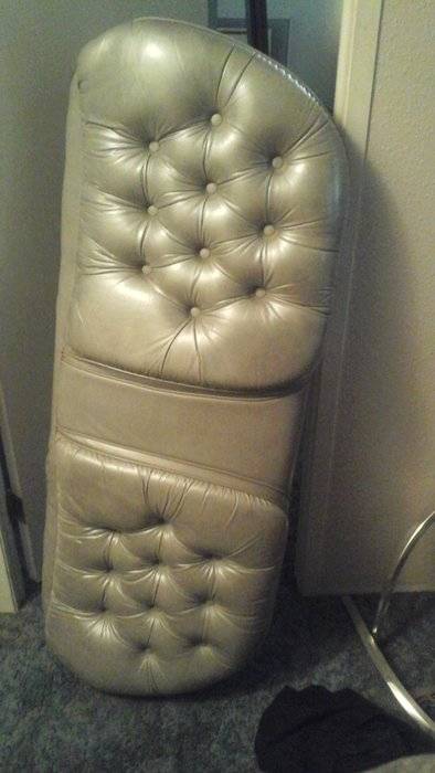

    In my Volare Premier wagon, I've installed a gray leather 5th Ave interior. I got the pearlized top-coat a little thickly applied and it has a definite polished gloss to it. I had this gray seat bottom out of the car so I thought I'd show off the steel springing in the seat frame. Try sitting in the back seat of a 2000 Buick Century. Its nothing but a slab of foam. You notice a sinking feeling in the first mile and then your butt is hard against the floor of the body of the car for the rest of the ride. Booo GM!
    Now in our fine Chrysler product here, note the wire springing in both coil and ladder-spring types, supporting the rider. The seat backrest offers a fair amount of back lumbar support as well. Durably built seats designed for long journey use, front and rear.
    Notice how much the rear seat bottom is cut inward at the ends so people can get their feet in and out easier in the 4 door rear seats, this is different from the square cut 2 door rear seat bottom that your Cordoba has. To adapt a 4dr rear seat bottom cover onto a 2dr rear seat bottom frame would require alterations.
    An alternative to that would be to find 2 rear seat seatback covers and adapt one for the square seat bottom. That would be easy-breezy. 20170829_092434.jpg 20170829_092452.jpg 20170829_092524.jpg 20170829_092549.jpg 20170829_092632.jpg 20170829_092650.jpg 20170829_092738.jpg 20170829_092815.jpg
