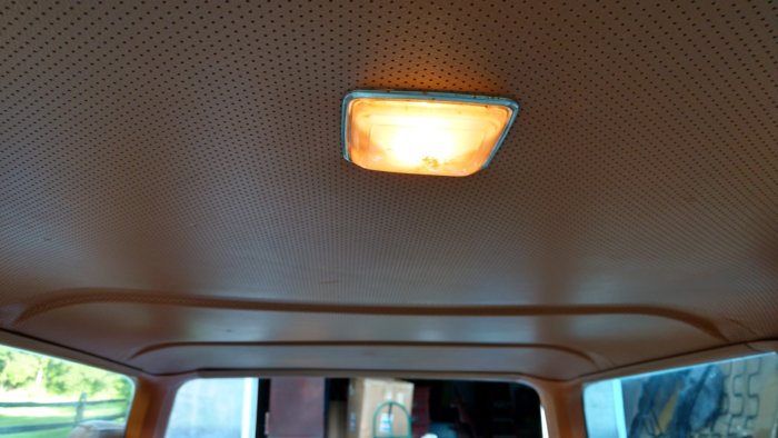

I'd like to be able to put the insulation above the headliner, but I don't want to even try to get that huge one piece chunk of cardboard out of there. I don't know where I would ever find another if it broke. OY doesn't have A/C anyway, so it would be hot no matter if it's there or not.

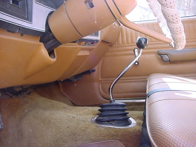

Whoo Hoo! Checked with UPS tracking, and my carpet is due to be delivered tomorrow! So, I guess I better get ready with some insulation and getting the bench seats out of OY. I want to fully clean EVERYTHING, so I expect this to take some time. I want to first use upholstery cleaner on the plaid 60/40 seats that are going back in, and on the plaid door panels. I'm hoping to find the build sheet under the carpet maybe. I also am hoping that the plaid 1977 passenger seat track will fit my 1978 car. We'll see about that too. I'm not sure if they changed the catalytic floor hump between those two years. If I am able to get out to Carlisle, I want to pick up a new shifter boot too as mine has a small tear. Looking forward to this - been waiting a LONG time, so I'm not going to hurry - I want to enjoy this and do it right.

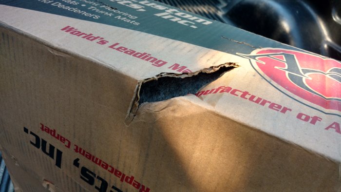

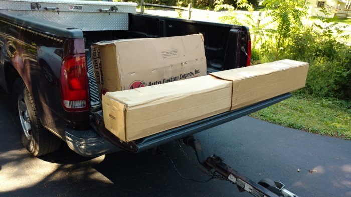

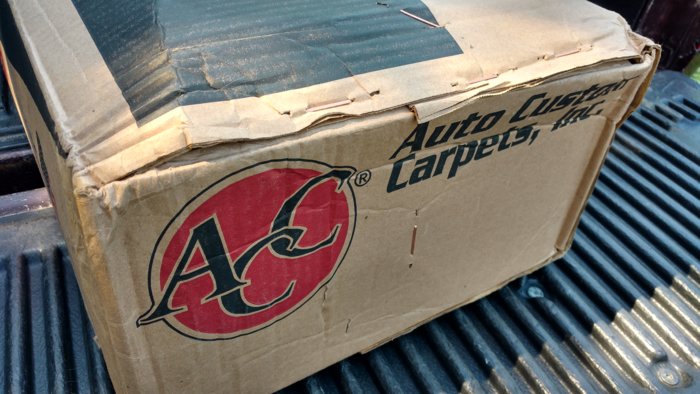

Carpet came yesterday. Boxes were pretty beat up with some holes ripped into them, likely courtesy of UPS.
Expected better for almost $80 shipping.
I wonder how they ever got them in there at the factory? The earlier ones were two piece, but I think in '78 and after, they were just one single huge piece of board.

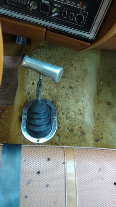

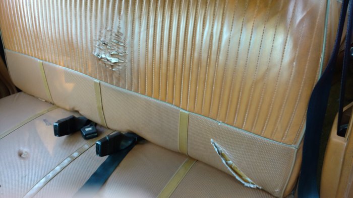

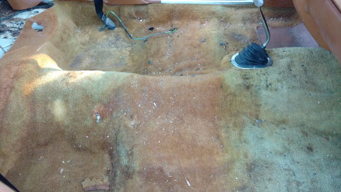

I unbolted the seat belts, removed the sill plates, kick panels, and removed the seats. Not difficult at all, and didn't take very long. Amazing the bench seat is only held in with four bolts with 1/2 inch nuts. That's it. The carpet was worse than I had thought. It wasn't very worn, but dry rotted in the rear, and tore just pulling it up. My previous half serious idea of trying to patch the cigarette burns and salvage the carpet was a bad idea. It was just completely shot.
The seat bottom and carpet was ruined by the original owner who had a love for cigarettes and bad ashtray aim.
The seat back was also ruined by the original owner, reportedly a rotund elderly woman, by rolling herself in and out of the car and using her elbow for support, jamming it in the middle of the seat back - causing the ripping. Thus, the need for new seats and new carpet.
