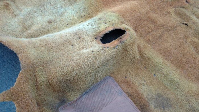

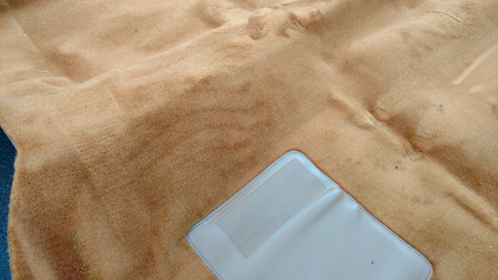

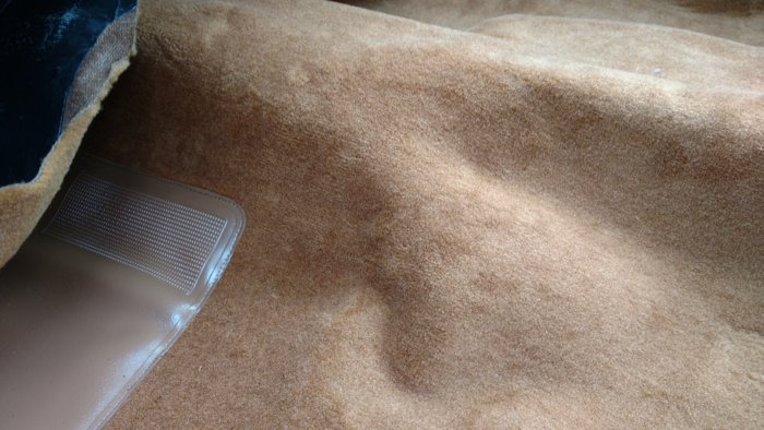

Stock Interiors has been very friendly and cooperative, and appear to be making good on the carpet problems, and will hopefully ship out a new carpet Monday. They said the one that I initially received appears to be for an automatic trans, instead of the four speed I specified. That explains the poor fit at the shifter when I put it in the car:
Note the difference between the two...
Original:
Replacement:

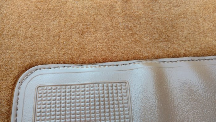

There was also a problem with the stitching of the heel pad... looks like somebody sneezed while sewing it.

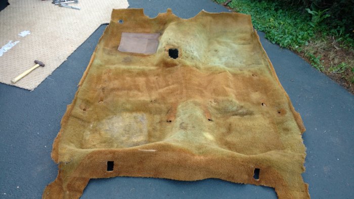

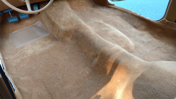

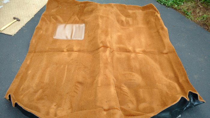

The two door carpet seems to be an exact fit for the four door floor pan except for an approximately 3 inch or so difference in length, the two door obviously being shorter wheelbase than the four door. You can see that the contours of the two door carpet at the rear are the same, just don't quite reach back far enough:
But, now there is another problem that I noticed. The carpet for the four door has the "dog ears" that wrap around and under the sides of the curved four door seat bottom. The two door carpet is cut straight across the rear because the two door rear seat bottom doesn't curve at the ends. Humm. So the dilemma is whether I try to piece in the "dog ears" on each side, or do I buy a whole new four door carpet to use for the rear of the car. Ugh, getting expensive.
Note the rear "dog ears" on the sides:
Straight cut across the rear of the two door carpet:
Well, I'll wait to get the correct four speed replacement carpet and make a decision after I can fit the front section in as it should fit.
I had noticed the dog ears on your first picture and had wondering about that.
Question, did you try to scoot the carpet back about three inches to see how that was going to work in the back-seat area?
I have a feeling the replacement carpet will be about the same – and now is the time to be worried about that (if it is a problem, that is).
Another question, are you going to use matching floor mats or go without?
You may be able to get a piece of carpet flat stock and make the "dog ears" and get a carpet outfit to seam them like house carpeting(?) If they do it right, it'd probably be all but unnoticable. Just an idea.
I did. And the "dog ears" will definitely be needed. Otherwise, it's a good fit.

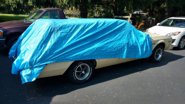

This may be of little interest...but to help preseve the interior on our Cordoba we bought a heavy canvas tarpaulin to cover the back and side windows. The tarp covers to the bottom of the glass on the side windows but only a foot down onto the windshield. The back of the car is always parked facing south. And the windows can be rolled down a bit while covered. It has helped keep the direct sun off of the interior stuff.

So, at least I have OY tarped up even it isn't back in it's rightful place in the garage yet. Thanks for the suggestion. I've been trying to keep up with everything and OY has been pushed down the list unfortunately, so nothing has been done all summer, except to have it sit OUTSIDE waiting for attention. It's basically been raining since the beginning of August, so I am hoping to get some nice fall weather and some actual time to finish putting the carpet and seats back in. When did life become so filled up with "gotta do's"? :(
FINALLY a weekend without rain, and I have some time to work on OY. It has been just sitting OUTSIDE since the beginning of August driving me crazy. I had put a tarp over it at Poly's suggestion above and this is how it looked waiting patiently for me:

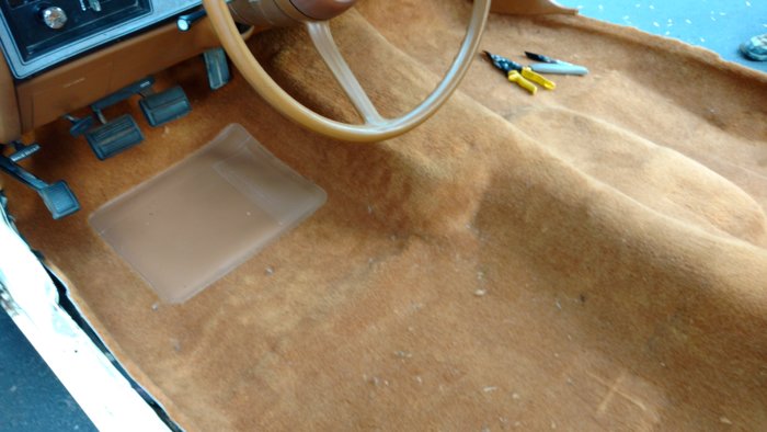

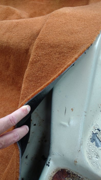

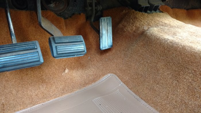

Next was the job of trimming the carpet to fit. What a job! I got the upgraded "mass backing" carpet which means that it has a coating of rubber like stuff on the back in addition to the felt, to make it quieter. It also makes it very difficult to manipulate and fold, so trying to get it in position and also under the pedals was not easy at all. I originally planned to use the old carpet as a pattern laid on top of the new carpet, but decided that was too risky. So, I started by locating the four speed floor hump as perfectly with the hump in the molded carpet as possible and then used heavy shears to trim away the extra around the edges. It was a job and a half, particularly up under the dash where you have to cut around the steering column and heater ducts! I bent and contorted myself into positions I didn't know I was able to. Ibuprofin to the rescue. But, it seems to have come out pretty well, and I left a little more carpet than was there originally.

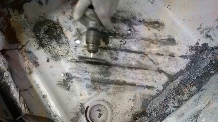

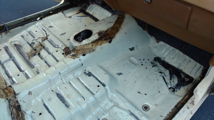

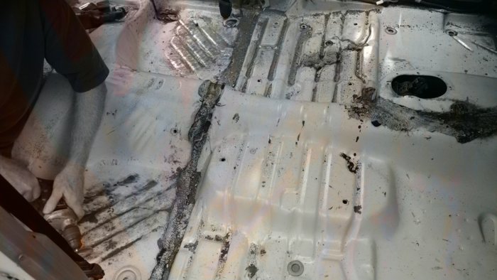

Next, it was time to address the minor surface rust in some spots on the floor pans, so out came the carpet again for that job. I used an electric drill with metal brush head which cleaned up the floors very nicely. The floors were very lightly painted originally, and the little channels in the floor pan seemed to have had been painted with debris in them or something, because the paint just flaked up very easily. I wire brushed the entire floor and eliminated every trace of rust.

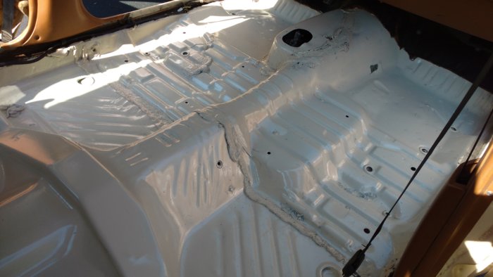

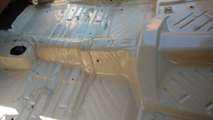

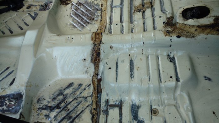

So, with the floors all wire brushed, thoroughly vacuumed and then washed down with paint thinner, I decided to use Rustoleum enamel to paint and seal the floors. I bought a fresh quart of "Rustoleum Gloss Almond" and was amazed at how close of a match it is to the original Mopar "Classic Cream" paint! It is SO close in color, that I actually went around and also used it to touch up a few nicks and spots on the body! Here's how the floors turned out:
I'm really pleased with the results and feel that the floors are well protected now - better than new for sure, and although they will never be seen, I like that the color matches so well.

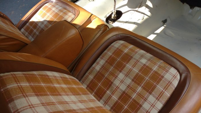

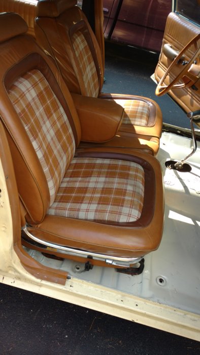

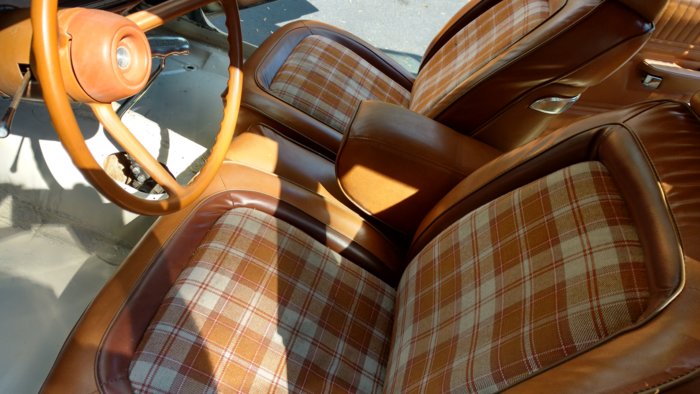

So, until I can order the additional 4 door automatic carpet from Stock Interiors, I decided to put the 60/40 seats in without the carpet, and reattach the shifter so at least I can start OY and move it around. I was pleased to find that the seats fit perfectly! It's getting there.
I can see the plaid as a love it or hate it kind of thing that can go on you or not.
I like it and I think it will jazz up your wagon.
