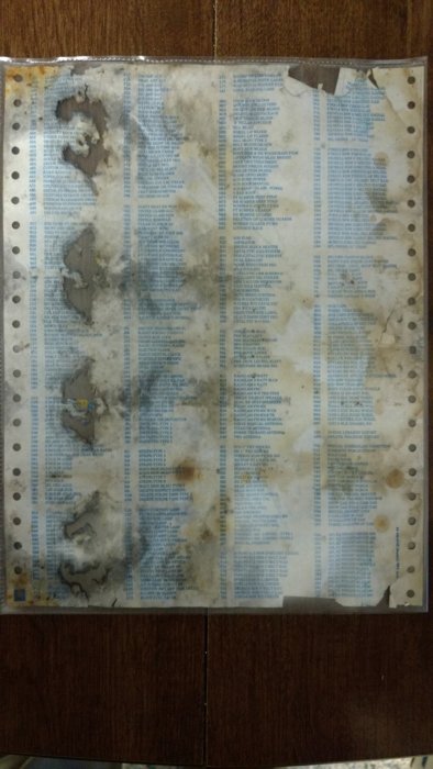

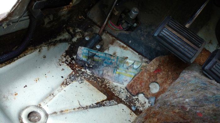

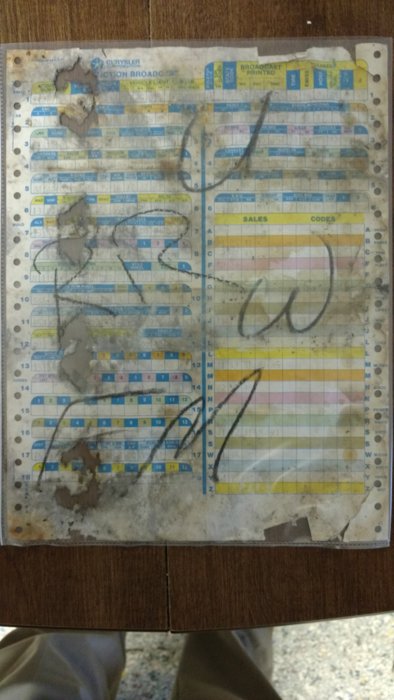

A nice surprise! I found OY's build sheet! It was in the worst place possible, folded up right underneath the carpet where the driver would rest their left foot. It is not in perfect shape, but I was able to salvage it and most of it is legible. I did find out that OY was built on March 15th of '78. The date on the door sticker is weathered right where the build date is supposed to be, so now I finally know when it was built.
I
I managed to straighten the build sheet out, carefully clean it up and put it in a transparent sleeve so most of it is readable. I found out a few other things such as OY originally had a locking gas cap (J46) from the factory. I wonder what happened to it. It also had factory floor mats (C92) and was delivered with five gallons of gas (Y95). The AM/CB transceiver (R12) and power tri-band antenna (R47) are also factory original. It was built already "sold" (Y14) apparently. I wonder if it was specifically ordered by the original elderly woman owner. I also know from original sales paperwork that I received when I bought it, that it was sold new at Bill Berry Motors, in Canon City, Colorado.

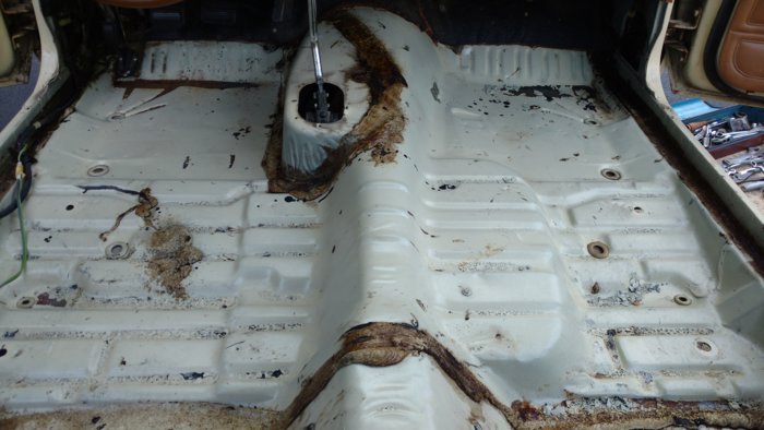

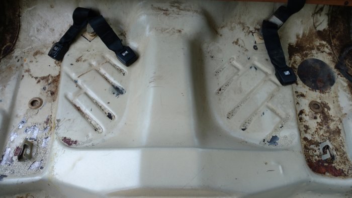

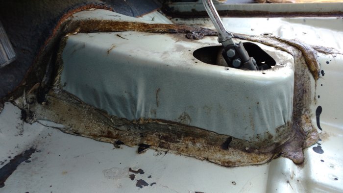

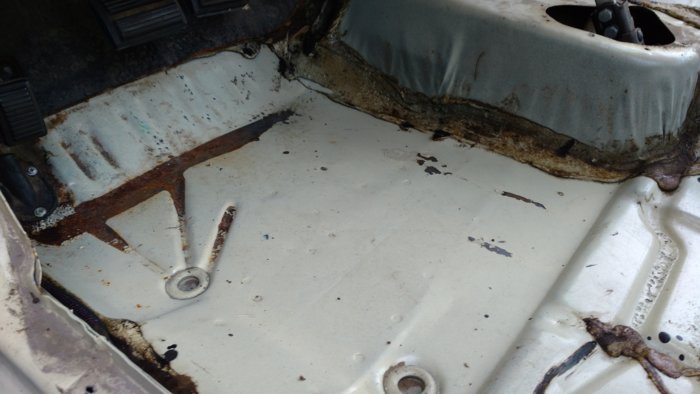

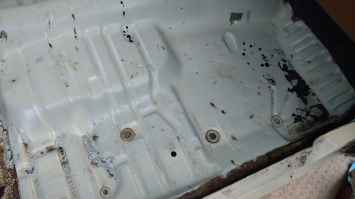

An even nicer surprise than finding the build sheet, is seeing the condition of the floor pans! They are in really great shape with only a little surface rust on the rear pans. Until I bought it in 2012 and drove it back to Pennsylvania, OY spent all of it's life in the high desert area of Pueblo Colorado and Farmington New Mexico, and it shows. Not bad for a 40 year old F body! :)
The front drivers side:
Front passenger side:
Rear drivers side:

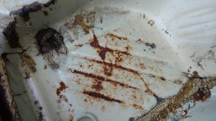

Rear passenger side: This is the worst area, but still only just surface rust. I'm going to wirebrush any rust and paint it with rust inhibitor. There are also some areas that amazingly are still shiny metal where bits of the paint came off from vacuuming.
Under the rear seat:
For being 40-years old – your floorpan looks perfect!

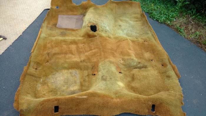

One, can you take a picture of your two carpets side by side, please?
Second, would you mind scanning your build sheet (front and back) – for I would really love to get my hands on one (any one) from that time frame, please?
Thanks BudW. I was really excited and pleased to find the build sheet and also with the condition of the floors. I had thought others on the forum would be interested too...
Sure, I have the one out of the Black '77 Volare Oklahoma parts car too which is in better shape. I'll see if I can scan them.

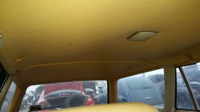

I need to remove my 1-piece headliner from car to fix a roof rain water leak (I “think” someone missed a roof rack screw and made a new hole when car was built – but not sure exactly).
The factory has a tool used so 1-person can install the complete dash as an assembly (not so much on FMJ vehicles), for installing bench seats and for our super long headliners. A similar tool is also used for installing windshields and other long sections of glass. I looked online for photos – but couldn’t find one. on Wagons (and cars) they go in from front or rear). On cars, the glass gets installed after headliner.
The earlier ones were two piece, but I think in '78 and after, they were just one single huge piece of board
I don't think I've ever paid any attention to this aspect before.

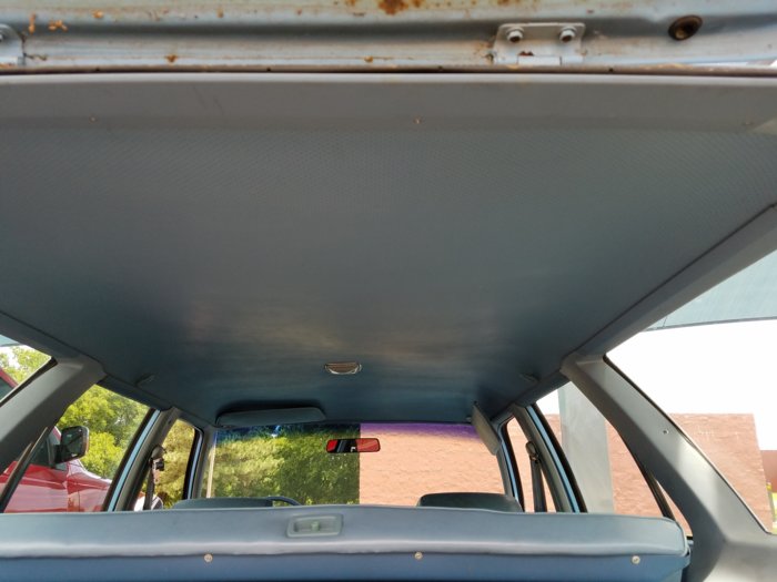

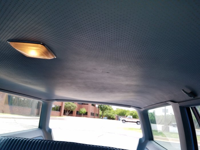

All I can do is provide pictures of my '77 - which a production date of 11-1976 - which has a 1-piece headliner.
Thanks for the carpet pictures.
I was thinking there was a major color difference – but come to find out, I just needed to clean my glasses . . .
I need to change carpet(s) in my car as well – but wanted to do that closer to the 5 or 6-speed manual install.

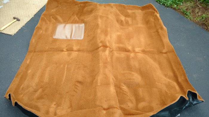

No, the color is a very good match to the original. It is called "Nutmeg" and is number "8296". Now I have some figuring to do to make this work for a 4 speed wagon. I also have a few issues with the carpet itself, and I am not sure yet what I am going to about it.

I notice from your pics that your '77 has the loop carpet, and my '78 has the "cut pile" short shag. Stock Interiors sells both, but doesn't list the loop carpet for the F's, so you might have to go with the "cut pile" shag type carpet. The one that seems to match yours most closely I think would be number "8643" "Powder Blue". I sent for their free samples before I made my decision.
I’m glad someone else noticed that.
Loop carpet doesn’t seam to be correct for what I’ve read – but that is what was installed in my car.

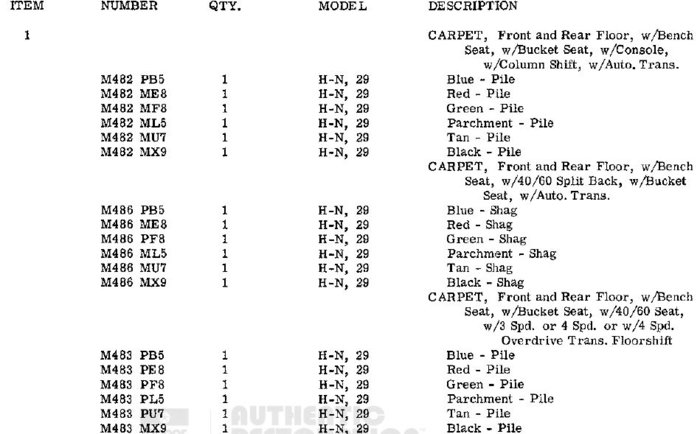

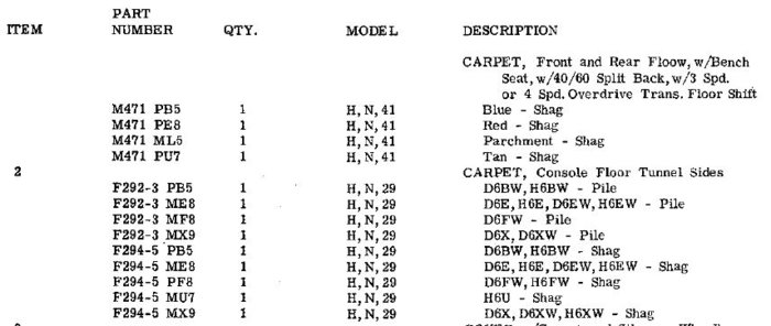

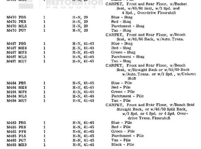

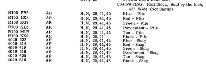

The ’76 parts manual gives the same options as my ’77 parts manual shows (but different part numbers).
My ’77 parts manual shows:
I see "Pile" and "Shag", but no "Loop" mentioned.
I think the term "pile" might mean what we are calling loop, and the "shag" might mean the cut pile. What I ordered from Stock Interiors was the "plush cut pile" as the carpet for F's doesn't come in the Ultra Plush or Neon, not that I would want them anyway.
Wow, this is weird. Now there is at least three different variations of the headliner in wagons. Yours is indeed the long uninterrupted one piece. I've also seen ones that are two piece, with a metal support trim piece about an inch or two wide covering the seam. I'm not sure anymore if that is on older or newer wagons. Then, there is the one piece with molded ridges, presumably for support going across the middle, which is the type in OY below:
Just a thought... I wonder if the two piece headliners might have been used in the upgraded interiors that have the second overhead rear cargo light? Anyone out there have one to confirm?

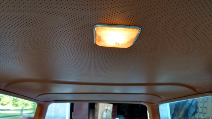

I found a headliner in this car https://www.forfmjbodiesonly.com/classicmopar/threads/80-aspen-wagon.5163/#post-56800 a couple of years ago – but car got crushed before I could extract it. The other problem I would have had is finding a way to transport it without damage, if I had removed it.
This headliner has two ribs and is a 1-piece design – but that was two years ago (so can’t remember exactly). This had two dome lamps and rear section was torn/ripped and sagging bad.
My plan was to use this one to replace the headliner in my ’86 Fifth Ave (which is still missing its headliner . . .).
Other items I wanted from this car was the chrome bullet remote mirrors and the tailgate (with deflector and wiper). Someone else grabbed the mirrors, cutting the cables and ruining both doors in the process.
