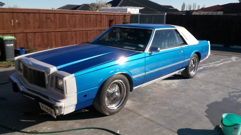

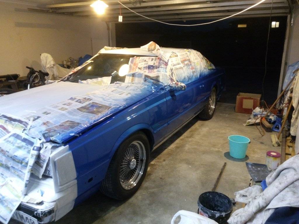

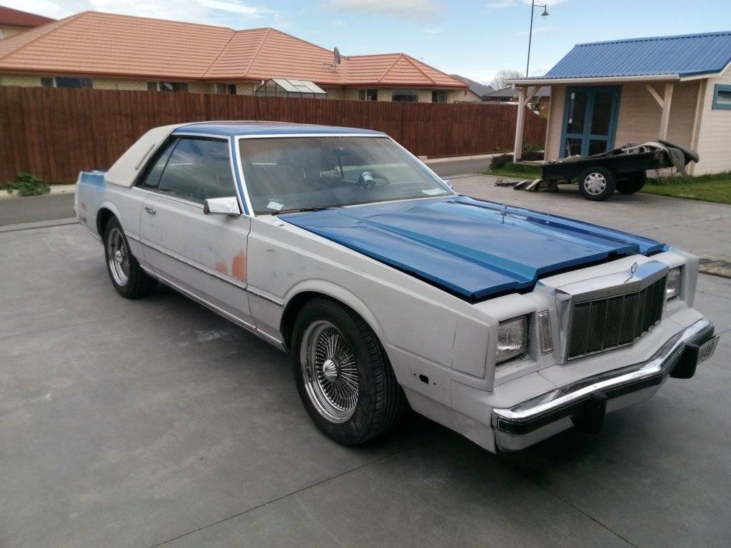

Doba is in Primer
Here is the color code here
Color is much nicer than 1970s glacier blue, its like a subaru imprezza blue but not as bright. It looks about half as bright but gives deeper look if that helps.

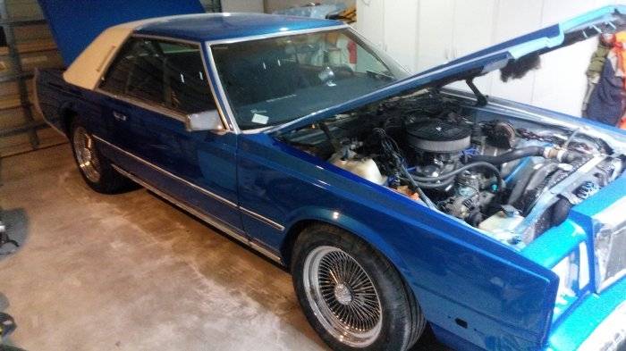

Thanks, hope you guys like the progress pics, done a lot of work to this car and once its painted its finished! My friend said its been not to bad to do, zero rust, just a dozen dents one big rest like shopping trolley dings! Just amazing how paint changes the car!!!

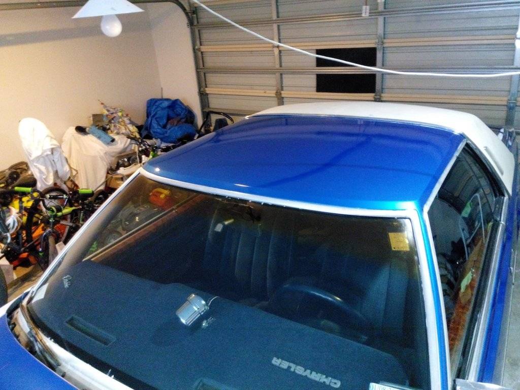

The camera doesn't really show color well its more deeper, camera shows it light in the sun, photos in garage more like it looks like, I am only using my mobile phone to take photos.
