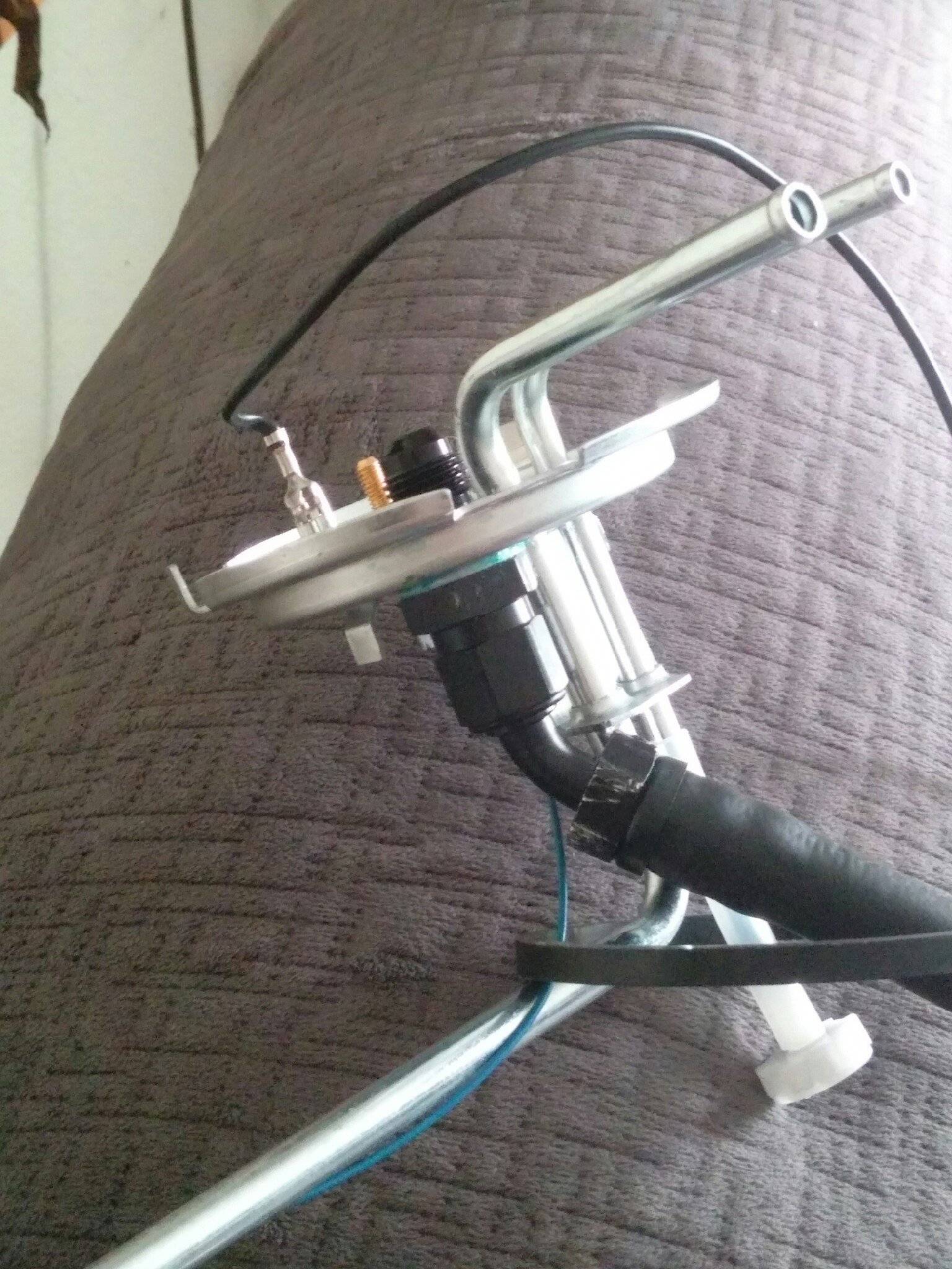

The new sender with the return line fitting installed.

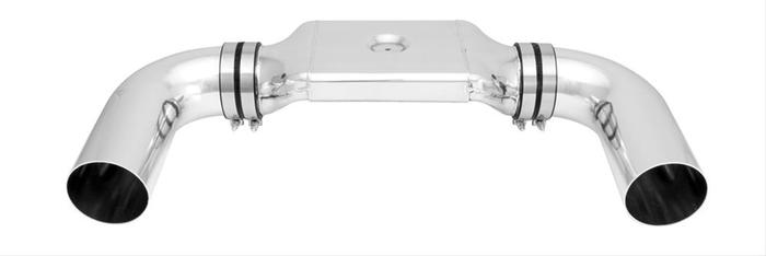

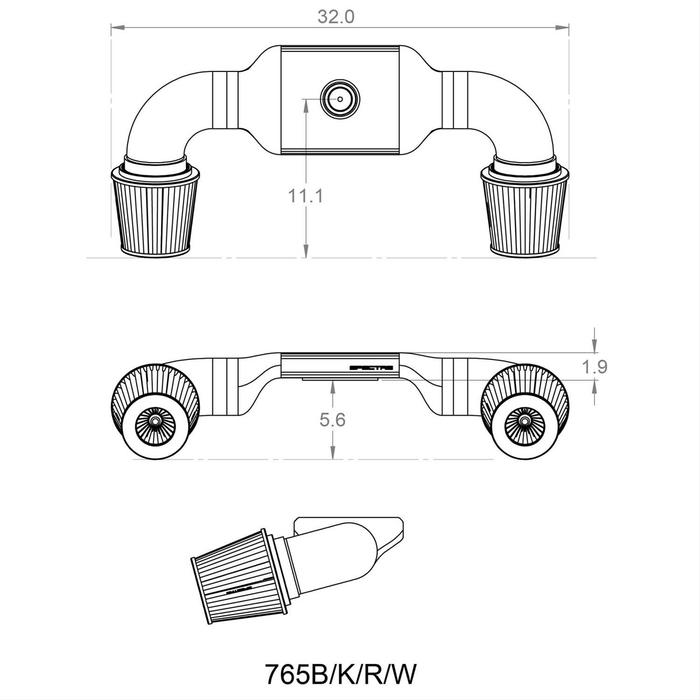

looking for a low profile air cleaner and ran across this. It takes two cone filters. I haven't decided whether it looks goofy or not yet. Thoughts?
