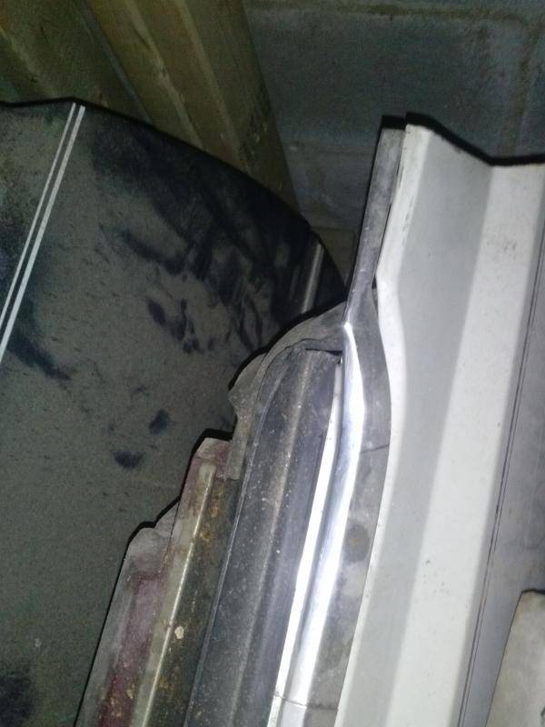

Scored a passenger remote mirror. However, I don't understand how it goes in the door. The top door seal/strip seems to be one long piece. Anyone have a good pic with a passenger mirror affixed and how interacts with the top door seal?
There's a long metal bracket that goes down into the door and attaches it. Do you have that? It's obviously not on the door now, because it would be sticking out in the picture. If you don't have one of those, you'll have to get one, or make something to replace it.
Where did you find the mirror? Salvage yard or something? Any chance there was another one? :)
There are two different chrome mouldings , one solid for cars without a pass side mirror and one slotted for use with a mirror. My pic is taken from the bottom and the slot is on the top of the chrome.
Aha, so there were Miradas or Cordobas sold without passenger's side mirrors? If so, that might also solve my no mirror issue. I thought by that point (1983) they were required equipment? No?
If you took off the door panel on the driver's side, you would see the bracket that goes in there to hold the mirror on.

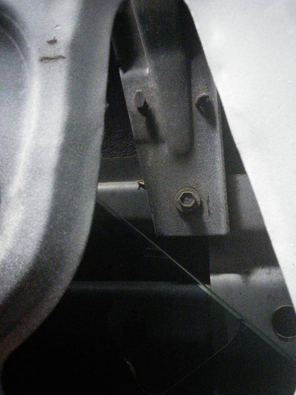

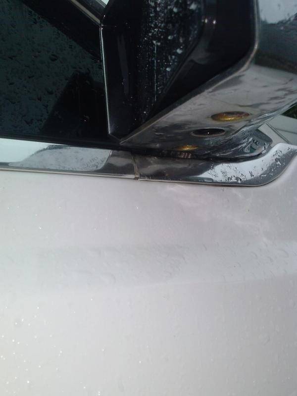

And from the better-late-than-never department, here are the pics of the mirror bracket.
The first pic is of my broken passenger's side mirror. I hope you can see that center metal part that sticks out for the plastic mirror to bolt to.
The second pic is of the bottom of the bracket inside the door. It goes down into the door about a foot (maybe more). It's not a small bracket. This pic is of my driver's side one, because I can't open my pass side door right now, but it's the same, just reversed.
I hope this helps. I imagine a bracket could be made if you didn't have a factory one.

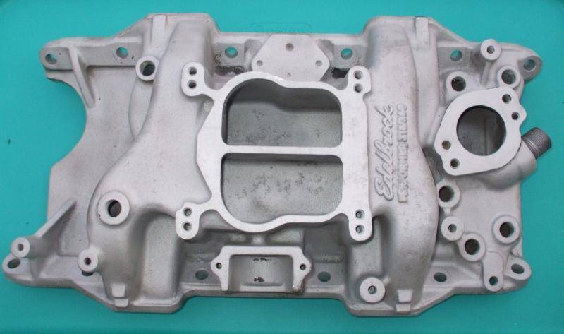

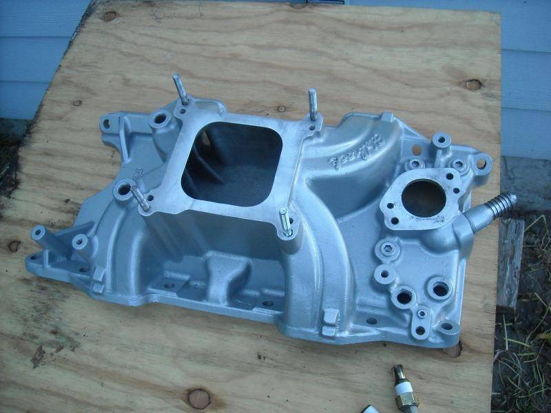

I wonder if there is enough meat on the torker to grind out for the secondaries.
