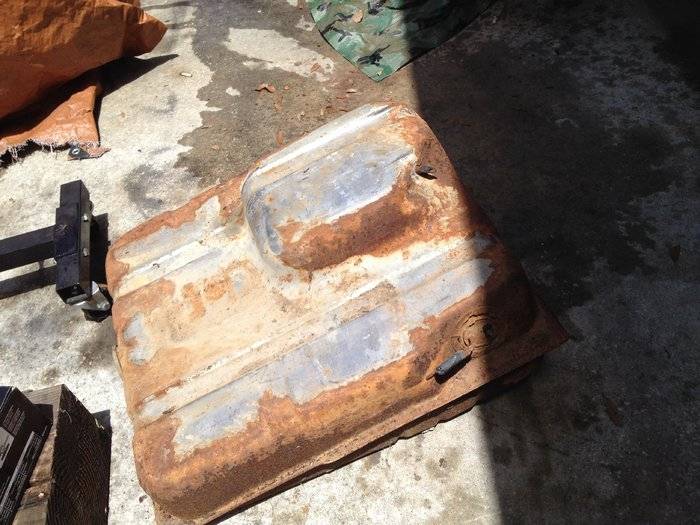

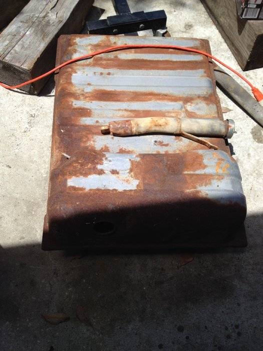

Have 2 gas tanks from the early 76/77 cars, not sure which goes where yet. This is the first one.

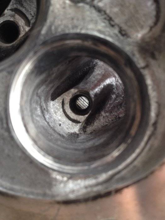

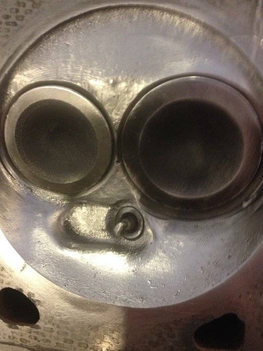

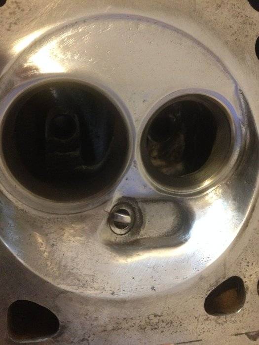

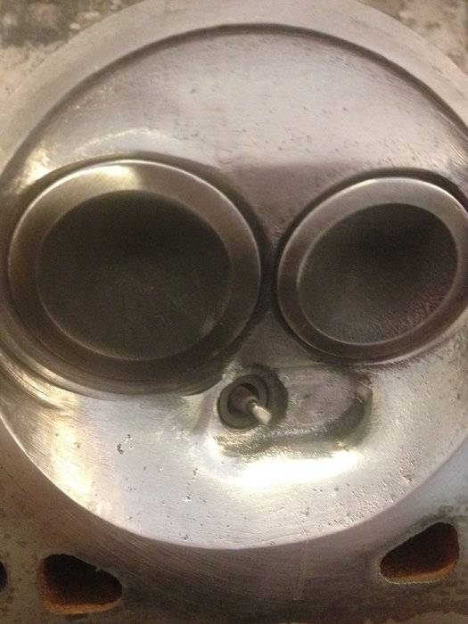

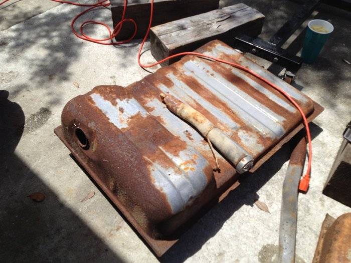

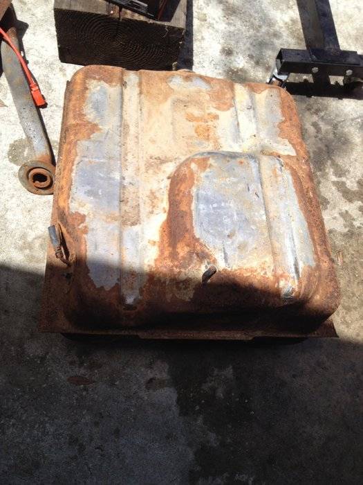

45 minutes straight on the second tank in the Georgia sun, it has a dozen holes in it, but no big concerns yet. The wire wheel has porcupined my pants. I do love this though, it's been too long.

Shiny!

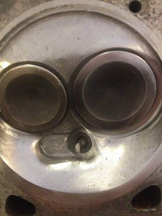

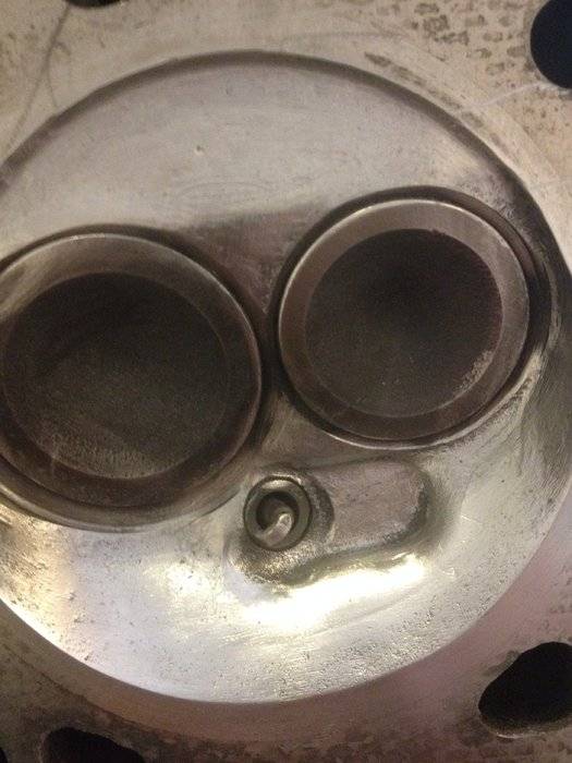

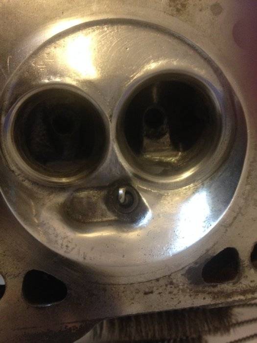

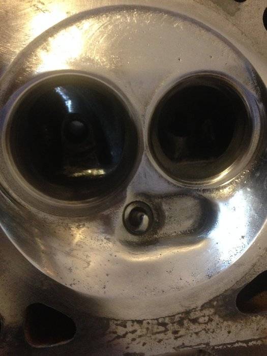

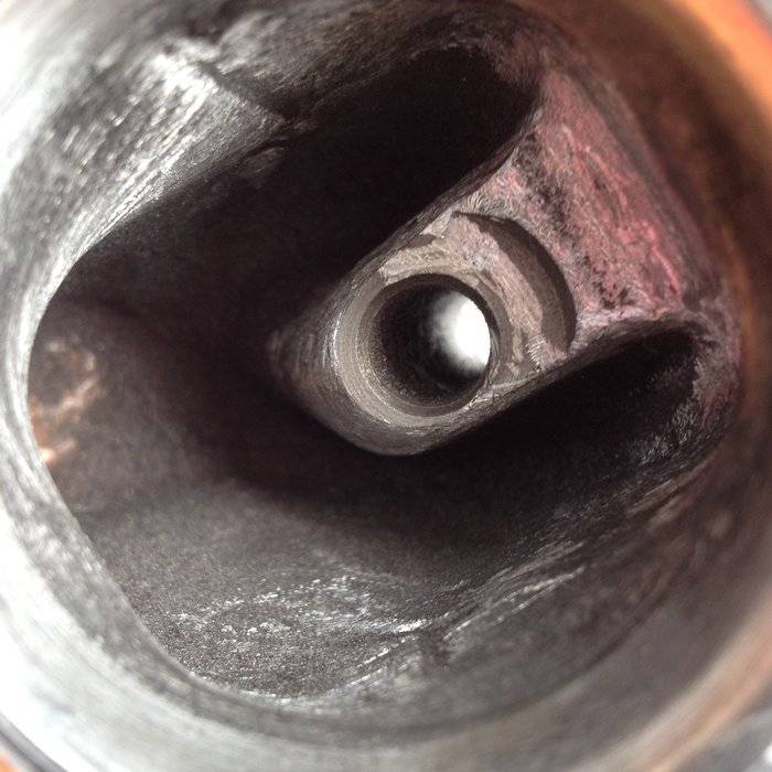

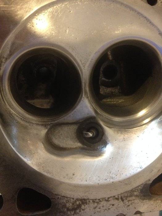

318 or 360?
In the combustion chamber, did you use a sanding wheel/drum or a grinding wheel?
Did you lap the valves/seats in, or get them ground?
greymouser7
Mar 11, 2011
1,079
90
31547 off of I-95 near I-10
Shiny!
318 or 360?
These are '596 heads: 318 & 360 during the late 70's & early 80's i believe.
The guy (Richard Mowry) that helped me during this build took my dewalt & other drills, W2's, tools, 1970 360 block, (when he left) & so much more-so I had to get a black & decker drill, Walmart wire wheels for it, and harbor freight sand paper rolls+ allot of hand sanding.
I am going to lap the valves almost last. After that leak test them, & then CC them.
They measured 65.5-66CC's prior to working on them.
They had shrouding reliefs cut into them prior to receiving them.
They cost me $400 assembled, supposedly ready to bolt on.
I have 1.6 roller rockers for the 365" and a mild Crane 693901 camshaft for this build.
It is temporary until I get my 367 fromDvorak machine.
1,492
’596 Cylinder heads fit ’77-86 360’s.
They do have larger valves and ports than a 318 has.
The 360 (2-bbl) did not come out until ’71 (in C-bodies). Unless you have an early one cast in 1970, it is not worth anything more than any other 360 block – but I don’t think I have seen a 1970 cast 360, before (and I have seen thousands of 360’s).

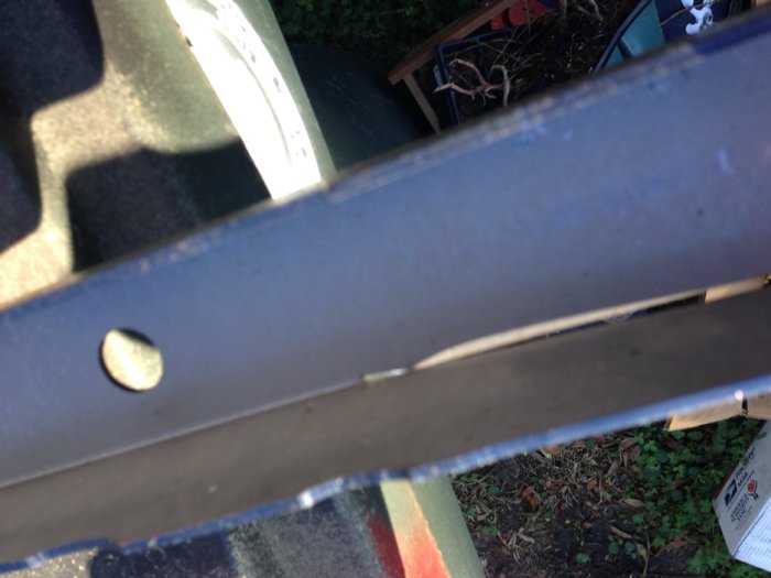

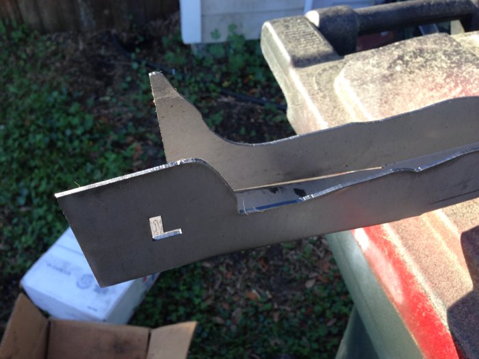

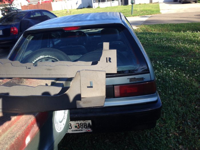

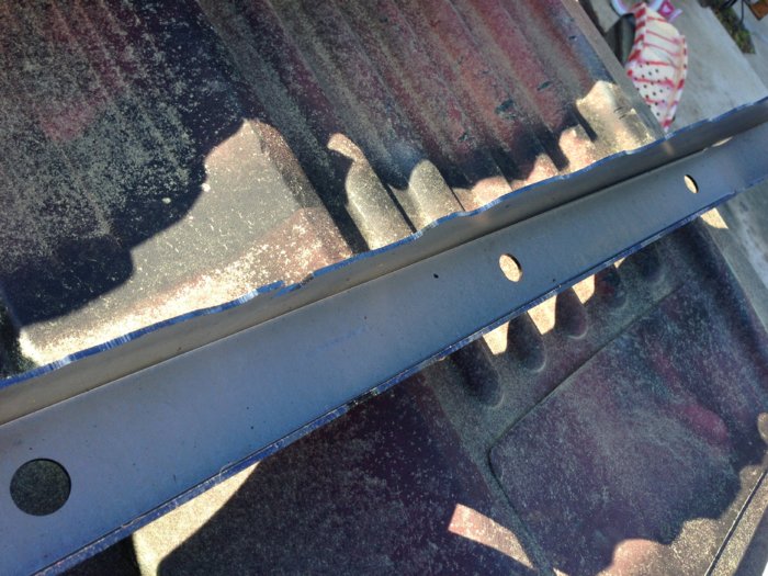

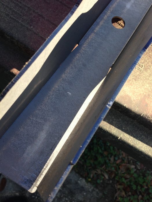

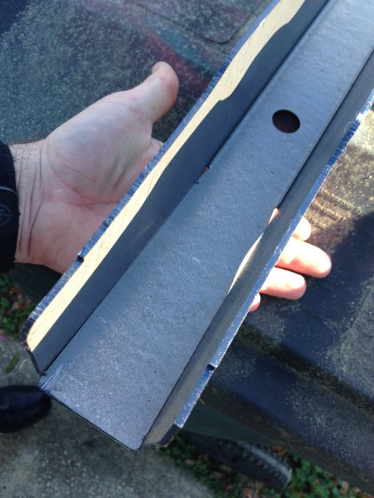

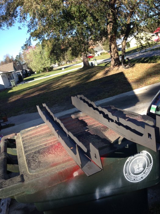

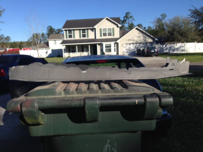

I have returned from my 19th deployment. 19 years of service as well. I bought some floor pan-fit sub-frame connectors, 1.6" exhaust valves, Tac-rags, wax&grease remover, and some small block engine parts. More pics to follow when I can tear myself from work. We are working many hours on board the USS Tennessee (just finished a 3 month patrol). I am taking the axle and transmission in to get rebuilt. I might load up the engine block to the machine shop within the next week as well. I went down the night before deployment and set everything straight with Dvorak-can't say that I am very happy, but I will have a built 360 within a year that will be plenty of fun and danger. I plan on driving this car on the Hotrod Power Tour (not this year) after I retire from the Navy.

Nice frame connectors, thanks for the pics! That 2nd gas tank, is that for an F body? I have not seen one like that and the sending unit is in a strange spot. Perhaps I have just never seen that style but I have only ever seen a hump tank for a early 76/77 F that looks like the pic of your 1st tank.
