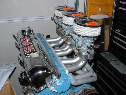

theres nothing wrong with the 225 engine, except it is not supported by the after market here. at it's heart it is a V 12 engine, with 6 of the cylenders cut off.
thus. it has the capability of taking a lot of abuse, and creating a lot of "comparable" power.
that is why theres a HUGE racing aftermarket for the 225 in australia.
but it is more cost effective to swap to a V-8 here in the states.
them folks down under are nuts about the 225

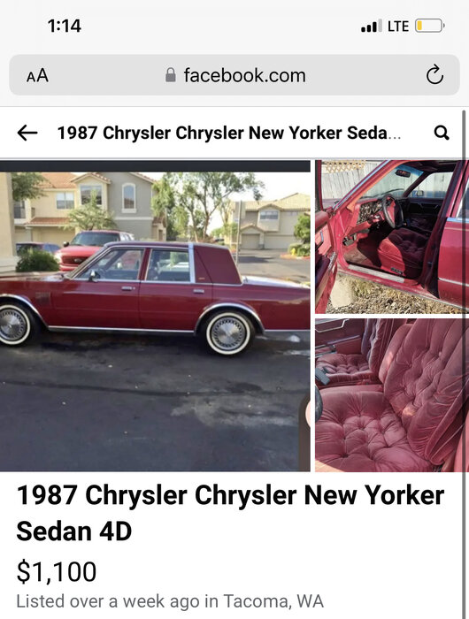

There’s a pretty solid Fifth avenue in Tacoma, Wa if you wanna make the trek. Guy wants $1k for it.
Would get you the k-frame and mounts, a 904 3 speed trans and solid parts to sell to make some cash back.

Swap drivetrains between cars and give the, now slant6, 5th Ave to your sister, lol. Everyone wins.
yah,LOL but that wont work, my sister would defiantly not let me strip it for parts,it is too nice, I need to find something beat up that still runs good,I;m checking wrecking yards for a salvage doner
except I'll still have to pay to get the six running. might still be worth it , if I could find a way to drive 1 car up, and 2 cars back. ;-) , it is about a 600 mile round trip.
