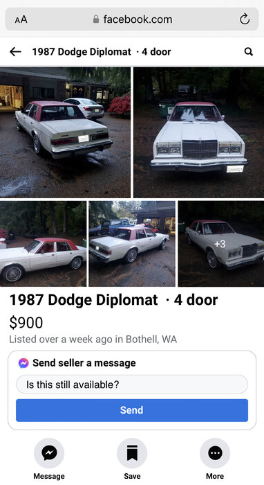

Here’s a diplomat in Bothell, Wa. $900 running driving car, gets you the k frame, v8 and transmission maybe even the heavy duty variant of the 904 if you’re lucky…not as pretty as the 5th Ave either, lol
im in springfield oregon
it was almost 400 miles round trip to get the duster from sandy,. which is just east of portland.
Oh I know, I can see your location. Those are just a couple of the only FMJ cars I can find in the, PNW that aren’t $3k+; and even those cars aren’t any closer to you either.
