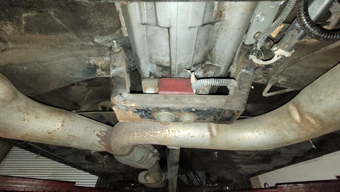

The 518 fit with no floor pan modifications, but a custom crossmember and under car adjustments were needed. This has been detailed by others on the forum.
How did you elect to do your cross member? I used box tube, but I've seen others use rolled flat stock.
Transmission crossmember was made of rectangular tubing and connected to the factory bolt holes.
Floorpan stiffer was replaced with curved flat bar. A non mopar trans mount was used. See pics.
I thought people doing this in the past usually modified the floor a bit or else the transmission was angled a bit lower then with 727/904?
how does this effect ground clearance, like for speed bumps and such?? this info is kinda beyond my scope... but others may find your work arounds and fixes to make it work helpful.
and I still find the enginuity interesting
It doesn't. The skid plate on the engine cradle is the lowest portion of the car. You would have to do something really screwballs for this swap to change ground clearance.
