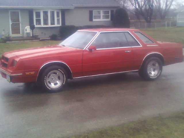

thumbnail
Image is broke. Appears to be hosted on a secured email server. Try copy pasting the image so the board saves it as an attachment instead.
Yup. Polished slot mags. A good 70s look but you should probably pull at least an inch of ride height out if you can.
