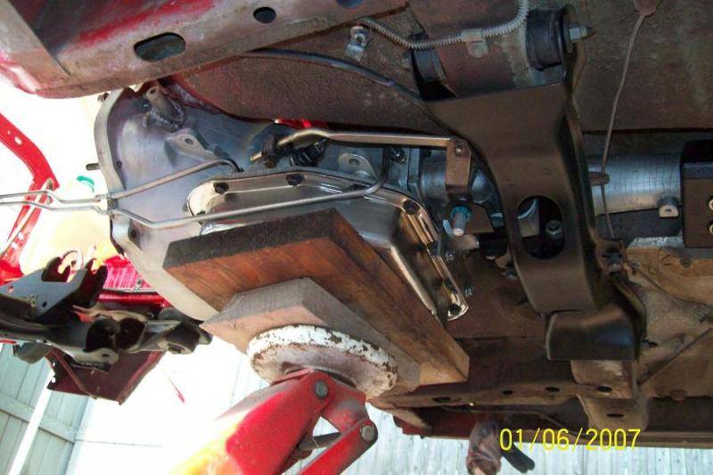

Tranny pic.

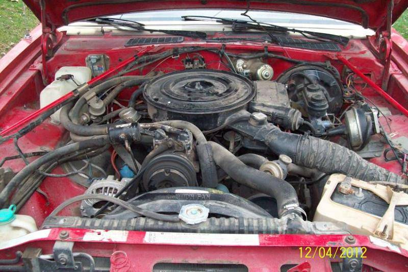

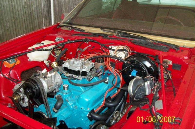

Well, the boys and I were busy after church today! A little before and after. Probably won't start it for another week or two. I need to get a gas tank grommet and some other odds and ends. The date on the pic is wrong..... changed batteries and forgot to set the time.

.... a built 904, cheetah valve body,and a 2000-2200 stall converter. Got it installed tonight. Might drop engine in tomorrow .....
JasperJacko:
I may be putting my Mopar ignorance on public display here, but if I don't ask, I won't learn. Your first post is about uinstalling a 360 enigne, and now you are installing a built A904 tranny. I thought the 360 only had a bolt pattern for the small block version of the A727. Is an A904 capable of reliable operation with a 360? What is the torque capacity of the A904, long term?
I am asking because I am trying to make plans for my Mirada, and if I can get away with teaming a 360 with an A904 (actually, an A999), I will rethink my plans to put a mild big block in.

You can run a 904 with a 360, a lot of drag racers run the 904's actually. They will hold a loooot of power, they have lower gear ratios and it takes less to spin em lol. You do have to make sure you run the proper converter though as a 360 is externally balanced.

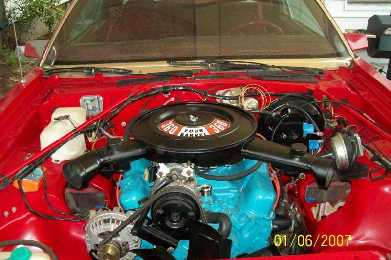

the headers were used. I had them blasted and hi-temp powder coated. look like a typical a-body header with the drag link through the header(pain). clearance is good everywhere except pass. inner fender. will probably burn the paint off if I can't tweak the tube. I didn't want to spend 7-800 $$ on a nice set....maybe later.

Is the Edelbrock intake a performer 3776. Did the air conditioning compressor bolt up with out any mods, I heard on one of these forums that the Edelbrock is the only after market intake that has the offset thermostat housing and such that allows it to bolt up like factory. Everything your doing is exactly what I want to do, thanks for sharing.

It's the standard performer, not the rpm. The rpm doesn't have the right heater hose location for the a\c compressor. Also, I had to grind some of the manifold heater hose boss to fit the a\c bracket....it was interfering and wouldn't let the compressor sit straight.

It's AALLIIIIIIIVVVE!!!!!!!!! When I figure out how to post a video, I'll put one up with sound!!! Fired it up at 9:30 pm with open headers...... hope the neighbors didn't fall off the couch!!

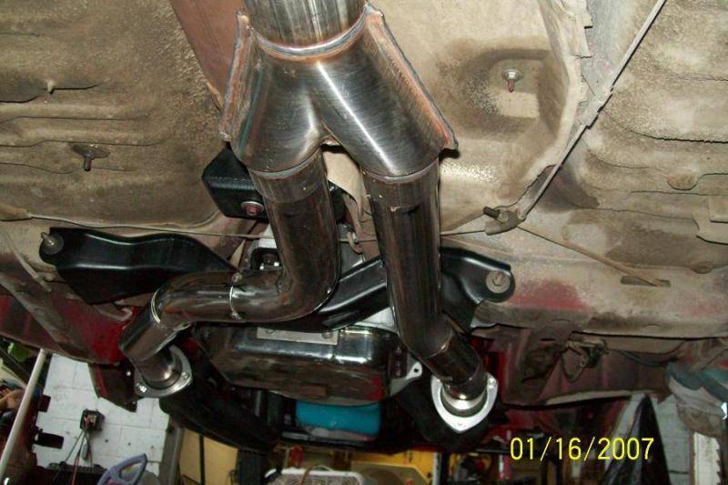

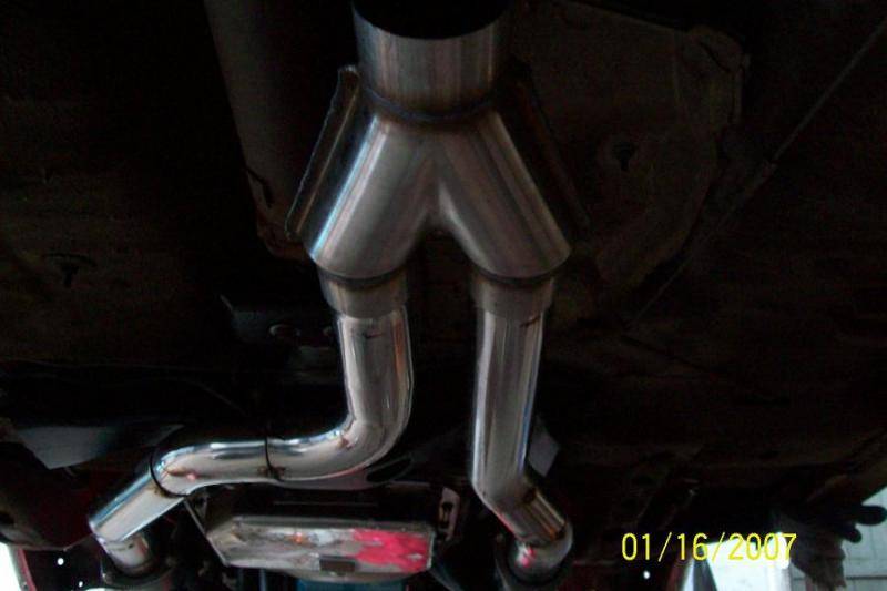

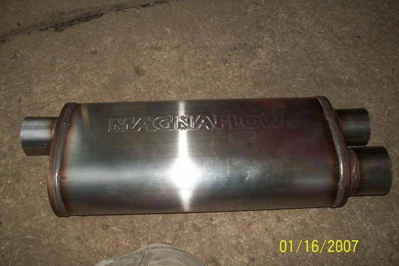

Well, I figured out how the exhaust is gonna go. 2.5 stainless into y-pipe into 3" to muffler mounted cross-ways between fuel tank and bumper. I will fab a heat shield above the muffler to protect tank, wiring, and plastic parts around license plate area. The muffler is a magnaflow with 3" inlet, and two 2.5" outlets. I got the header to y-pipe fabbed and tacked together today. I need to pick up a roll of stainless wire for the mig. Forgot to reset the date on the camera again...DOH !

The exhaust looks really good. I would've never thought to run a transverse muffler and I'd love to hear it. Keep up the good work.
