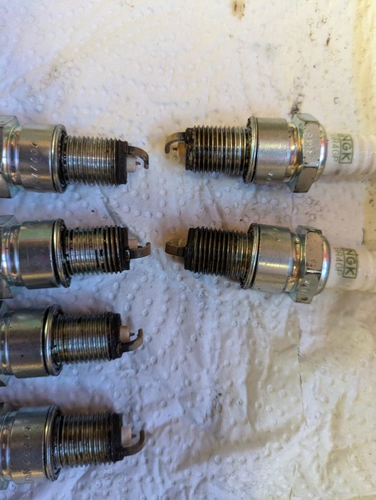

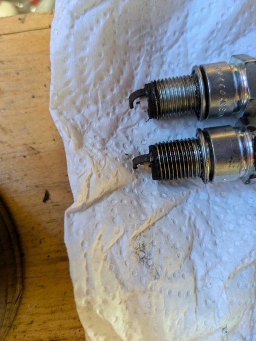

Forgot to post these. These are the plugs that have been in the car since the first month I owned it. The ones that went through all the testing and diagnosis.

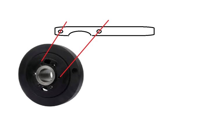

Question though, how are you supposed to torque the dampener down when it just turns the motor? I don't see any way to lock it in place.

I made my own tool for holding the dampener while tightening the bolt.
I found a piece of flat iron, drilled two holes and grinded a half moon shape of it to clear the center of the dampener.
Then I attached it to the dampener using two of the original bolts and laid a piece of wood between the end of it and the crossmember.
I don't have a picture of it, but hopefully you see what I mean in the sketch below. :)
Nice thinking, I'll see if I can mock up something similar in the coming days

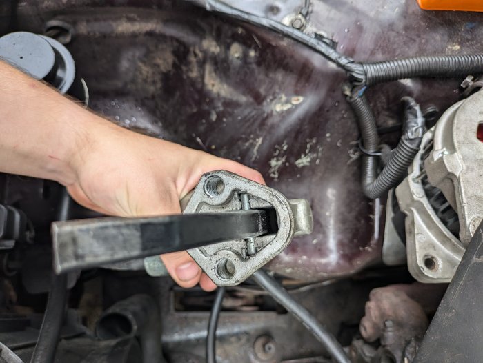

Perhaps its the lever of the fuel pump touching the chain?
A friend had to grind some space for the.chain into the lever.
I'd say if its that, another oil change is due. Take the fuel pump out and check the lever.
AMC Diplomat
Feb 14, 2023
1,717
812
NY
Yeah my guess would be the fuel pump eccentric or the pump arm itself slapping around

Unfortunately working today, I'll get at checking that stuff tomorrow after a funeral.
To add to the above post though, I did line up the eccentric and torque the bolt to spec from my Haynes manual, with a dab of blue locktite.
Hopefully not that, I really don't wanna have to pull it all apart again. But it is what it is.
I already have the WP and fuel pump off, didn't think to look at the fuel pump arm though.

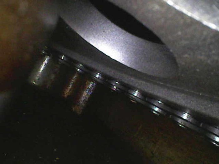

Just a question. Are you sure the crank oil slinger is on the right direction? If it's backwards, it'll hit the chain.

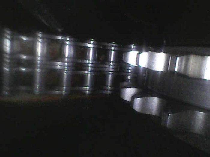

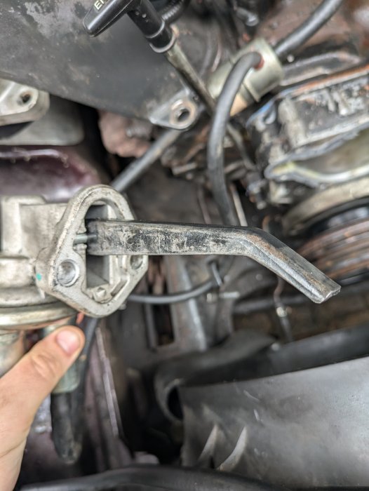

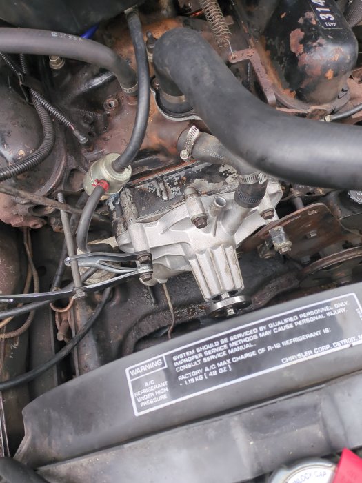

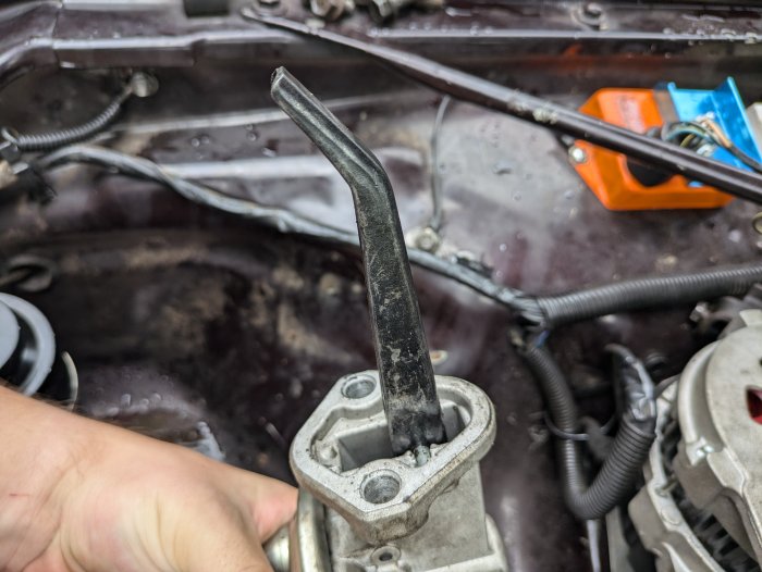

Unfortunately I can't get any worthwhile pictures with my snake camera.
Off it comes again I guess
