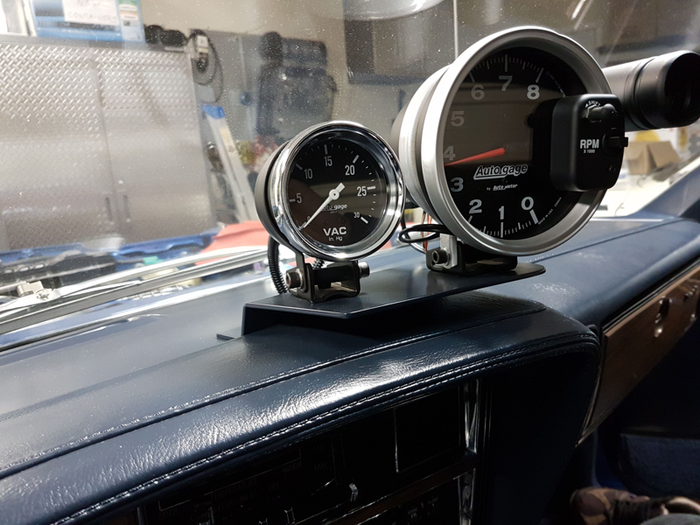

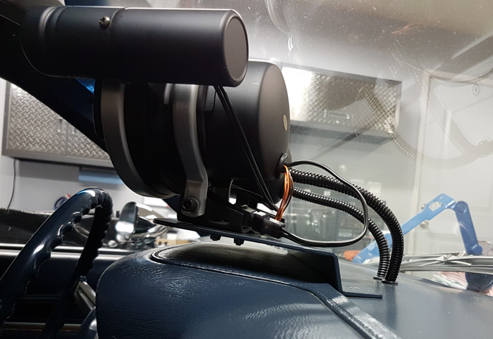

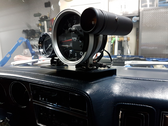

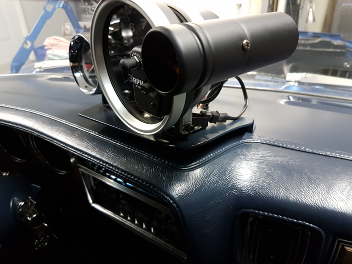

I had someone craft me a nice aluminum tray for my Shift-Light Tach and Vac gauges, which in turn is attached to the metal part of the dash. Anyways, the aluminum tray is contoured so that it doesn't look all that out of place (as far as that's possible with a giant tach sitting right there LOL).
Anyways, I thought I was absolutely putting together the next best thing to sliced bread...until after I assembled it all, finally got the car running and started to hear this tiny little "eek eek" squeak!
Well, as my luck would have it the placement of the tray is such that it lightly presses against the dash vinyl, heck, really almost no touch...BUT...with the exception of a tiny little section!!!
That's where the damn noise is coming from...and ever since I've been trying to figure out how to quiet the darn thing...don't quite want to put oil there b/c I worry that it'll end up weeping whatever I toss on there onto the rest of the dash finish...you know that "wet" spot that just seem to grow on it's own!

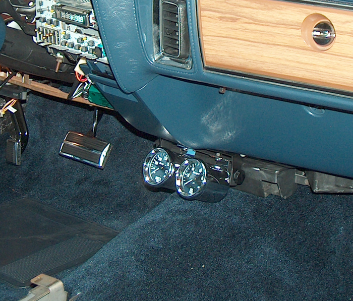

The dash tray has a VAC gauge, the oil pressure and water temp I have sitting just under the dasg cigarette tray, they are housed in a little swivel pod that allows me to move them side and side and up and down.
I will look for that templates...I am fairly certain I did put it away, but man, it's been like 15 years I think! LOL
Here is a pic...(sorry Aspen500 to barge in on your Project thread like that, I meant well...):

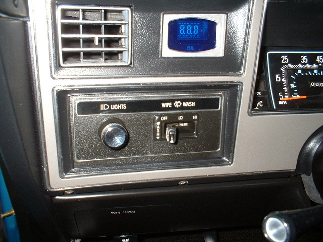

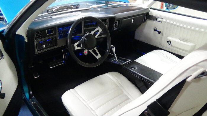

I don't have a tach, just the stock cluster, with an A/F gauge under the dash, next to the console (perfect spot for easy viewing, lol) and a digital oil pressure gauge in spot for the clock so, the car doesn't have a clock anymore. Usually when I'm driving the Aspen, the time isn't a concern. Oil pressure is MUCH more important. If only they made an A/F gauge with blue LED's instead of only red.

...I don't have a tach, just the stock cluster, with an A/F gauge under the dash, next to the console (perfect spot for easy viewing, lol) and a digital oil pressure gauge in spot for the clock so, the car doesn't have a clock anymore...
That's an impressive blending job in getting the digital stuff nestled into the dash...looks like it belongs right in that spot!

Thank you Duke. Most of the interior has been sprayed with either white or black SEM vinyl paint to freshen it up. The white was more of a yellow, and the a lot of the black was kind of scruffy looking. The dash pad is untouched though. Had the front seats reupholstered about 5 years ago, and he did an awesome job, and charged accordingly, lol. Was about $1,500 for both front seats (ouch). His shop is a one man operation so it did take about 4 months but was worth the wait. Things like the cluster bezel were done with Eastwood cast iron gray and their "chrome" paint system and an air brush, along with the edges of the vent louvers. Masking was, well,,,,,,tedious! Covered the headliner with white attached foam headliner material, along with the rear deck panel, new carpet of course, along with the last 2 remaining NOS door sill plates that were in captivity.
Downfalls are the warped, somewhat crumbly 1/4 trim panels and the very crumbly seat back panels. The a-pillar trim is so-so also (warped).

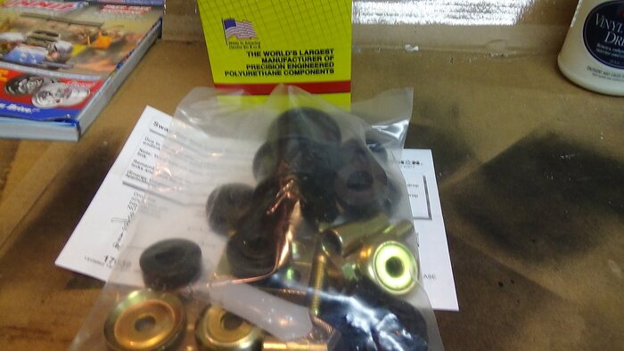

It appears I found my Energy Suspension front sway bar poly kit(!) in theory at of all places, Rock Auto. Showed "only 1 remaining", and I've heard that before when it was actually zero but,,,,,,,,,,,ordered it anyways. Just got an email that it's ready to ship so, we'll see. Still no luck with poly shackle bushings though. At least I'm making progress. Just had tendon surgery on my right hand again Jan 27th (round 2) so won't be able to put them in for probably 6 weeks yet, but at least they'll be here.
Better late than never, thanks M-body. I used the case of an old clock and mounted the digital gauge in it, and modified the clock mounting tabs to attach the whole works to the dash carrier. Used the clock wiring for the gauge using the original terminal and connectors. Even worked out that the clock light wire works to signal the gauge electronics to dim when the lights are on at night.

Never knew FedEx delivered on Sunday (do now) but, the poly sway bar kit came today from Rock Auto. Looks to be all the correct parts for an F-body.
Proof it happened photo:

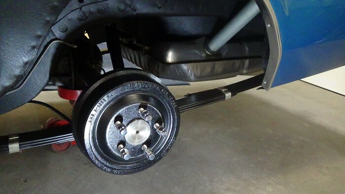

Now it says estimated ship date 06.06.22 for the shackle bushings. So I said screw it and ordered a leaf spring bushing kit instead. Far as I can tell, the front eye's on my springs are the same as the '68-'72 B-body the kit is for (2"). Wasn't planning on changing the eye bushings but probably wouldn't hurt to do them as well. Since the spring pads are already poly, the circle will be complete. Besides, the shackle bushing are Prothane brand and NOT made in USA. The spring poly kit is Energy Suspension and IS made in USA, plus it's actually in stock. They show no listing for Energy shackle bushings separately. There, done, problem solved. While I was on Summit, finally broke down and ordered a creeper also . Enough sliding in and out from under the car on the floor. Getting too old for that crap anymore.

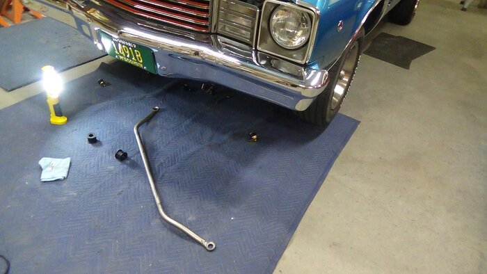

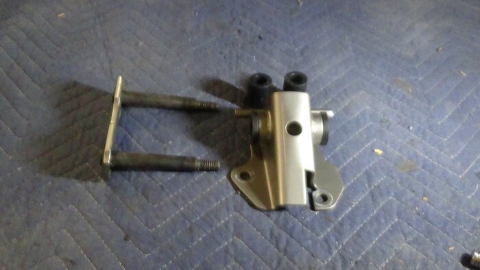

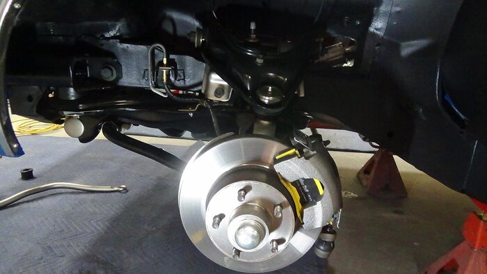

Got the front sway bar bushings installed and started on the rear. Right side shackle and bracket ready to go back together and then it's off to the other side.
