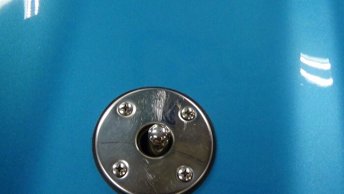

Ordered some poly shackle bushings from Mancini and, while I was there, ordered a front sway bar bushing poly kit. Also decided to order new hood pin scuff plates(Year One). They were brand new in 2012 and now they're, well,,,, scuffed and bugging me.

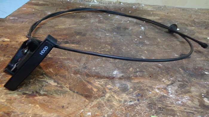

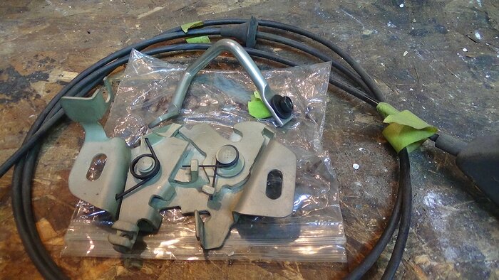

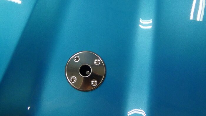

New hood pin scuff plates are on and look much better. To keep them from getting so gouged up, decided to install the primary latch and an inside release cable. Then I can raise the pins up slightly. Right now, the pins hold the hood shut, along with the secondary latch. I redid the primary and striker a long time ago, but never put them on the car and also had the remote cable on the shelf from a parts car. "Restored" the cable assy and now only have to convince myself to make the 3/4" hole in the firewall (without chipping the paint).

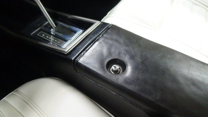

For the 1st time in 30 years, the console lid latches and latches securely and won't open up randomly while driving down the road. Got a new repro lock assy from Tony's Parts. They're made for early B and E body but fit an F-body console perfectly. The housing looks different than F-body but makes no difference in fit or function.

Got the remote hood release and primary latch installed, mostly. Still need to find a couple correct screws to attach the handle to the dash, and also get the clip that holds the cable housing in the latch. It works good and after adjusting the hood pins up a tad, the scuff plates won't get scuffed as quick this time.

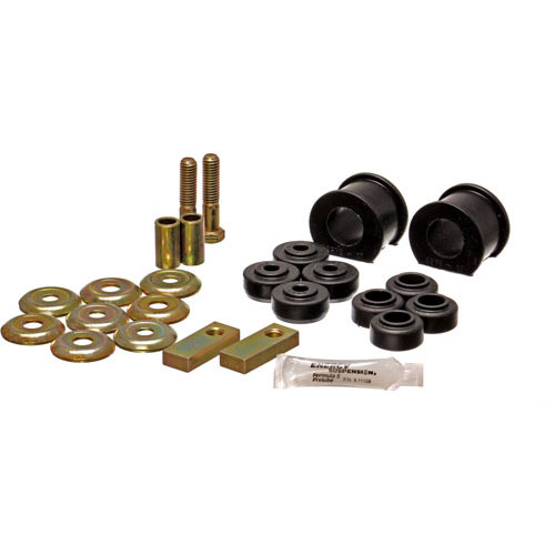

I had ordered poly shackle bushings and poly front sway bar bushings kit from Mancin on-line. No charge on the Visa yet, no order confirmation either. Sent a couple emails, 2 weeks later still no response. Called them, no answer. Not sure what's going on there, hope they're not out of business or something.
Anyways, unless they had them in stock, wouldn't make much difference. The ones they sell are Energy Suspension brand so,,,,,,,,,went to Summit and found the bushings and kit. "Out of Stock", estimated arrival date of 02.28.22, rats. Found them in the Prothane brand and even worse, estimated arrival date 03.31.22 Thanks Brandon. :mad:

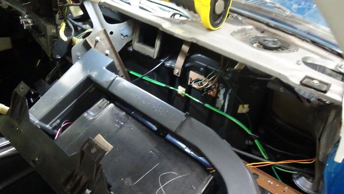

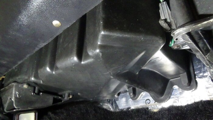

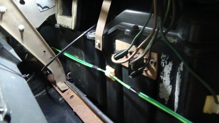

Appears I won't be able to get poly shackle or sway bar bushings until late April at the soonest :( Tore into the instrument panel to find, and fix, an annoying, irritating, constant buzz/rattle noise. Don't even have to be moving, just have the engine running in gear. Made sure all the wiring harnesses were secured well, wrapped foam tape around wiring where it contacts a surface, and put foam bits in the plastic harness routing clips. Amazing all the white plastic stick on clips were still attached. After all that, it turns out that the noise was probably the glove box lamp. It sticks in a hole and doesn't fit all that tight, and even with the glove box door closed it can rattle. So, a cut a piece of dense foam and put between the switch and side of the glove box so can't rattle. Also made a metal bracket to fix the broken mounting tab on the far right. Bad part about doing noise repairs in winter,,,,,,,,,,,no road test to see if it was a success. Time will tell.
These were taken before doing any actual noise abatement work.
