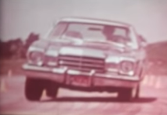

From a new F test vid, I will just leave this here and pass along the commentary of its superior handling ability. I guess a good body roll std. was not grinding the corners of the bumpers off.

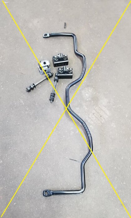

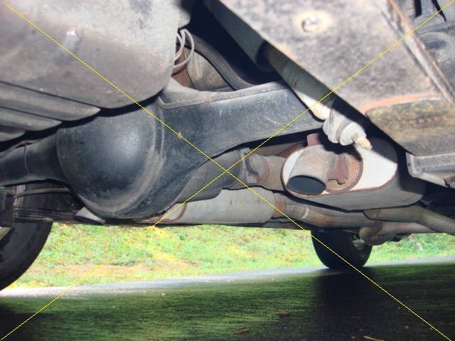

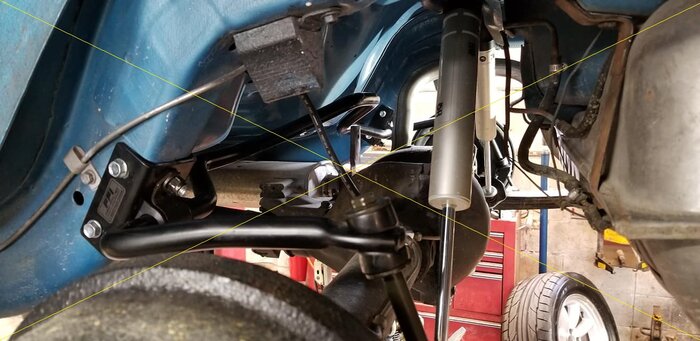

Here are some ref. pics and you will see why I asked about the ex. I have more detailed ones of the FF install I can email you if you want them.
This was my 440 F dont show much but it does the the bar and the route with still using the iso setup. Looks like I could of corrected the pinion angle but it never presented a issue.
Here is the FF setup installed on an F with the 8 3/4 and still using the iso setup.

Thanks X! I hadn't thought of the t-pipe cross over above the axle. Pretty sure it's high enough up to not be an issue, I hope anyways. Got to go out and look if the e-body bar is shaped the same. Whether the e-body bar fits or not, I may end up just getting the FF set up and being done with it. Would save a bunch of work derusting, smoothing and detailing the one I have.
If the exhaust is in the way, that throws a wrench into the works.
