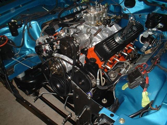

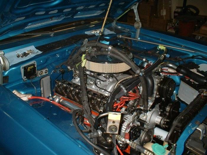

The right side spark plug access is,,,,,,,,,,,,,,tight. May depend on what headers you use also. The Schumacher ones don't really cause any plug issues.
The back two plugs a can get with a plug socket using a wrench on the sockets hex. The front 2 requires removing the control arm bolt access panel.
Of course the left side is much easier but cyl #3 need the wrench on the socket because the steering box and lines are right there.

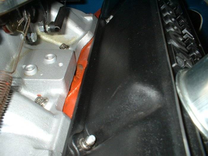

As an after thought, I notched the A/C recirc duct and made a screw on panel for better access to the rear lower valve cover bolt. Before that I had to loosen the motor mount and jack the engine up a bit and then use a 1/4" extension and swivel socket. When I had the engine out to build it,,,,,,,,,,,,,again,,,,,,,,,,,,is when I did the modification. Knowing before hand would have great, could have welded a piece in and smoothed it all out. Never had the MP covers on in the cars previous life, only stock ones which didn't cause any problems.
Should have seen me trying to cut the section out on a finished car without scratching, chipping or otherwise efing up the paint. Just a little nervous, lol.
Obviously if you have A/C it makes right cover removal tough. The lines and expansion valve have to come off or the cover won't fit, which means always discharging the air if the cover has to come off for any reason. A minor inconvenience in the grand scheme of things though! I'm so used to taking half a car apart to get a valve or cam cover off,,,,,,,,,,,or just to change plugs at work it doesn't bother me very much to do the same on my own car. It's like "normal" lol.

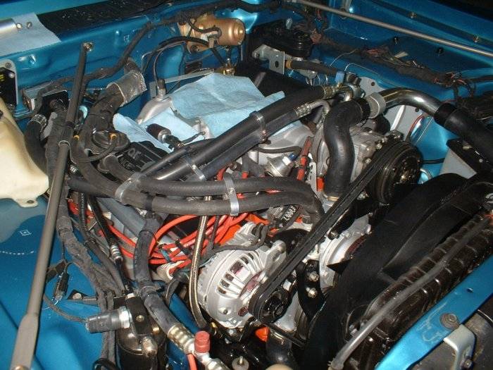

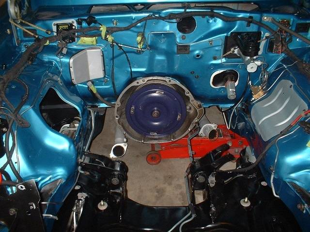

The pic above is while putting the engine in after the 2nd build. You can see what i meant by the trans cooler lines and hoses.
1,492
Not sure when Chrysler went from transmission cooler lines piped/screwed straight to radiator to having a short piece of hose between the two. The cars with hoses have less line breakage – but have more leakage at the hoses (mainly with cars with Lock-Up, sense transmission cooler pressure is a lot higher than cars without Lock-Up).

My ’86 has A/C but firewall is completely different ('80-up design), so the firewall air box is not an issue. The A/C hoses will be (can be?) an issue sense the expansion valve tilts towards the engine (not flat like ’76-79 version is.
My ’77 is a no-A/C car, so it doesn’t have air box but will have same issue when I convert it to ’80-up firewall holes/lines.

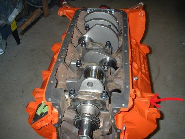

The mounts are stock OEM big block spool type off of an unknown donor. I have the right one bolted to the front of the block bosses instead of behind and it lined up perfectly. I cut the front upper boss down to line up with the front lower one. The upper bosses are thicker with the extra material to the front of the engine (as I'm sure you already know).

Having the short cooler hoses does make more sense than a rigid connection. One of the reasons I put flex pipes in the exhaust just downstream of the header outlets. Less stress on the system and the pipes can be routed closer to things without hitting and doesn't need as much cushion in the mountings among other reasons.

Aspen500 -- what's the 'block boss' or 'upper boss'? I'm looking through my service manual, but I can't find that term.
7,323
2,971
"boss" refers to a mounting tab cast into the block (or other component) that something is bolted to.
Picture worth a thousand words. In the picture you can see the one I cut down (the one below the arrow) Originally it was the same thickness as the other side.

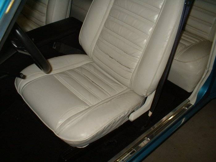

Decided to part with some of that hard earned money and get the front seats reupholstered. There's an excellent place on the NW side of town. He gave me an estimate of $600 each for duplicates of the original made and installed. What the heck, can't take it with you, right?
The drivers seat's been bugging me ever since the car was "done". It's split a few more seams since then. The vinyl and thread are showing their 40 year age I guess.
Passenger seat is in very good shape but I know the new vinyl and old will never match and that would bug me more than split seams:eek: The rear seat has a couple seams that are just starting to split but it'll have to wait until next year due to $$$. The house still needs a new dormer roof, the chimney top needs fixed, I need a new front door............................You know how it goes?:confused:
