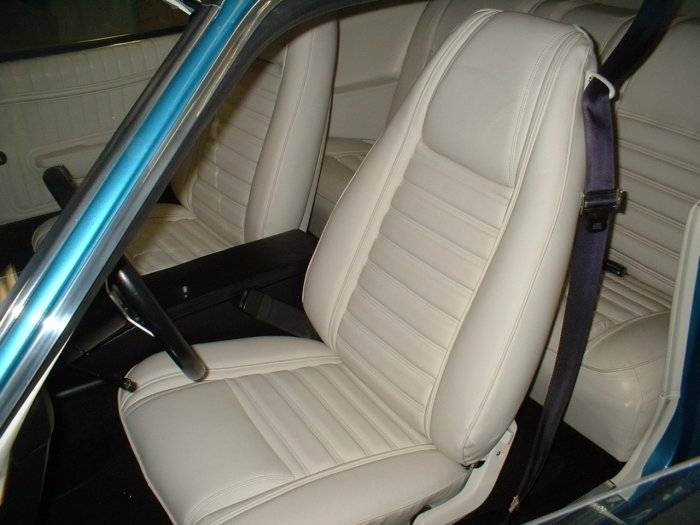

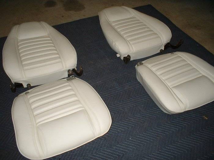

The seats are done(!) Just have to get up there to pick them up now. Was more than the original estimate by about $200 or so. He had to do a lot more foam addition and shaping than it looked like was needed but that's fine. I'd rather pay a little more and have them done right AND feel right (meaning comfortable) when sitting in them.

The seats are back home. Soon, they'll be back in the car. They turned out darn nice.

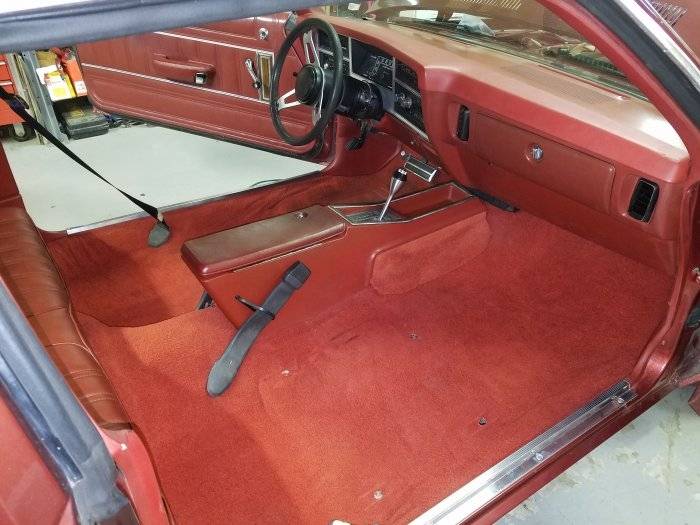

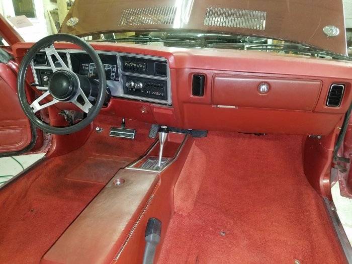

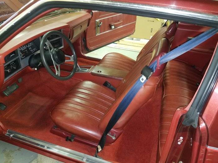

The car is a complete car once again. Now I can relax, lol. I must be getting old. Putting seats in a car didn't used to be so tough. Wish I was 20 years younger..........
Only thing now is, what looked like a perfectly good backseat, suddenly looks 40 years old. Something to take care of NEXT winter.
Kitcar Chris, your interior looks perfect, right down to the unbroken seat belt buckle straps on the center console.:cool:

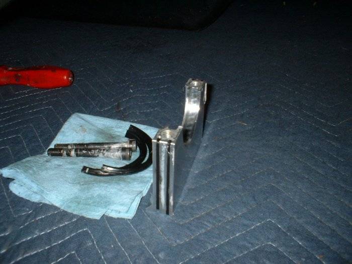

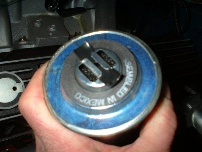

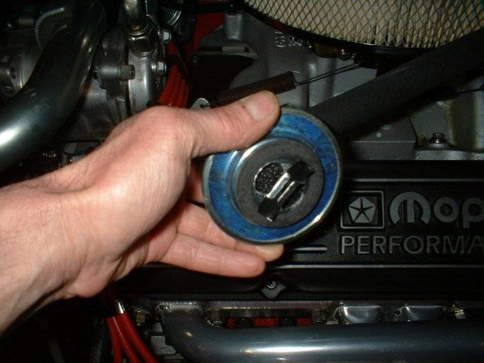

My winter rear main seal fix, didn't. Managed to make it way worse. So,,,,,,,,,I tore it apart again. Used a Fel-Pro tan seal and on the seal retainer put anerobic sealer ("strawberry jam") on to the inside of the square cut side seals of the retainer and Permatex #2 on the outer side, for a double chance of sealing. Made sure the retainer stayed perfectly flush with the back of the block when torquing the bolts, etc, etc, etc. Then let it all cure for the past few days. Dumped oil in and took it for a short drive, about 5 miles. So far, I give it a cautious thumbs up. Not a trace of oil on the bell or converter shield. I really hope this time was the charm, I really do.
Oh yeah, I also opened up the holes on the breather caps as much as possible, on both the air inlet cap and the PCV valve cap, just to be sure the ventilation was adequate.
Before:
After:

Those seats look fantastic Aspen 500.
Are those seat covers or did the upholstery shop fab them up?
I wish legendary or someone would make covers for our cars,
2,991
The seats were done by a one man operation local upholstery shop. Wasn't cheap (about $1,500 for the pair) but he did an excellent job. The results kind of softened the sticker shock,,,,,,,some.:eek:
