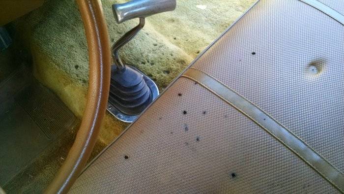

Thanks for the info, I haven't seen any of the two piece carpets in any FMJ's, but I rarely ever see any J's particularly. Really too bad that I have to replace it at all, because the carpet isn't worn, and not terribly faded, but the old woman who bought it new had a bad cigarette habit and terrible ashtray aim - result: burned holes all over carpet and front seat. Argh!!

Thanks for the info, I haven't seen any of the two piece carpets in any FMJ's, but I rarely ever see any J's particularly. Really too bad that I have to replace it at all, because the carpet isn't worn, and not terribly faded, but the old woman who bought it new had a bad cigarette habit and terrible ashtray aim - result: burned holes all over carpet and front seat. Argh!!View attachment 18856
That is too bad, looks nasty. Are you sure that all of them are burns? I had a similar bunch of what I thought were burns in the 1980 Cordoba that I bought. Resigned myself to gettting a new carpet. I did start to clean up the rest of the interior using a really good, but inexpensive cleaner. It was one of the type that needed to be diluted to be used, and had a bunch of dilution ratios; 10:1 for upholstery, 5:1 for carpet, etc. It cleaned up the upholstery pretty good, as well as the door panels. I decided to try it at the 5:1 on the carpet, figuring to get it as good as possible until I could get it replaced. Turns out the burns were actually dirt/grease spots, and came out entirely. I am not saying that you can get all of your burns out, as it looks like you have the same burns on your seat, but you can try to clean them anyway, and make them little less visible.
I've used that cleaner that needs to be diluted - it worked really well and was very easy! I think it was Carbona or something like that. They are definitely burn holes in my carpet, so no amount of cleaner will take care of that. However, I have thought of trying to snip out the burned areas and glue "plugs" of good carpet in their place. I could get the "good carpet" from the edges under the back seat, etc. Then, I could dye the entire carpet to freshen it up.... or, I could just spend the money and buy new. Certainly would be easier and faster. The seat doesn't matter to me because I have really nice plaid 60/40's and the plaid door panels to replace all that with. Time to do all this is what I don't have. I have been waiting to replace the interior of OY for a year and a half now. I work full time and when I am not doing that, I am completely rehabbing a house that I want to sell. Always working, no time for fun. Very frustrating.
I read, or saw, somewhere that you can cut the "fuzz" from some good carpet under the seat or sill plate and glue it to the burn spots to hide them, rather than actually cut the carpet all the way through. I believe they used some sort of paint pen first to make the black spots more the color of the carpet before gluing the fuzz down.
That's a good idea, and likely less difficult too. I'd like to try it to see if it would work, but I'll probably just wind up buying the one or two new carpets instead. Then, I also have been thinking more about getting OY painted, and I was thinking that it might be a better idea to wait until the body and paint work is done before putting the interior in. I keep going back and forth between doing it up the way I really want to, and just making do. For sure, nothing is going to happen until at least Spring, but I do like to think about it. In the meantime, I have to finish laying tile in the foyer, and put new oak treads on the stairs in the house along with a new railing and banister. Then it's on to putting up crown molding, painting, refinishing the floors, etc, etc. Hoping to be able to put it on the market in the Summer...with some luck and a LOT of work left to do.

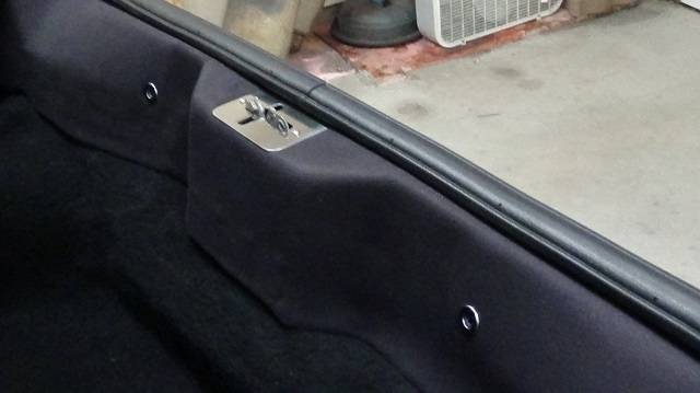

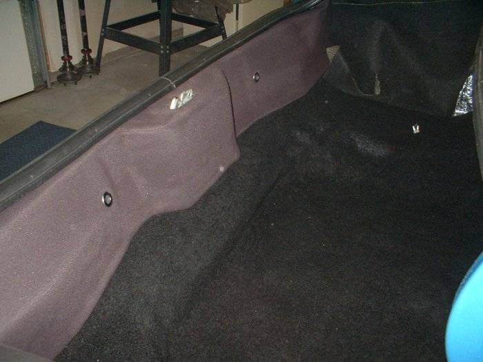

Got the tail lamp finish panel about 90% done. About time, right? lol
Going to make a bezel for the latch opening yet to make it look more finished, rather than the material folded around the edge.
The camera flash makes it look gray but it really is black, just like the carpet. Foam backed headliner material. Came out pretty darn good. Not professional perfect but it was priced accordingly at roughly $20 for materials and labor. Since I didn't charge myself for labor.........................:D
It took awhile but got the latch bezel done and the tail lamp finish panel installed. It turned out decent, far from perfect, but decent. I can live with it,,,,,,,,,,,for now.;) It's tin plated using an Eastwood zinc/tin electroplating kit, then buffed as well as possible, followed by Diamond Clear so it won't flash rust.
