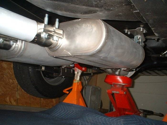

Got the mufflers swapped today. Didn't go too bad. Had a struggle getting the right side one off the pipe and ended up resorting to desperate measures. Had to cut a slit in the pipe with a die grinder before it would even wiggle.
It's raining (big surprise, NOT :mad:) so someday I'll get to find out how they sound and if the interior drone is gone, or at least reduced to tolerable levels.

They do look huge in the pic but they're not really. The body is 14" long, 4 1/2" thick and 9 3/4" wide only.
Yes, 2 1/2" pipe. It was a heck of a thing to get a pair of 2 1/2" t-pipes out the back, both running on the right side of the fuel tank. It's close, but they clear and don't touch a thing.
Had the rare dry time and took the car out for a short drive. Didn't go far, dark clouds coming in from the west..................... Got to a spot where I could get up to 55 for a short distance and the drone is pretty much gone. Now about all I hear is the exhaust noise from out the tail pipes. It's going to make the car so much nicer to drive. Now a person could have a conversation or listen to the radio no problem.

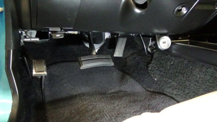

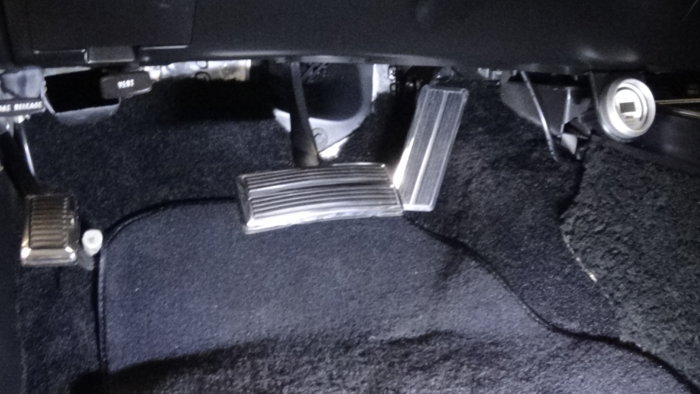

The latest "off season project" is done. Swapped the throttle pedal for one with a bezel. It's actually an NOS one for early B-body so it's 2" longer below the pivot. Works perfectly since my pedal is mounted an inch higher and an inch to the right, along with the cable hole in the firewall, so the cable clears the head without kinking. Made it awkward to use but now, it should be just fine. Found an NOS brake pedal bezel and just put it on today. The parking brake bezel was on the car when I bought it 32 years ago. Holy crap, was it that long ago? How time flies.

Before and after on the pedals:
Learn something every day.
I like the longer petal and the chrome trim tops it off.
I'm not sure if the longer pedal would work with it mounted in the stock location. Above the pivot pin, it's exactly the same though.
I originally bought a repop brake pedal bezel, but they're made for '74 and older A/B/E body with a flat pedal. Newer pedals are curved and there's no way to make the flat bezel curved. I didn't realize this until I got the part and then, DOH! Found a correct NOS one for the curved pedal, paid more than I really wanted to but, it is what it is sometimes.
Worst part was, I found an NOS one on Ebay on Dec 25th, the listing ended on Dec 24th. Price, $10 + shipping. Son of a........................

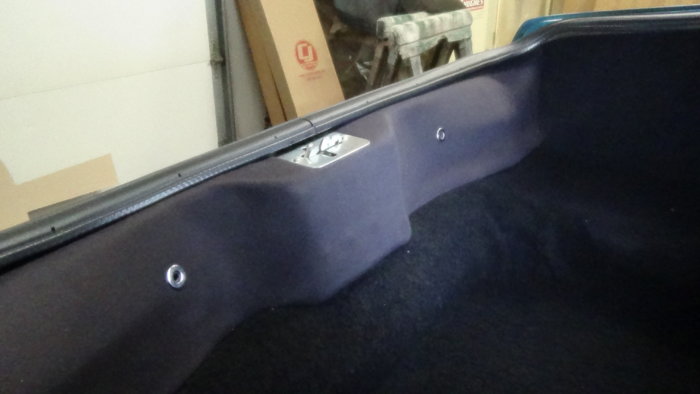

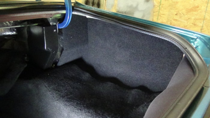

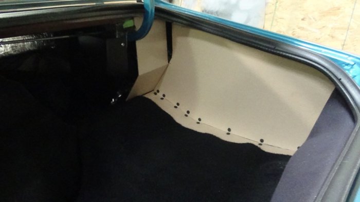

After a bit of a learning curve working with the compressed cardboard panels, think I've got it figured out. Pic is where I'm at so far, mis-cut and all. That'll need a piece added in but should be fine after the carpet is glued on. Lots of work to go but at least I FINALLY got started on it. It's only been on the off season project list for 5 years.:rolleyes: No sense in jumping into things you know.:D
After patching in a piece where I cut the panel too short (by the hinge area), got the carpet glued to the panel board.
Good tip I forgot was, if the panel isn't flat, don't try to glue the whole thing in one shot.o_O Contact adhesive doesn't really give you a second chance once the two pieces touch. Managed to save it though.
Need to get some Velcro strips for attachment, and probably to hold the floor carpet flat where it overlaps the side pieces but so far, it's not turning out TOO bad.
Now that I've got the procedures more or less figured out, the rest should go much better and maybe a little quicker, not that there's any big hurry.

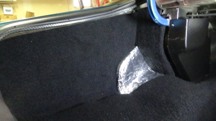

Learning from the mistakes doing the passenger side, the drivers side went much, much better. Will have to make a carpet piece that gets glued down to cover the silver that's still uncovered. Darn fuel filler pipe and the needed bump in the inner fender anyways............After some grub before I pass out from starvation, want to tackle that part yet today.
Ran out of adhesive (had just enough to finish what's done) but because of the fog with a 25 foot visibility range, getting some more isn't happening today. It's one of those things I was going to pick up last week but totally spaced it. Oh well, business as usual:p
I really like that carpet look on the inner, sides.

Thanks! When I bought my car, the trunk was bare except for the taillamp cover panel. No idea if it ever had the floor carpet or not. The floor carpet came from Deconstuctor Jim. Doing the rest because I've always wanted to finish off the luggage compartment.
Far as I know, F-body never had the side panels. There was a carpet option but it was only thin carpet glued to the inside of the 1/4 panels. Don't know if it was a stand alone option for all years or only came with the early fold down rear seat cars.
Why my car has the tail lamp cover, I don't know. Maybe the original owner added it or it could have came from the factory that way, which would be kind of odd. The world may never know, I'm just glad it does have one.:) I covered it with black, foam backed headliner material. The bare plastic just didn't do it for me.:eek:
