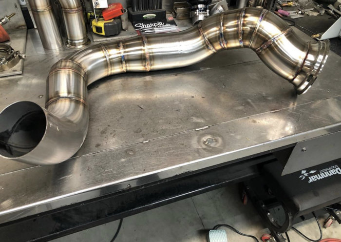

Just about done with the down pipe. Runs up into the fender and follows it around. As BudW pointed out in an earlier post, that fender is about guaranteed to get roasted now. I wonder if they’re going to wrap it or insulate it in some fashion.
7,323
2,971
If you can afford to pay someone else to work on the Audi maybe,,,,, as long as it isn't me, LOL! They cost twice as much as a non-German car just to change the oil, not to mention anything else more involved. I worked on those things for 5 years at the dealer here and every time I get one in my bay at work *which fortunately is seldom) I get the heebie-jeebies and have flashbacks.
We're scheduling over a week out also. Been that way for the past couple years straight with no time to relax, not even one single slow day. Guess we're doing something right to have that much business.
I'm thinking some sort of heat wrap/insulation would be a wise idea on that down pipe.

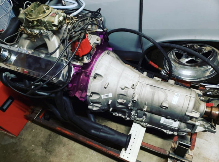

Yea, that’s an hp70 8 speed mated to a LA small block

Any more to the story on that LA with the HP70?

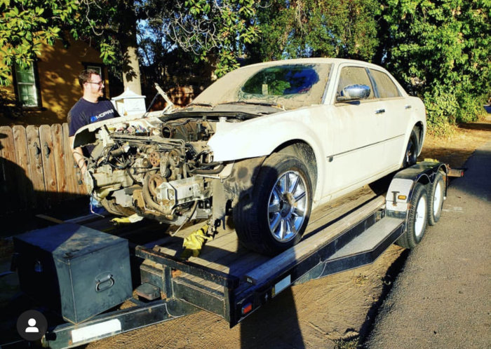

Guy picked up a wrecked Chrysler 300c and is going to eventually stuff the engine into 72 dart swinger and he also bought the HP70 from a guy who wrecked a challenger hellcat. He has most of a center console, shifter, gauge cluster from a Challenger done and wired into the car. Idk if the HP70 is a direct bolt on or not to the LA engines but, I don’t see an adapter plate or any indication the bell house was modified from the pictures. He’s planning on running this combo for a little while until he can get the Hemi into the car.
1,492
As noticed, it will bolt onto the block without issues.
The flexplate, I can't comment about (too new for me to know).
The crankshaft position sensor hole is very close to the engine flange and I “think” is also a sensor for the transmission computer.
The only hard part will be the computer that operates the transmission, transmission mounting, propeller shaft attachment and speedometer drive. If the computer is combined with the engine computer one might have problems. If transmission computer is separate, then you might have a winning combo there.
If the propeller shaft flange looks like this:
Then the differential flange will need to also look like this:

I’m trying to get more info out of them but, I don’t think they’re eager to share. As far as I can find online, this is a first for a LA and HP70 to go together...but still isn’t in/or moving a car down the road just yet.
Edit: once it’s in the car, they will do a write up on how they made it happen. I’ll be sure to post it here when they do.
1,492
The 8HP70/845RE transmission is based off and licensed from European ZF 8HP55 transmission with ZF approved Chrysler modifications. The transmission does have a separate transmission computer (which is good) but they put it in a not so good location.
Electronics, in general, do not like to get wet, don’t like heat and don’t like vibrations. Well . . . this computer is actually inside of the transmission, soaked in and baking in ATF. I can’t comment about vibrations, but WHY put an item that doesn’t like to get wet or hot, inside of an automatic transmission? (no need to answer that).
To purchase a computer – it comes with the valve body attached. If you purchase valve body – it comes with the computer, as well - and it is not cheap (about $1,200 (US) - the last I checked) and a new computer/valve body needs to be programmed before transmission can be used (ie: Dealership).
Here is a good link that talks more about that transmission: 845RE / 8R70: ZF 8-Speed Automatic Transmission for Chrysler cars .
Can't wait to hear more.
7,323
2,971
The TCM is inside many transmissions, bathed in fluid and very, very, very seldom do they fail. Actually, the fail even less than that so nothing to worry about. The external, underhood mounted ones fail more often, and that's still rare. Water and even worse, water with road salt dissolved in it, are what kill them if the case seal leaks and inside the trans, no water or salt (hopefully!).
BTW, the crank position sensor is only for the engine. Transmissions have separate input and output speed sensors (many times 4 or 5 of them total).
A stand alone trans controller is about the only way I can see that trans working with an LA engine since the TCM gets much of it's input data from the ECM (and even the ABS module in certain cases). I'm curious to see what they do to get it all to work. All I do know is, it's way beyond my capabilities!

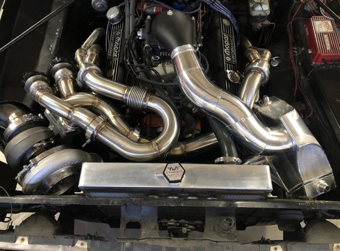

Turbo, stroker 318 update: cold side is mocked into position. Just waiting on the HD clamps from, Vibrant performance to get everything cut and welded down solid. Intercooler is built around a 1000hp Garrett core.
1,492
Is that enough radiator for engine and for the water/air intercooler?
I would think the coolant pipes would need to be larger for the intercooler. It looks like the coolant fitting close to the exhaust should have been moved outwards a tad.
Anything going in front of the radiator (like a pusher fan motor)?
There is more than enough room to put the A/C compressor up top.
Some extra fine work there.

BK Fab responded: that this will be more than enough to keep both turbo and engine cool. Has a large duel electric fans pulling air through the radiator as is. These Garrrett Intercooler cores are used by Roush, Mercedes AMG, Ford SVT and others in cars that produce over 1,000hp and can/are ran consistently at high rpm, so this should be more than enough for short weekend cruises and occasional trips down the drag strip.
