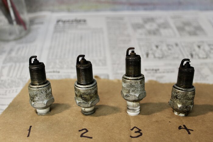

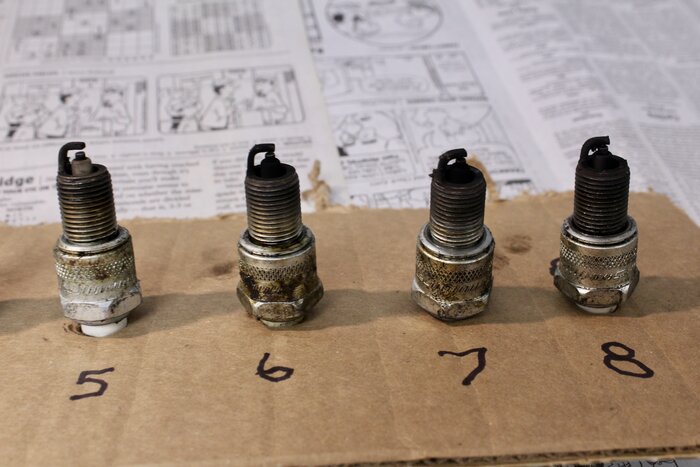

When you remove the EGR valve - check both passageways (underneath the valve) for stoppage (carbon deposits). If one side (or both) are stopped up, a new EGR valve will not fix anything. It will also NOT be the cause of a rough idle.
If your passageways are stopped up, it also tells me your valve seals are probably shot.
How did the old plugs look (rusty, oil caked, melted, smelt like gas, etc.)?

Saved the old plugs. Took pictures. I can lighten these pictures up a bit and reload if it will help. Plugs 1 & 8 had some crud between the tip and the electrode when I pulled them first out.
