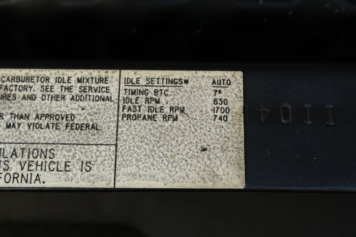

I should have done this sooner! Finally found my timing gun yesterday afternoon. This morning checked timing at idle. The sticker on the radiator says '7' degrees before top-dead-center. See photo. The timing gun revealed current timing is at about 12-14 degrees after top-dead-center. It looks like I need to re-adjust the timing. Bear with me please! Which way should I turn the distributor to get the timing mark back to around 7 degrees BTC? Clockwise or counter-clockwise? Is there a bolt that supposedly holds the distributor in place that I will need to loosen to make adjustment to? Could you give me a general idea of where the bolt will located? Any help is greatly appreciated.
