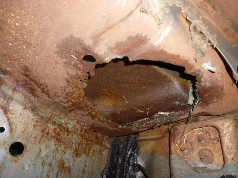

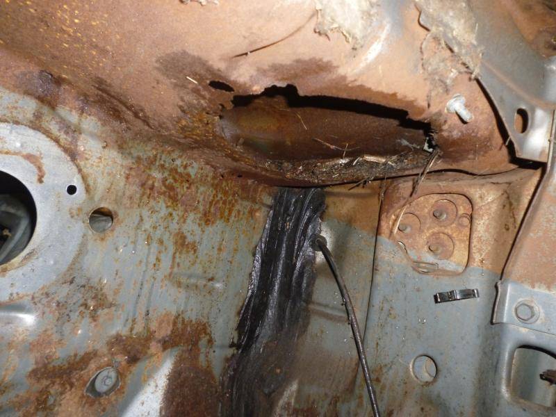

I am pretty sure we have what we need to fix this ... the reason it rusted out if from the vent ducting under the hood rusted out so bad to where it allowed water into the car which rusted the floor board out and then the frame rail. so....
To fix this right I have to take the dash out weld in new metal to stop the leaks, then the floor board and the frame rail.

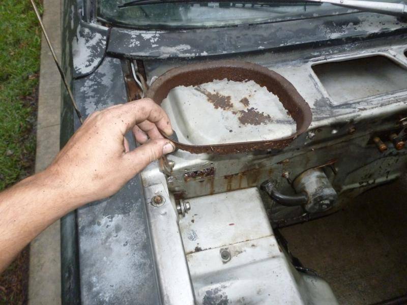

This is the source of my problem right here the drain dike came clean out of the vent galley.

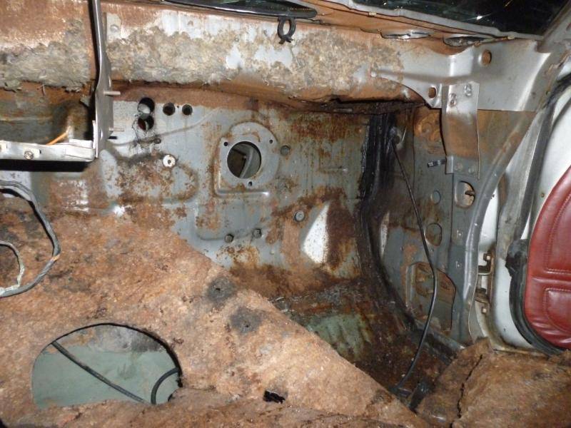

Dont worry every one I'm not discouraged I am still kickin but I will post pics soon I just have other things to take care of on top of the car build right now. I did get the floor pan cut out and like I suspected the cancer rust is only on the bottom of the frame rail after grinding the hech out of that and cutting the rust out I will be able to cap it. The inside is gettting Chemically converted and painted with some good paint then I will grind the weld points down again and button her up. today after I take care of some errands I will post pics of the progress. found more rust of course after the seats and carpet got took out nothing that I cant handle though. And I got the Aspen all cleaned out. thank god it doesn't need as much body work as mine does.
