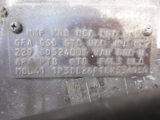

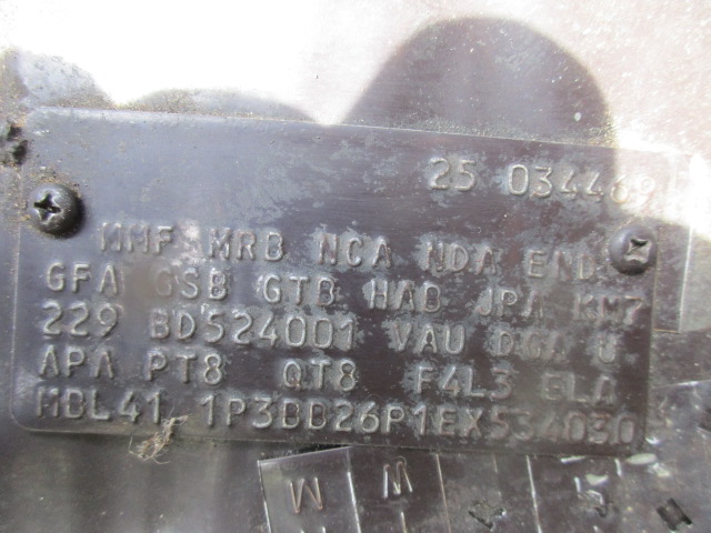

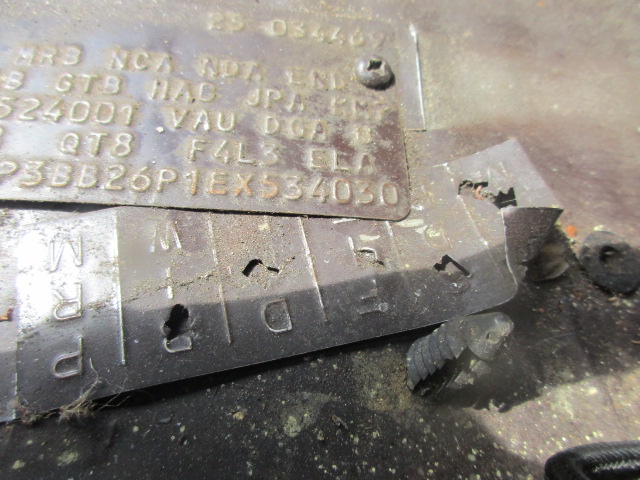

Fender tag pictures Don't mind my Solar Dome
I knew what you meant. I did some research and looked up the paint codes and interior codes. I found some old brochures. It appears that the closest color I found for paint is Sable Brown BT8 but it doesn't match the fender code. Interior appears to be Beige. The only full vinyl bench seat color available according to the 1984 brochure.
No, I didn't mean it that way. What I meant was, a good shop will be able to do it and if they can't (or won't), there are those that will. No offense intended!
Thanks for taking the time to explain it.
I found both BT8 and PT8 listed as Sable Brown solid (non-metallic) for 1983-1985. No idea what, if any, difference there is between the two. Can't tell from the pics if the underhood paint on your car is solid or metallic. Possibly the listing I found is wrong and either BT8 or PT8 is metallic(?).

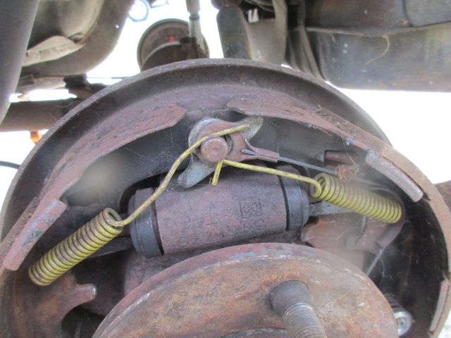

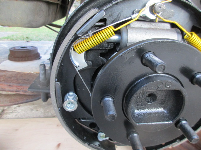

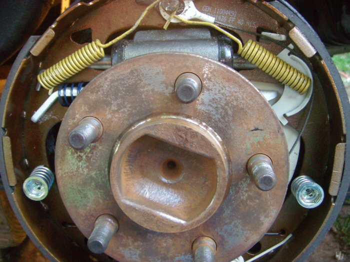

I'm working on the rear brakes. Is there supposed to be a bar that goes between the shoes? I'v never seen a rear axle brake drum without one but this car doesn't have one on either side
This is what I've got in comparison. A 1983 J, though. There is a bar under the wheel cylinder with a blue spring.
You're not going to find that bar in hardware kits. Someone here will probably have them or you could go junk yarding. Don't know if 11" drum breaks use the same lever. Unless someone knows then be sure to get one from a car or truck with 10" drums.

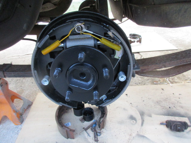

Worked on one side of rear brakes today Haven't done much to it in a while due to my rheumatoid arthritis acting up.

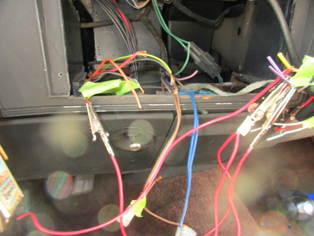

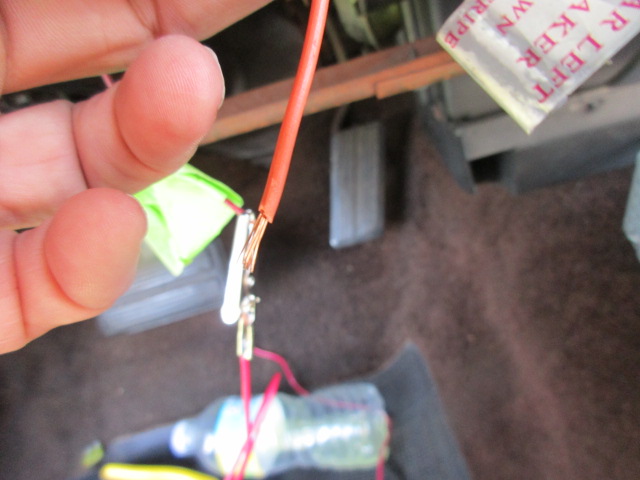

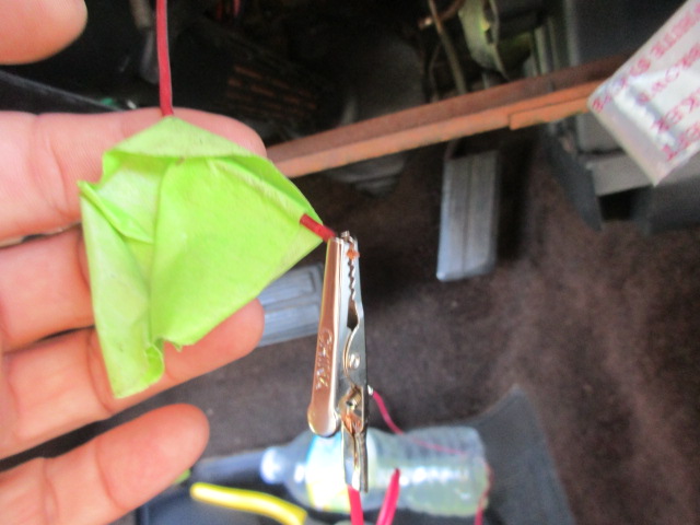

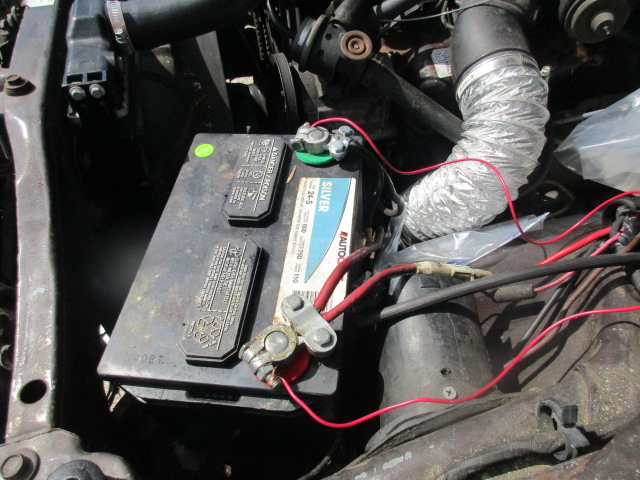

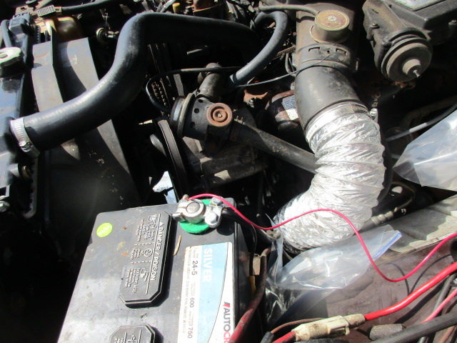

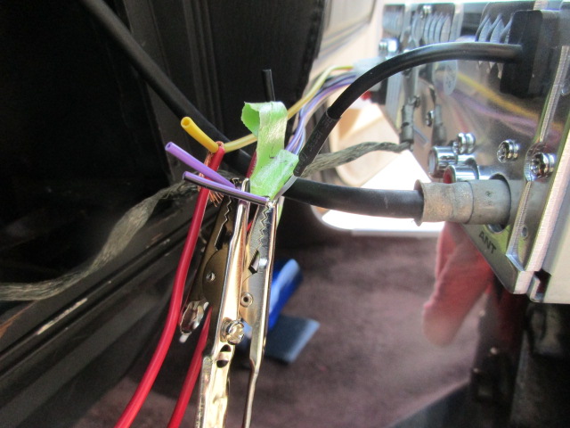

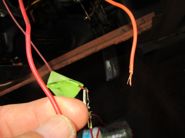

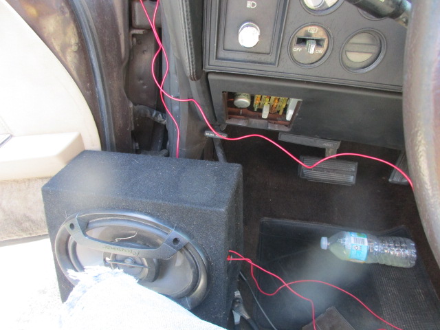

Also did a little wiring work the Radio wiring is a where is Waldo search. I figured out the rear speaker wiring and the Keyed 12 volt power. There is no 12 power to the radio except when the key is on. I ran a jumper wire to the positive Battery side for 12 volt power. What I did today was just to figure out this mess. I have a question The Red wire with tape is the 12 volt keyed power But the other Red wire and Orange wire have no power What are these wires for My repair manual doesn't have Radio wiring diagram Thanks
