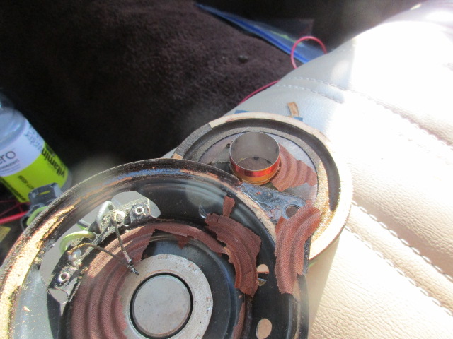

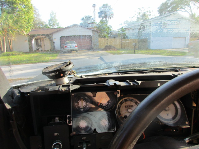

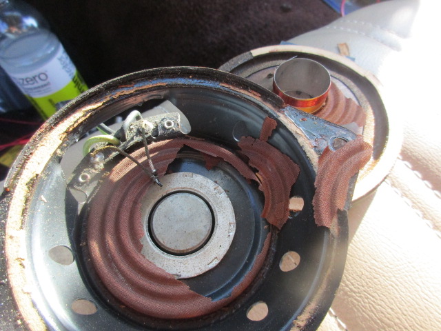

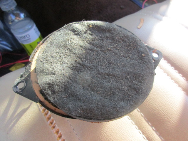

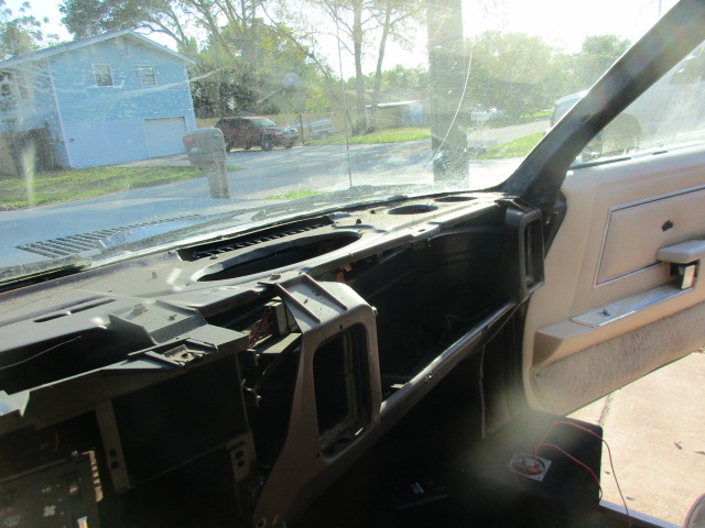

Got the power 12 volt and 12 volt keyed working now. Looks like the front speakers are NFG. I took the Glove Box out and disconnected the plug to the speaker and hooked the speaker wires from the Radio I purchased and no sound. Do I have to remove the whole dash piece to remove the large speaker cover?
Yeah, but it really isn't that bad. Four screws by the defrost vents up top and a number behind the instrument panel cover with a few more down low under the glove box. The glove box and dash pad come out as one piece. Just be sure to toss a rag over the defrost vents before trying to remove those screws. You'll probably need a 1/4" universal or maybe even a flex socket to get those top fasteners - anything else hits the windshield.

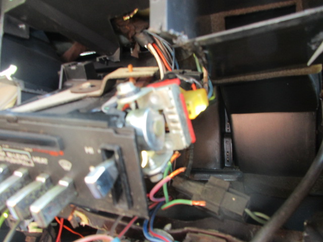

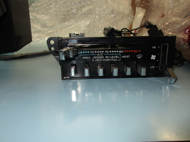

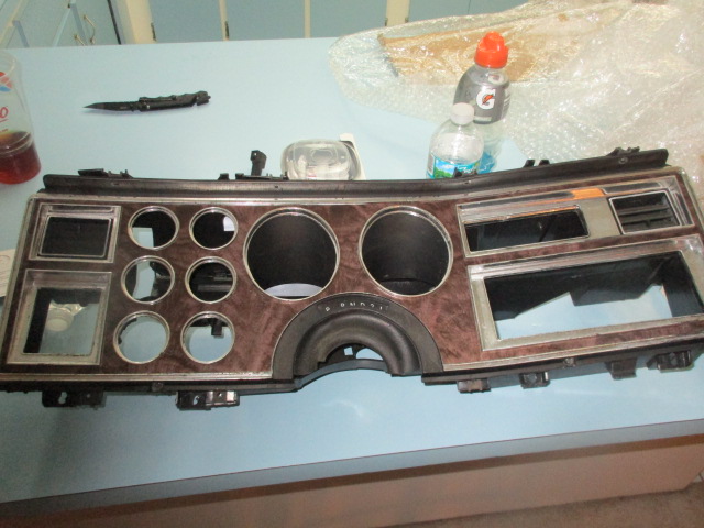

Got the Dash apart. Front speakers are junk. The heater A/C control unit is broken. The switch side is all broke and not attached to the unit. Will have to find a better one. I would like to replace the instrument panel plastic bezel also. So if anyone has these for sale let me know

Your big problem with the small speakers in the dash is that the factory speakers are just a one way speaker. Everything I found out in the market that is that size is a two way, and the tweeter cone sticks up above the side of the speaker. You don't have a lot of clearance between the top of the dash and the mounting ring of the speaker. I finally found a a pair of speakers with a low enough profile tweeter that I could make fit below the dash plate. I ended up creating some foam shims to go around the speakers, and hold the dash plate up higher over the speaker itself to give the tweeter cone room to move.
1,848
1,048
Rockford Fostgate used to sell a 2.5" that would fit under the dash. I have a pair in my car. Be sure to run low pass filters on them if you have a decent stereo.

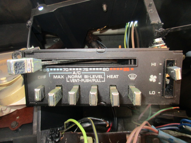

Will the Heater A/C controls and the plastic instrument cluster cover from a 1986 Chrysler fifth Avenue work for my 1984 Plymouth Gran Fury?

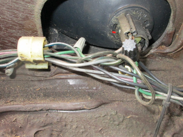

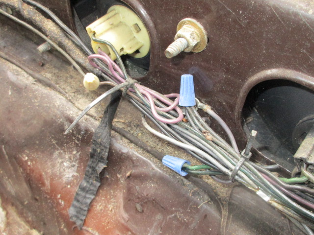

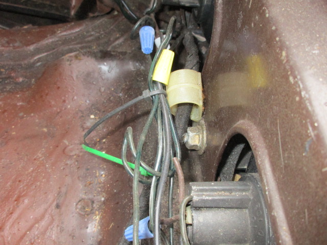

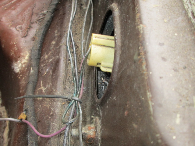

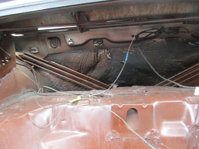

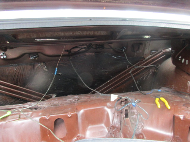

I found the factory rear speaker wiring harness. Speakers are supposed to be here tomorrow. The taillight wiring harness is a mess. It is much worse than the pictures show Will have to find a non molested one.
1,848
1,048
House wiring electrical nuts? Wow... This is an onion alright. Yeah, find an entire harness and splice it in further up in the car.
3,189
821
The rear harness should just be a plug in deal for the tail lights. Follow the wires up the Lt quarter panel I think there's a plug in there.

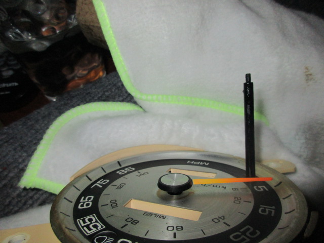

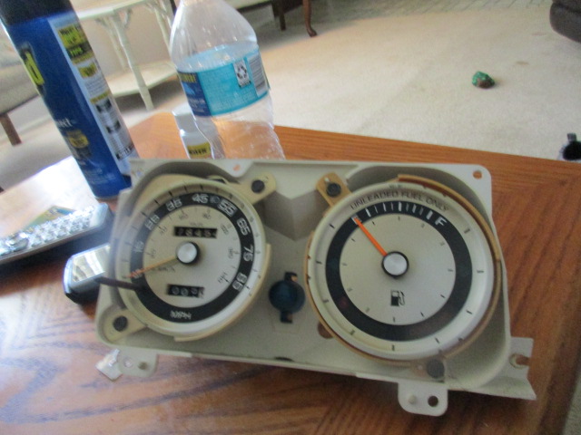

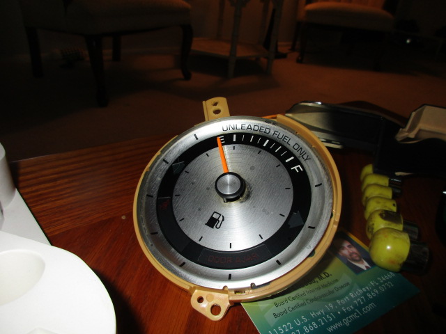

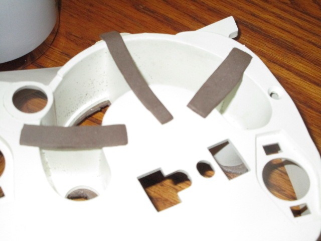

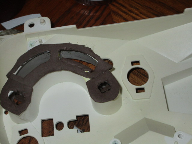

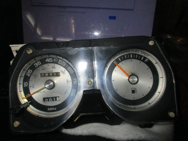

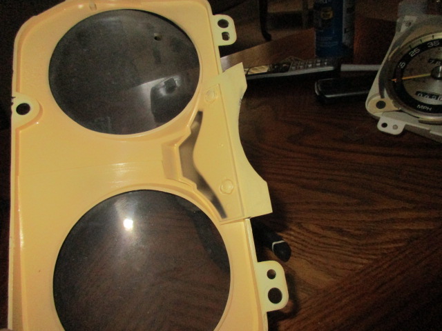

Disassembled cleaned and detailed the speedometer and fuel gauge cluster. Put new foam on the cluster housing I even painted the odometer rod. I did my best on the clear plastic but It is still not perfectly clear.

I would like to thank Murray B Park for the Heater A/C control unit and the cluster cover and the plastic mounting assembly.
