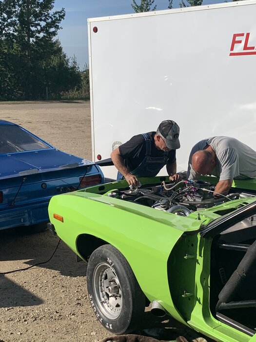

Few pics. I’m in the gray shirt. The guy in the coveralls is the smartest guy I know. Definitely can’t do it with out him. The big guy in black owns the Cuda. He’s just there for looks lol. It was busy Saturday. I helped a friend with his Cuda. Back and forth between the 2 cars.

Haha I wish. It’s got a R3/W9 that twisted the dyno at 700 hp and the heads are not even ported yet.
I helped Cliff (coveralls guy) build the engine 2 years ago. Used my engine run stand to break it in.
There is a good chance I will end up with this engine sometime in the next year or so.

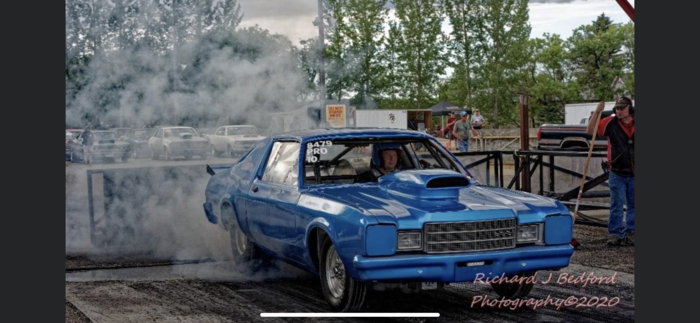

I’m going to try everything I possibly can to get a 9.99. The air was horrible last weekend. Maybe just maybe when I go in September the air will be better.
I will post a video when I get home from working out of town. Sucks being gone Monday to Friday but that’s life.

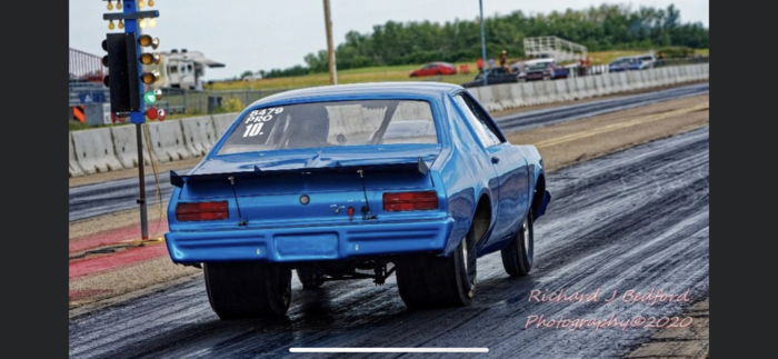

car felt really good. launched good and pulled all the way through 3rd. i had new bests in all categories,
1.42 60'
10.20 ET
130 MPH

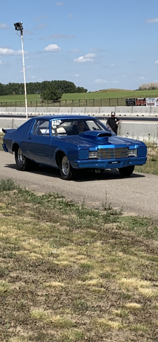

Last weekend I was supposed to race Saturday/Sunday but I didn’t get to make a pass. During my first burnout, a connecting rod let go. So that ended my 2020 race season.
I still super happy with the shortened season. I ran personal best in every category from 60’ to MPH.
I wanted to run 11.0 with this 360” and I went way beyond that. I’m very happy with my cars performance. Ended up with a 10.20 @ 130 MPH.

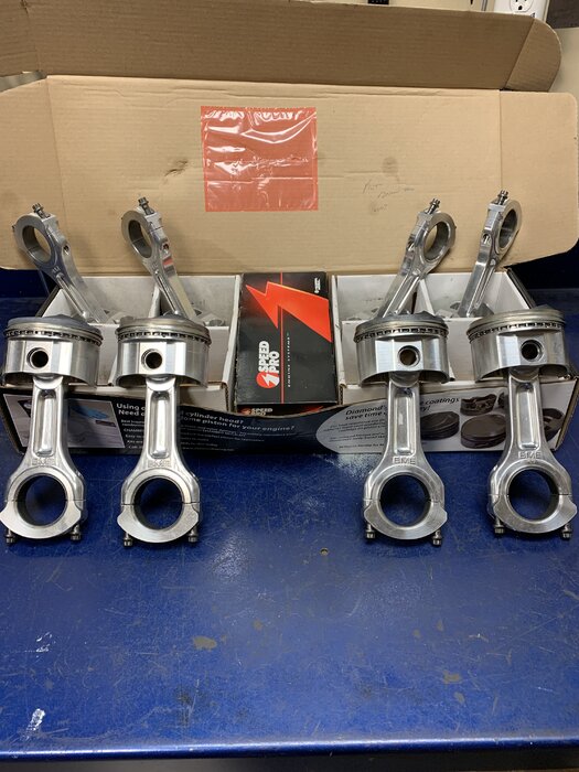

I have a few ideas floating around in my head for a new short block.
I have another 360” block and could use that.
I have a standard bore 340” block that I could use. This is the route I will probably take.
I have a direct connection 3.46” stroke 340 main forged crank and BME aluminum rods with JE forged pistons sitting in the shelf.
Good chance I will put this together with my top end from the 360”.
