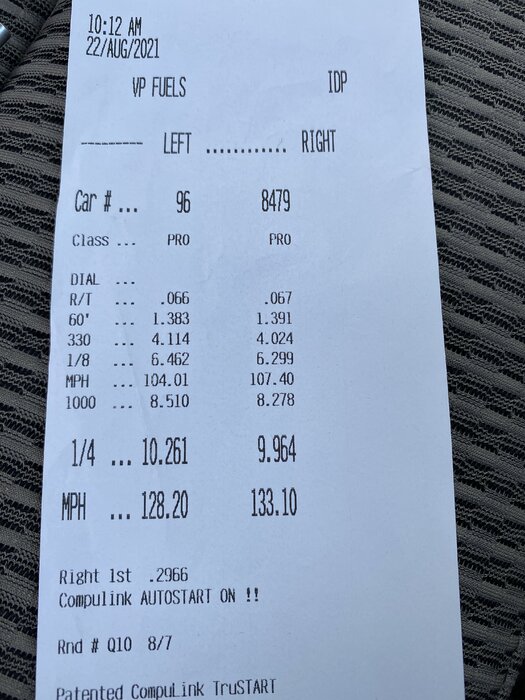

funny thing happened on the 9.96 pass. The last 100-150’ the car nosed over. I thought the engine went. Car was dead. Tried starting it on the return road. Wouldn’t fire. I just happened to look at my ignition box on the passenger side. My coil wire came off. How does that happen.
Good chance I would have see a 9.85 at 134 mph.
i took 6 degrees of timing out to slow the car down. Slowed the car down to 10.14.
Lost 2nd round, .008 red light.

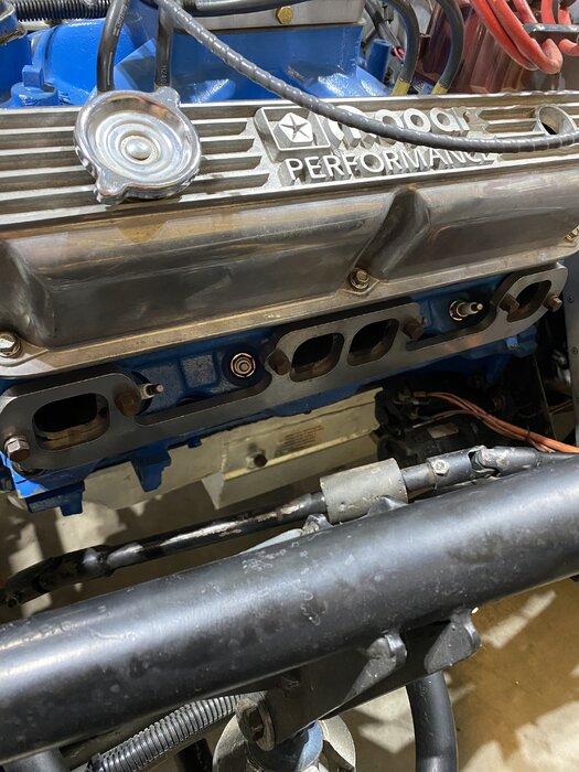

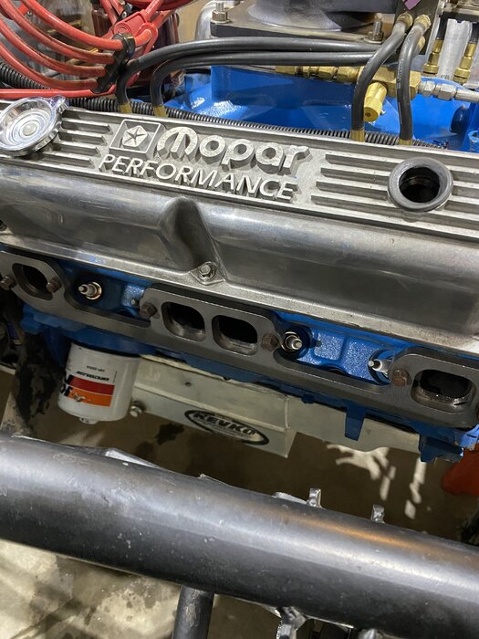

New oil in engine, rockers backed off. It really is end of season when this happens. I have a few things I’m going to do. This is one of the things.

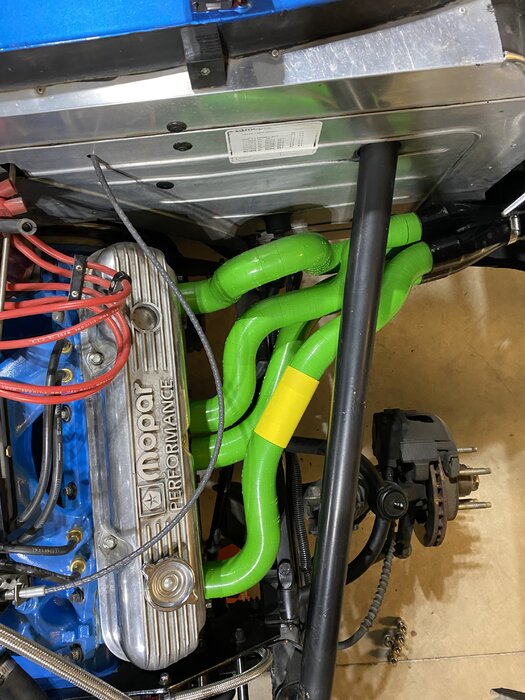

What you guys think? Yes or no?

You are a braver man than I!
What material are you using?

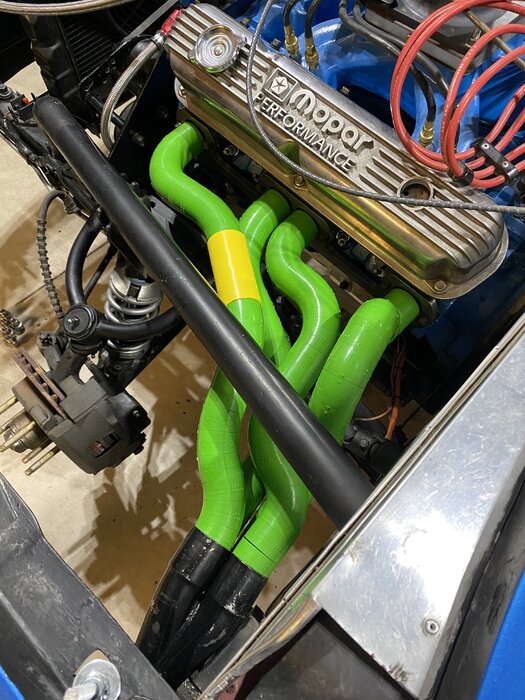

Mild steel. Just debating on what size of pipe to get. Thinking about a stepped header, 1-3/4” to 1-7/8”
This is what I’ve come up with so far.

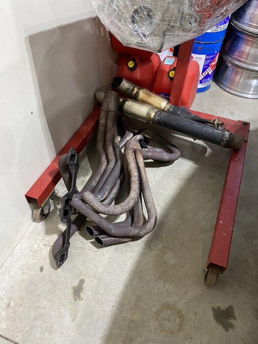

Couple of things I’m doing this winter.
#1 headers…….finally lol
