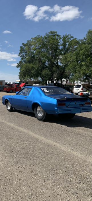

this is what i'm busy with

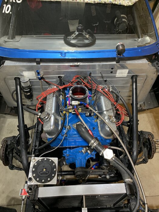

damage was less then i thought. 1 rod, 1 piston. crank might be junk, have to get it checked out. it's a stock 360 crank so it's not worth anything.
everything else is good from timing chain to even the oil pump.
i'll use basically everything in the 340

Race day tomorrow. Quickly had to run it on methanol to make sure it all worked from last year and had no leaks in the system.
9secRR
Jan 14, 2012
876
562
Saskatchewan, Canada
1st pass, 10.24 @ 130 mph. 1.46 60’.
2nd pass, trans fitting split when I was coming out of burnout box.
got line off and getting new fitting. Be back running tomorrow.
9secRR
Jan 14, 2012
876
562
I lost 2nd round.
Very happy this weekend. Made a new personal best this morning , 10.09.
also new best in the 60’, 1.40
I have some work to do on the ladder bars. I want to get my 60’ in the 1.32-5 range.
